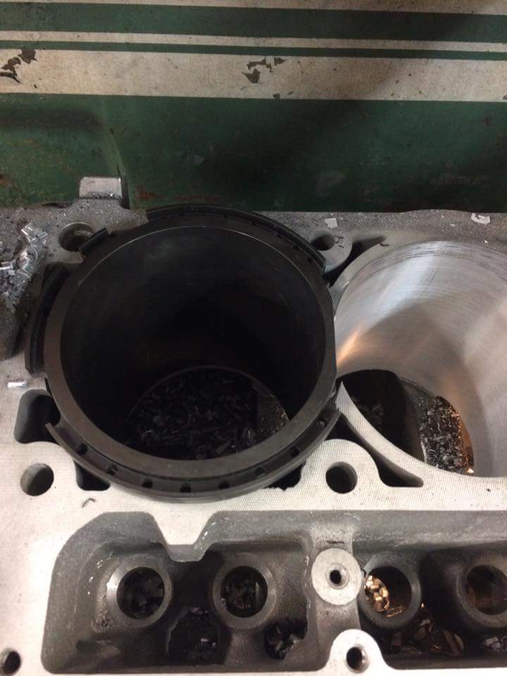

Block machining just started I'll get more pics of the block with the sleeves machined out when I go down to the machine shop next week

Block machining for the sleeves in progress. Been waiting on the machine shop but it'll be worth the wait
