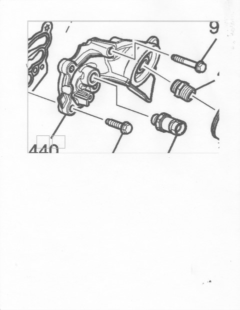

Anyway, you absolutely need to cool the oil down with any high performance application. These late models run too hot, in my opinion and need help if developing more HP. You can add a factory adapter from other application 3.6 V-6's and do away with that eye sore casting that houses the stock oil filter, then purchase a simple aftermarket remote oil filter adapter and relocate the oil filter, then add any coolers you prefer. This will solve the problem. As for me, I already have my cooling system in place but am working on a oil temperature gauge that actually reads REAL TIME OIL TEMPERATURE! See attached pics for the GM adapter. I believe the part number is GM 12635599. As with any non-stock modification, it is the owners responsibility to verify that any non-stock part fits your particular application in function, as well as physical fitment.

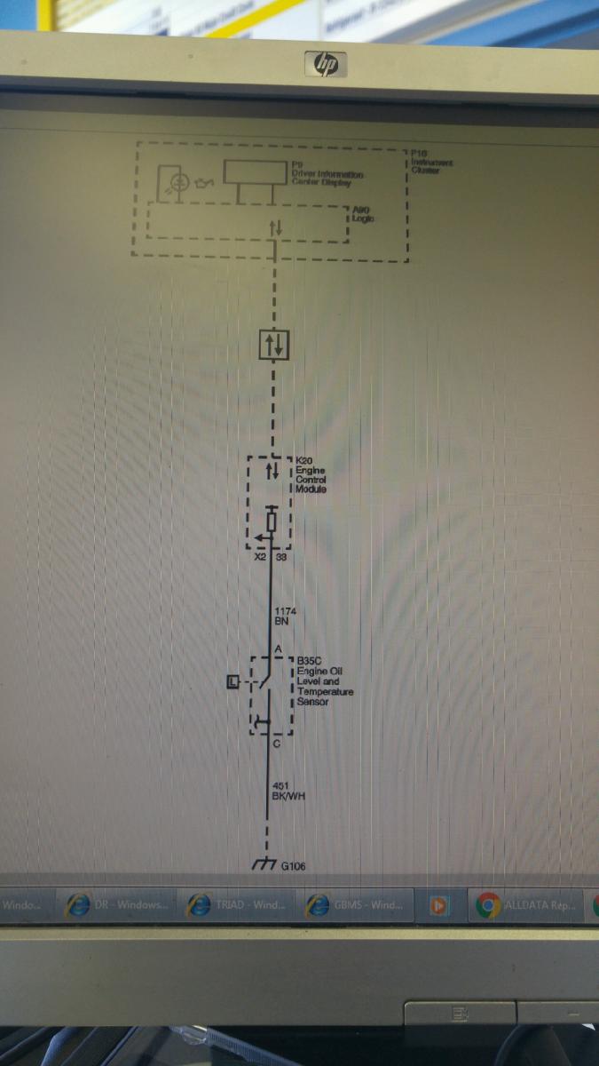

I have a 2013 and I just looked this up in Alldata. It shows a oil level/oil temperature sensor in the oil pan. I can't find a connector view but here is the wiring diagram. I'm not sure how it knows the temp if there are only 2 wires. Maybe uses one wire for both? I'll have to look more into it. I have an extra pan and sensor in the garage at home.
I think the oil level sensor might be something they added to the LFX. I remember reading how the LLTs didn't have a level sensor. I could be wrong though.

Interesting. I confirm that there is no oil temperature unit in the LLT's. It is possible they added it in the oil level sending unit as shown in the schematic and use data transfer to interpret temperature. I will have to investigate that further. Good point. If anyone on the forum has any explanation for this, please chime in. Because I have an LLT, I will need to install a sender in the oil pan for sure. Thanks for bringing that to my attention, Jantzen.
There's definitely an oil level sensor of some sort in my 2015 LFX, as I got a 'low oil" warning the other day. Changed my oil that day, and I was 1.5 qt low. (I purposely didn't add oil for a bit in order to test this theory, while monitoring my pressures and temps for the duration of the test.)
Schematic makes it look like if the level indicator is 'open' (or is that a facsimile digital drawing?) all the stuff in the line is dead. Must be a logic type diagram not really like a one line.
