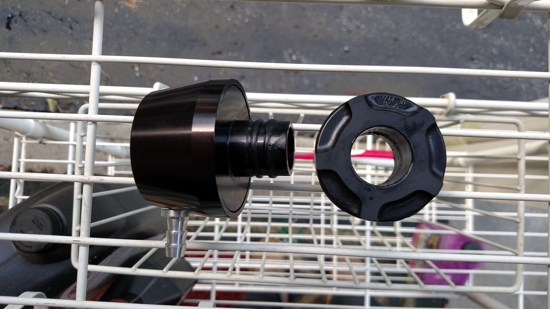

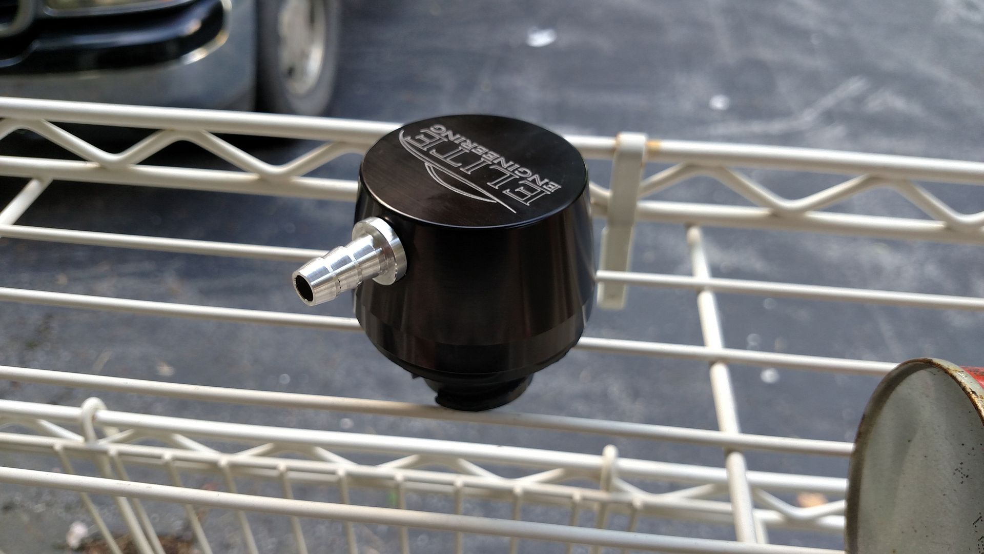

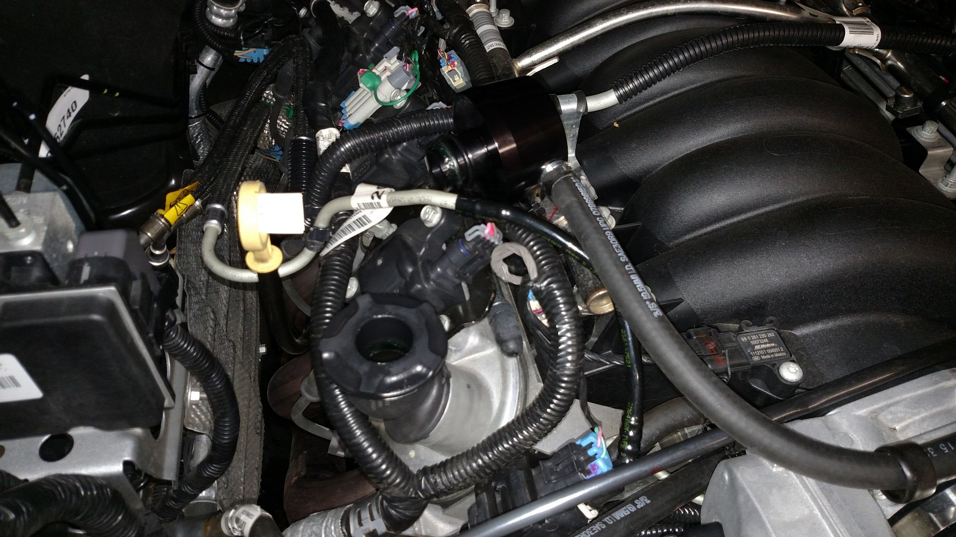

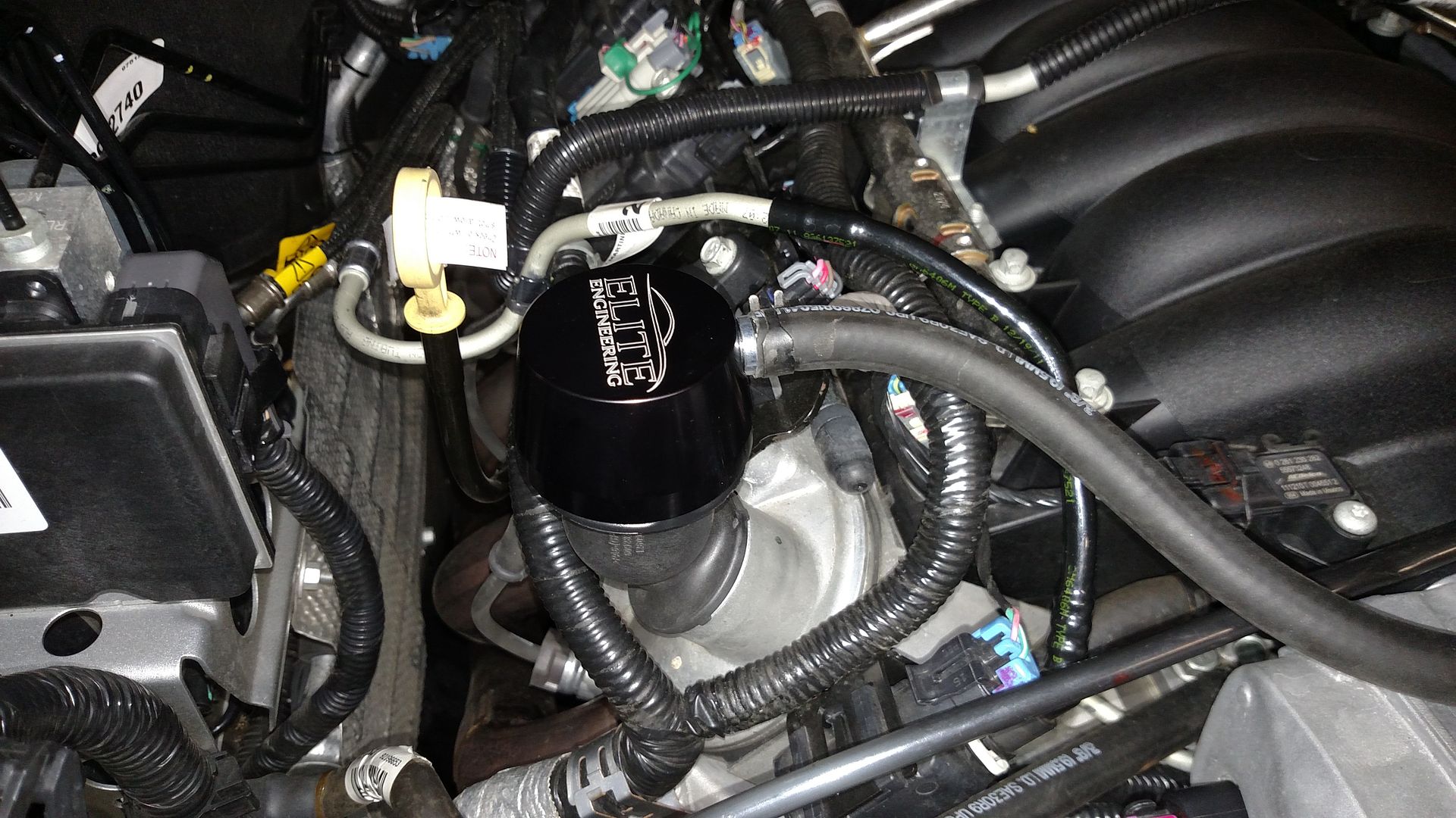

it looks great.

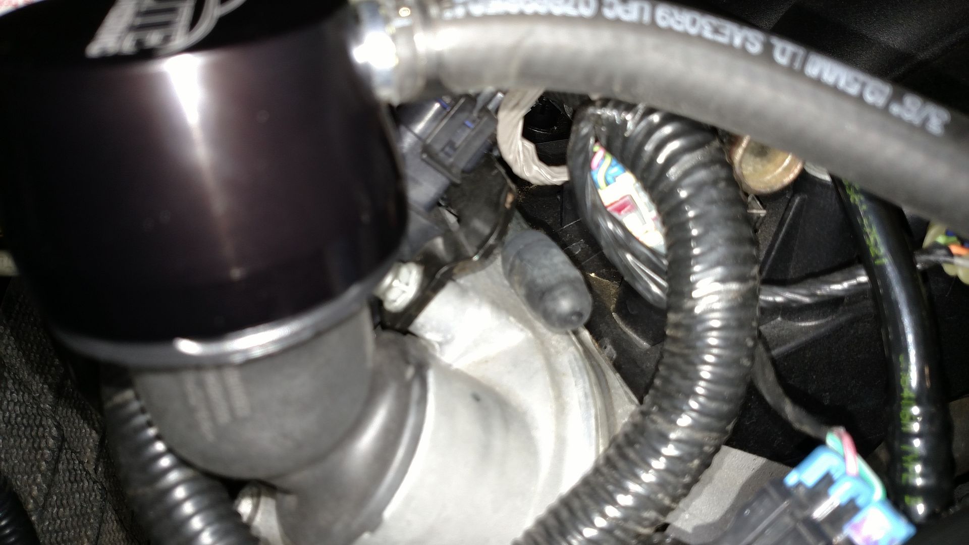

That does look good. Thanks man now I'm going to spend money haha. So basically this thing just gets tapped back into the intake right? Is there anything else involved?

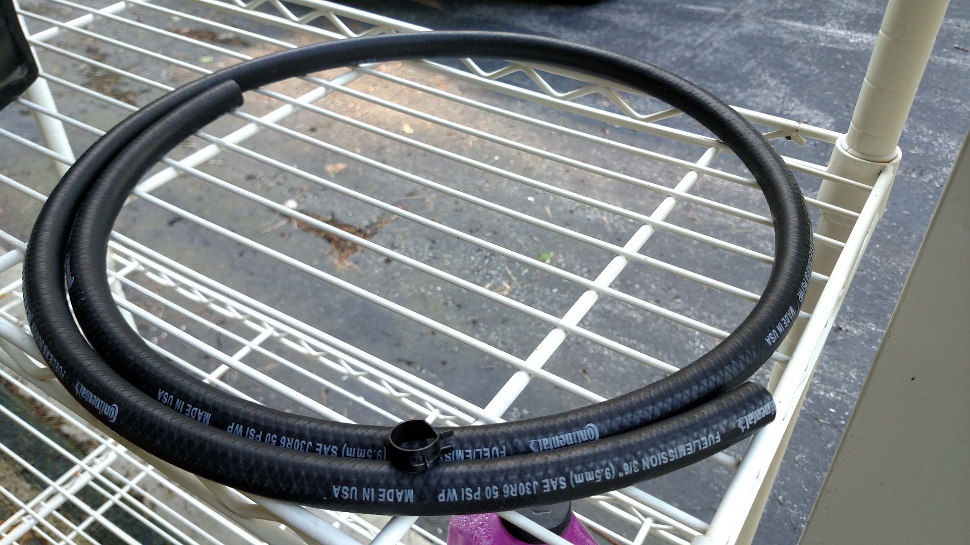

it replaces the oil cap. you hook it up to the air intake. it comes with a heavy rubber plug to cap the valve cover tube 3 spring squeeze clamps and 5feet of good Continental 3/8 fuel/evap hose.

it comes with a heavy rubber plug to cap the valve cover tube 3 squeeze clamps and 5feet of good Continental 3/8 fuel/evap hose.

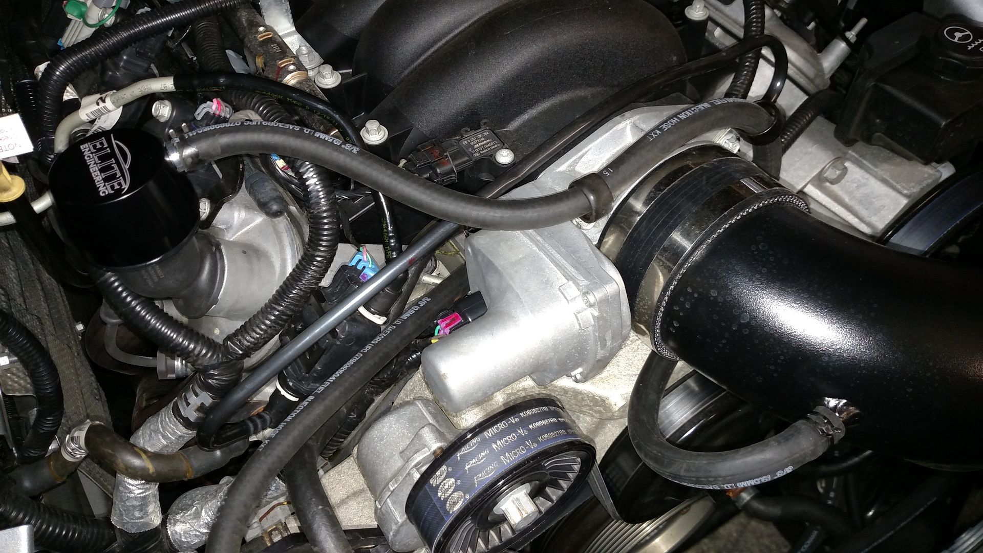

Wonder how this would be on a supercharged application?

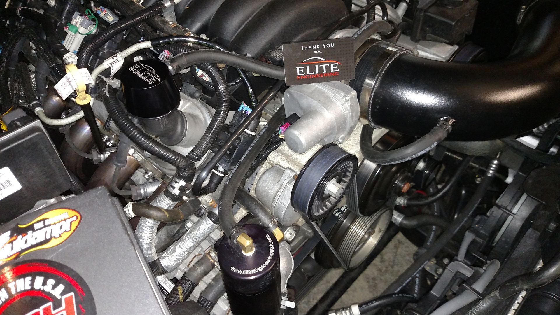

I'm assuming eventually this will require draining? Or does it just automatically bleed down back into the head? Also, can you keep this one on all the time or do you have to remove it under certain conditions?

I bet it would be even more useful on a FI engine

you keep it on all the time. The oil goes back into the engine.

Nice install and pictures. Keep us updated on how it performs. We've had quite a bit of new interest for the Clean Air-Oil Separator.

It looks like the RX clean side separator with an Elite sticker on it to me.

its not a sticker but ya sure does look like the same one. Same price too.

Wonder if it would produce any evacuation issues? Im not expert on this type of stuff though. Looks clean forsure! I love my Elite Products.
