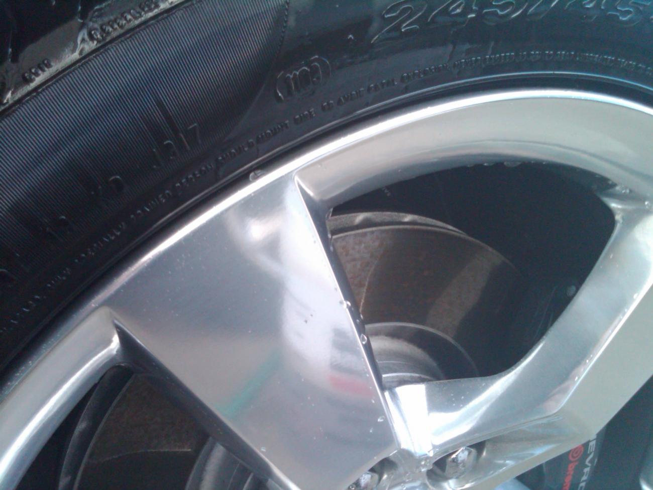

Wasn't happy at all with P21S gel...:(
You still have to mitt/brush them clean, might was well use soap and water.
PIC #1 Only a week of brake dust. Not very dirty at all
PIC#2 Cleaner applied for about 5min
PIC #3 Results from only cleaner
PIC #4 Results from using a Mitt.
