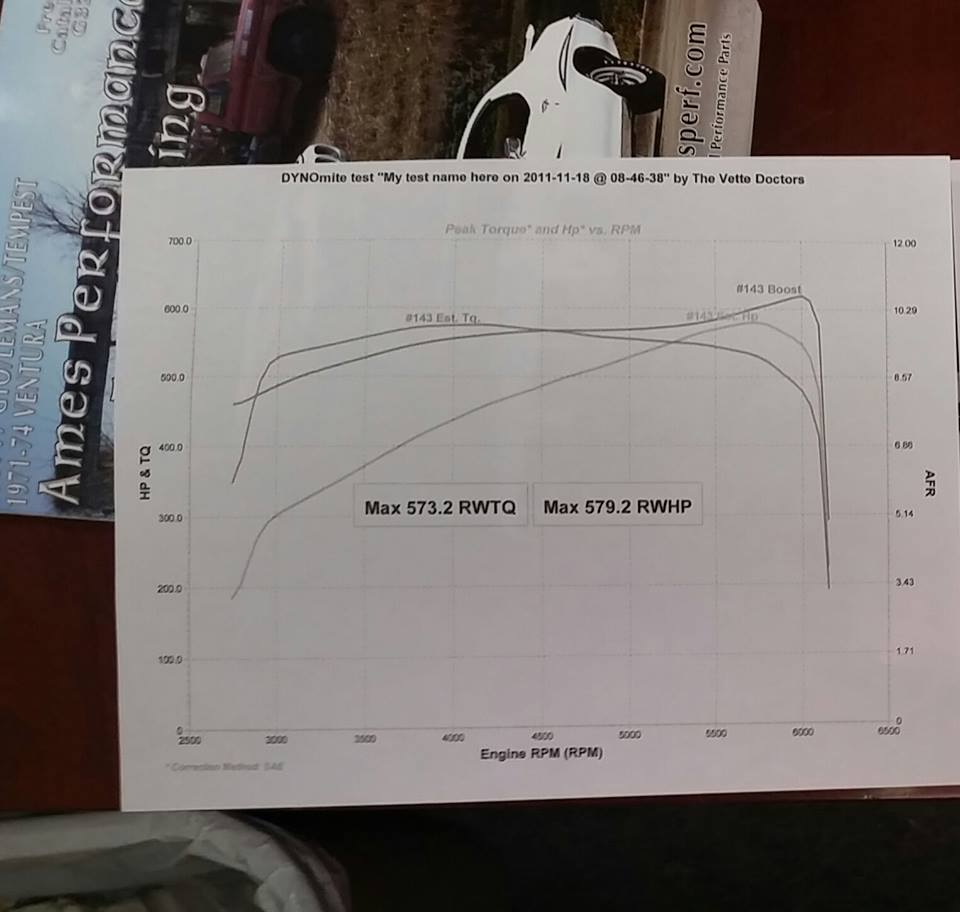

hello everyone I just joined here , 2 days ago I bought a 2011 Camaro with a whipple charger
I do have another car but the Camaro will be my main car so I will be putting about 15 thousand miles a year on the car and I wont to be able to constantly be able to romp on it without blowing the engine
my car has the 3.875 pulley (10 lbs) but I was thinking of lowering to the 4.250 (7.5 lbs) just to make the engine last
so my question is should I lower it or keep the pulley in there now ?
will the engine truly hold up if I run the car hard as a daily driver putting 15 thousand miles a year on thee car ?
I want to keep the car for 4 years (it only has 3 thousand miles on it right now)
thanks for any help

At that power level, you will get plenty of longevity out of the engine. LS3's are good past 800 whp all day.

I haven't had a sports car in a little over 10 years so I am out of the loop , to me the 579 rwhp sounds scary but I know by todays standards that is NOTHING , but Im a bit of a chicken , I want to be able to romp on it several times a day and drive it a lot of miles per year so I am thinking the engine will pop

You should be OK putting that many miles on it. I have put 36K miles on my SS since I put the E-Force S/C on it. As long as you don't full out race it all the time, it will hold for a long time. Nice rwhp numbers.

At 10 lbs, you are pushing the upper end of boost for what a stock LS3 likes in terms of safety/longevity while running on pump gas. That doesn't mean it won't be safe to "romp on it daily" as you say. But at those boost levels, your tune had better be spot on to keep it safe. There isn't much room for error there at 10 lbs. The main culprit being the Ls3 has a high compression ratio in stock form (and nothing forged internally). And octane. Do you have 91 or 93 octane in your area? A bad load of 91 pump gas and 10 psi of boost could be bad news.
If you keep it at 10 psi, I would suggest you confirm your tune somehow. Try to find out who did the tune and talk to them. Or see what kind of a deal you can get at a dyno shop to have them look at the tune and give it a couple of pulls on they dyno to confirm it. Do you have a wideband in the exhaust to monitor afr?
Or, you could drop the boost down as you have thought about. You'll probably lose about 15 HP per 1 psi of boost. Drop down to 8 psi (which is where base supercharger kits run from all the vendors) and you should be safer with a little more room for error. I would expect you to see 540-550 hp at 8 psi. Which is still very stout.

good points , I am thinking about getting the pulley that brings it to 7.5 or 8 lbs of boost and having it re-tuned
I have absolutely no traction now anyway at 579 rwhp so 540 to 550 should be good enough for my daily driver
