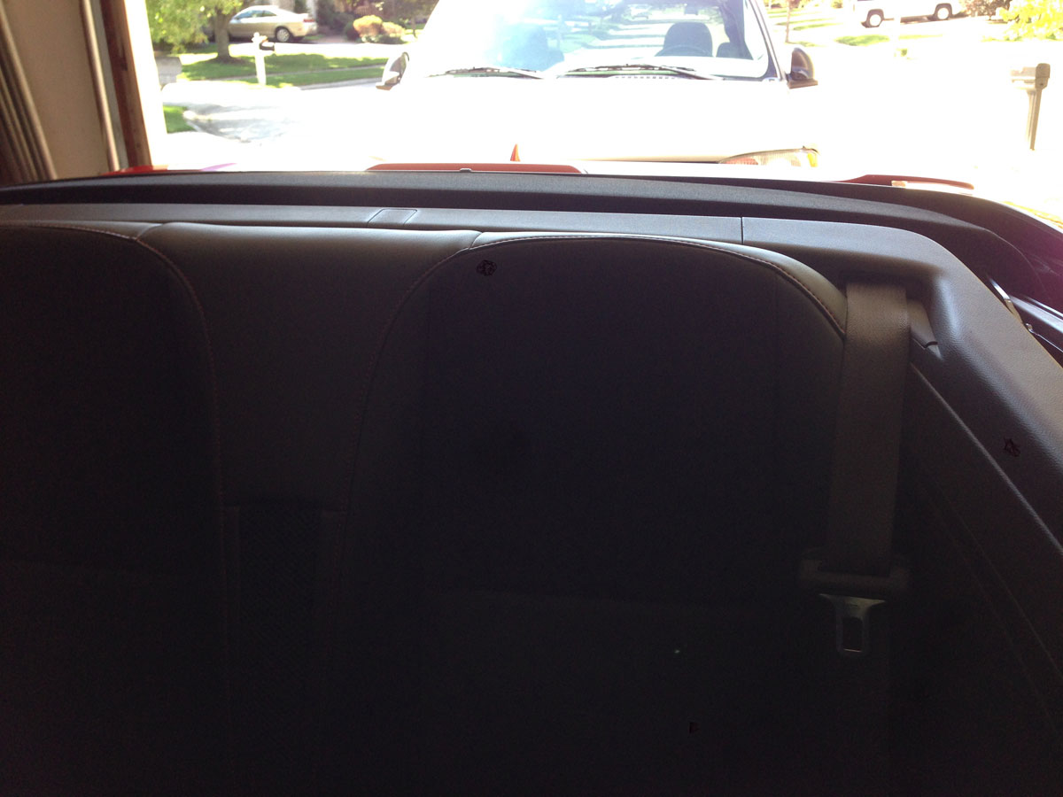

Prior to my ZL1 convertible, I owned 2011 and 2012 2SS convertibles. I noticed right away that the top on my ZL1 sat a little higher in the well then the previous two model years. It wasn't a dramatic difference but one that was definitely noticeable. Even with it sitting higher, I've never had a problem getting the tonneau cover on. I even place a folded towel over the top before installing the cover.
Here's photo I took back in Sept of '13 of my top folded in the well. Does your's sit higher than this? Post a photo for comparison.

Thanks for the replies. My top sits as yours does. The car is brand new and their is a bulletin from GM stating that this is normal. my 2011 top had zero issues and looked much better in the well than this one. Just a little disappointed that it doesn't go down further. Is there any concern about the wind getting under the top and stretching the fabric over time?
