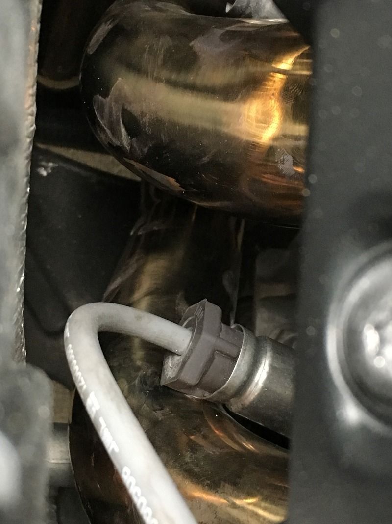

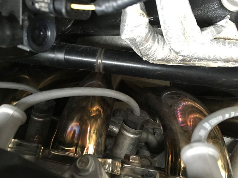

I do this for a living and have installed no less than 100 sets of various brand headers on C5, C6, C7 Corvettes and Gen5 Camaros so I am giving my non biased opinion based on honest facts based on my experience.
Here is a perfect example. Customer came into the shop Today with a C7 Corvette complaining the steering had a flat spot while turning at slow speeds. He mentions that another shop had installed a set of long tube headers last week. I open the hood and what do I see? #5 primary tube rubbing on the steering shaft. On the even bank all four plug wires were in complete contact with the primary tubes. I can't make this up! And look at the color. My Kooks don't look like this. These are Chinese made and are the house brand of a sponsor of this forum. These are the honest facts.
