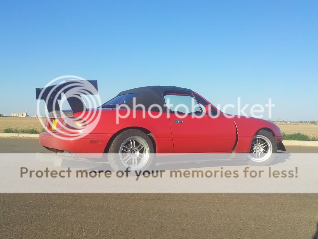

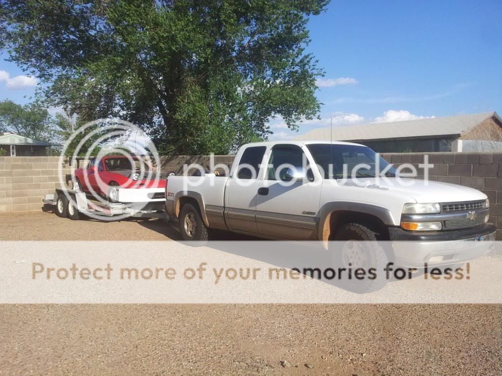

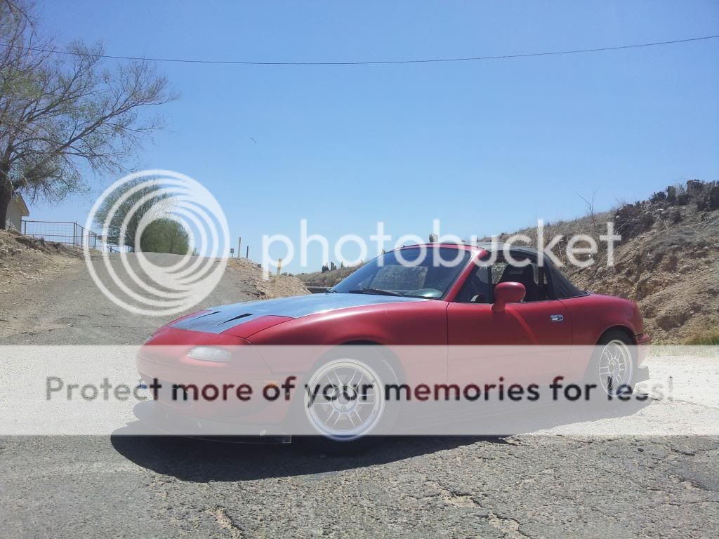

Part 1 - In 2011 I bought a 1993 Miata about 600 miles from my home Air Force base in Clovis NM. A friend and I drove to get the car from Colorado Springs and I took it up Pikes Peak within 2 hours of owning it. I'm going to put up all the pics from the very beginning.
I used to carry my Saiga 12 with me at all times back in the day
I bought Enkei RPF1's for cheap @ 9.5 lbs a piece and sold the tires for some Nitto NT01's
30MM Laser etched shifter

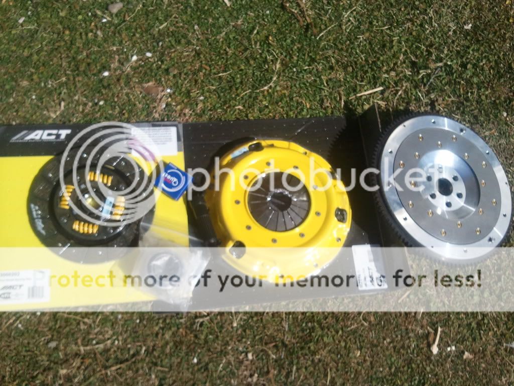

7 lb Flywheel
My third open track day with the car at NAPA Raceway in Albuquerque NM trying out the new mods
Some of the Fastest Laps of the Day
Mine 1:40.677
Lingenfelter Camaro 650 hp 1:44.287
Audi R8 1:32.103
235 Hoosiers
295 Hoosiers
https://www.youtube.com/watch?t=12&v=NODXXcfh6hc

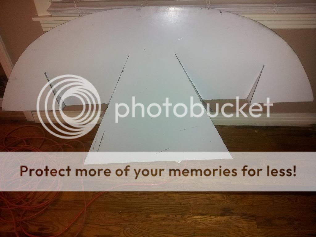

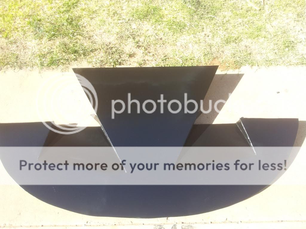

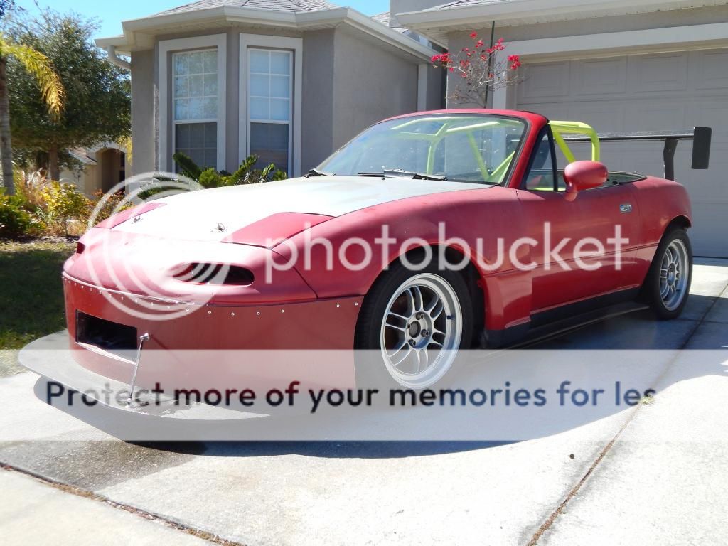

Time to do some more upgrades before next track day.
My Stock 1.6L

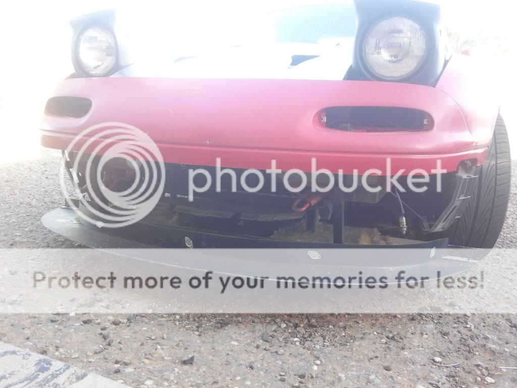

A cheap front splitter, it is amazing the grip difference in front end grip

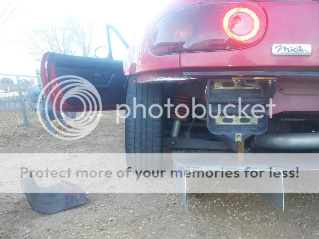

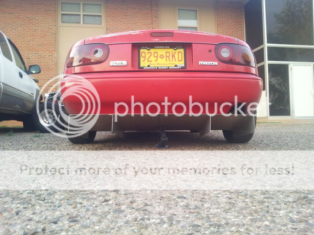

And a new rear splitter to try and even out the grip added to front end from the splitter

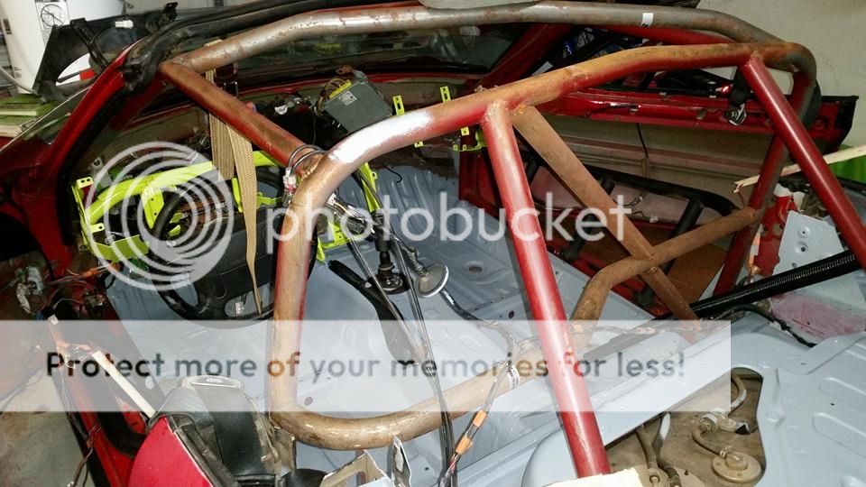

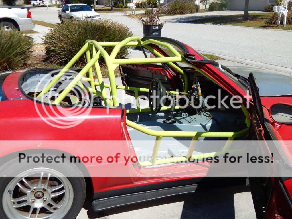

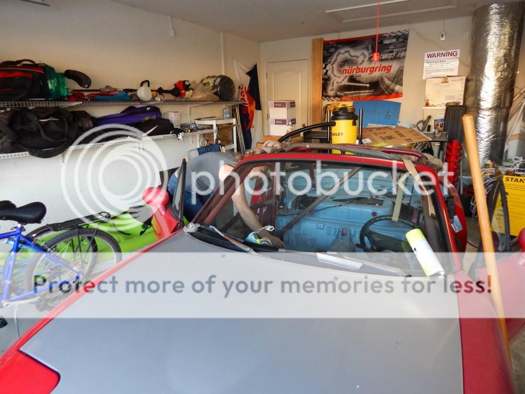

New Cage from Miata Cage
Laser cut flanges
My buddy Joe showed up while I was working on he cage

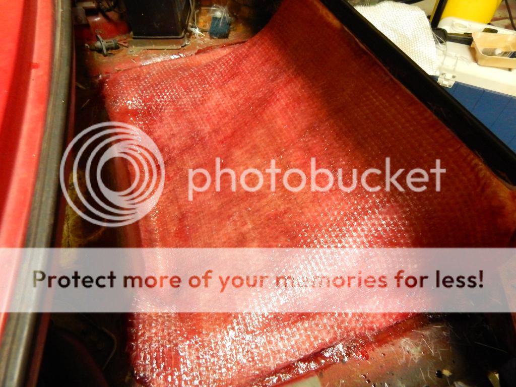

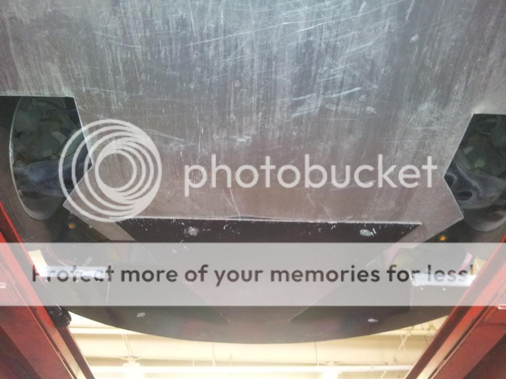

Working on my flat floor. Big improvement on top speed, stability and high speed grip

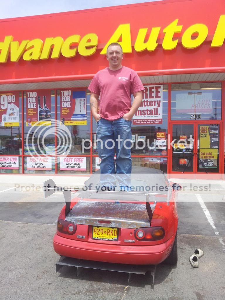

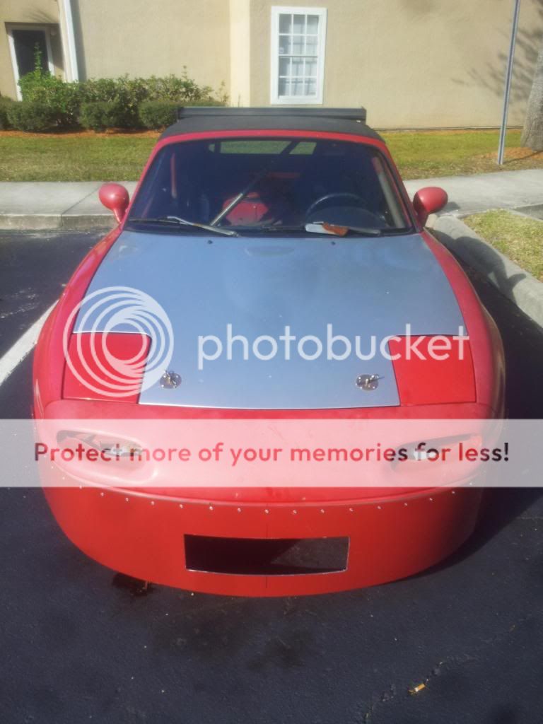

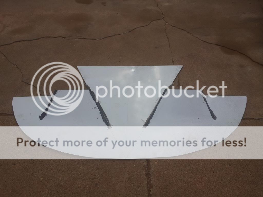

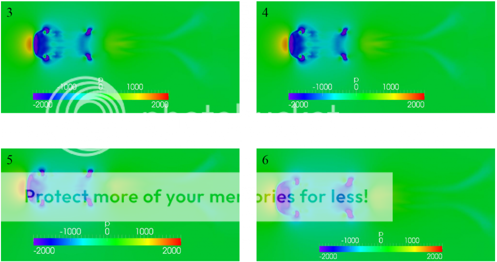

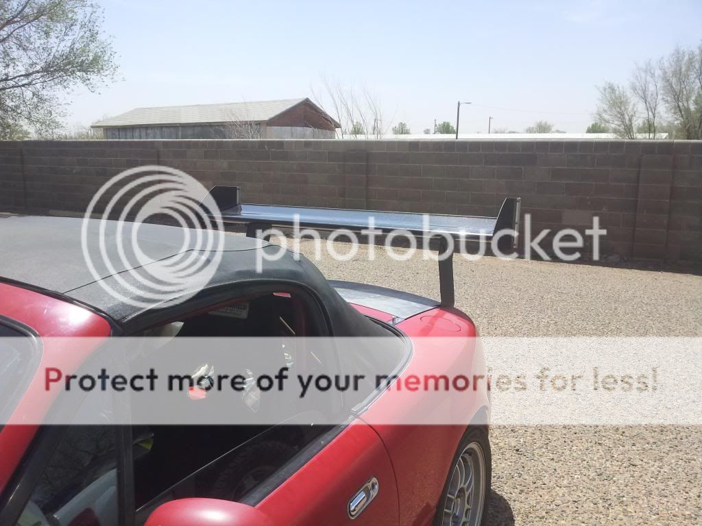

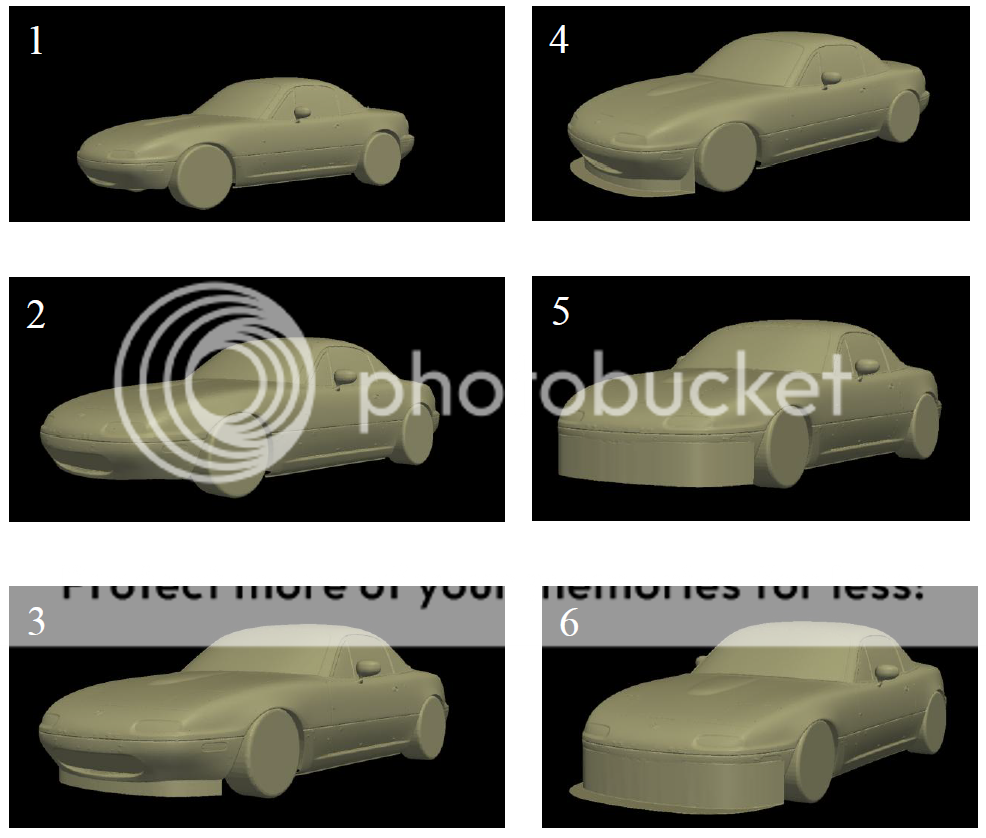

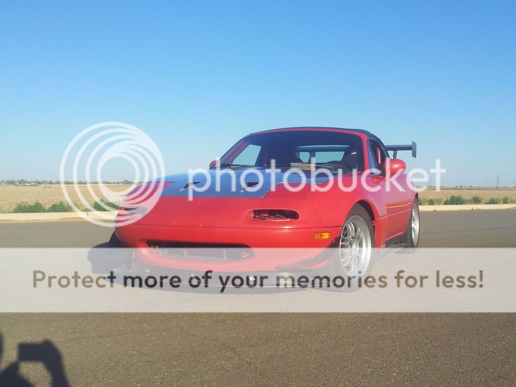

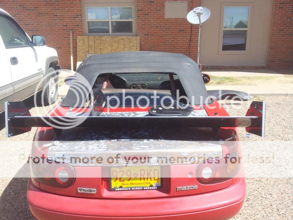

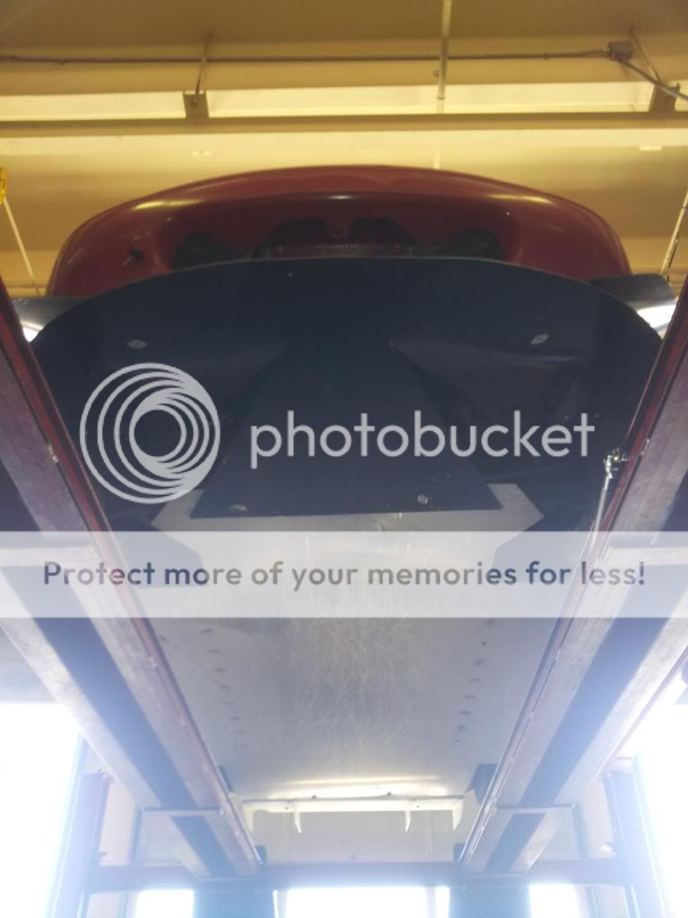

Here is some of the Aero info

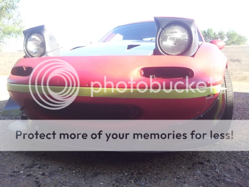

New Splitter

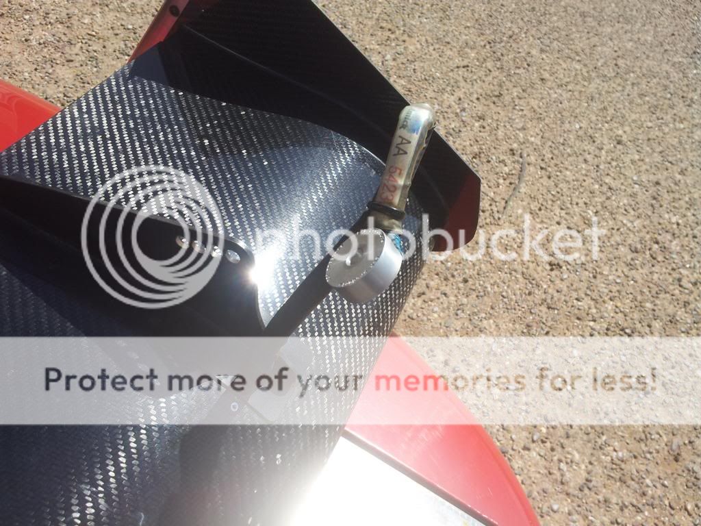

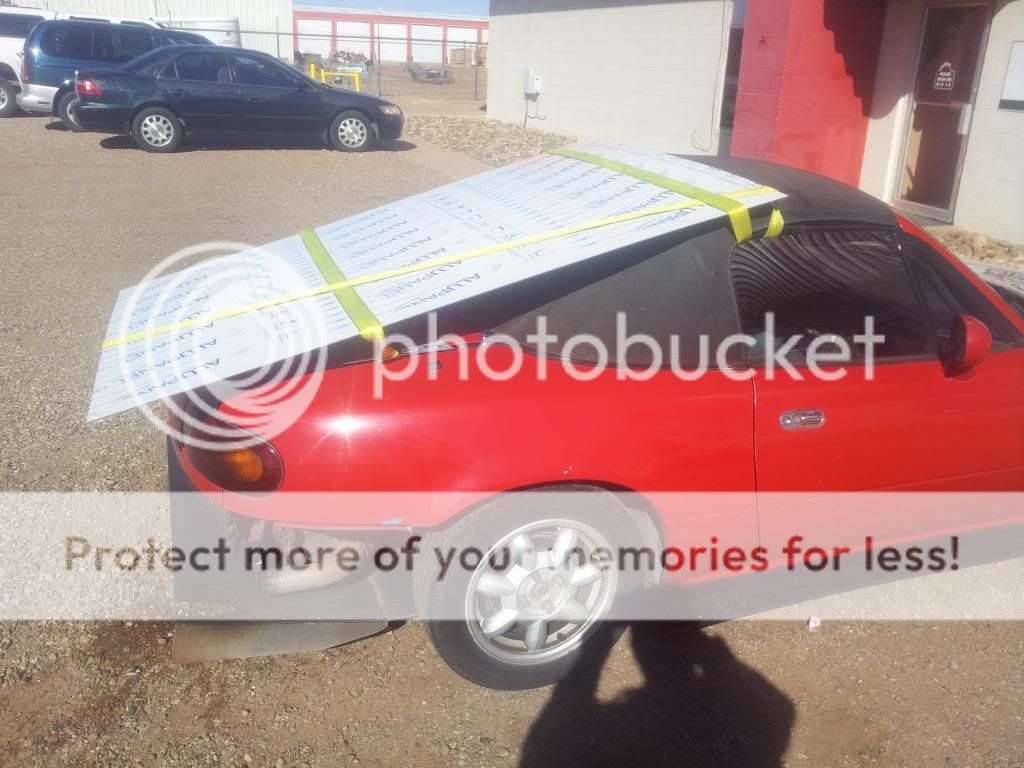

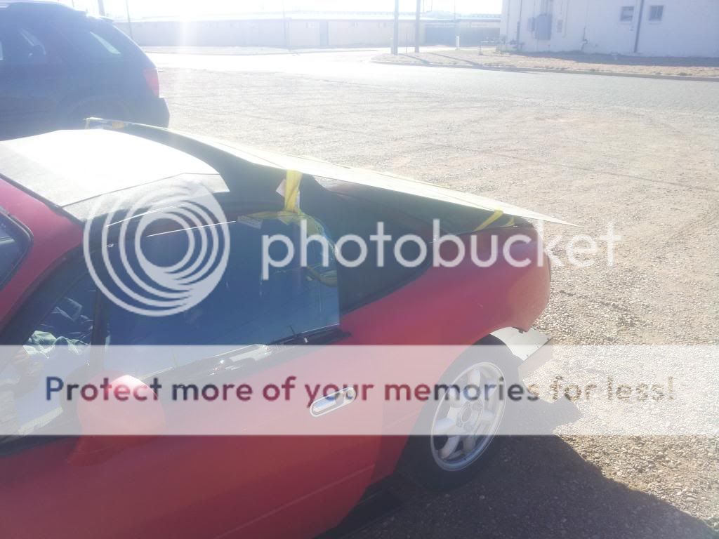

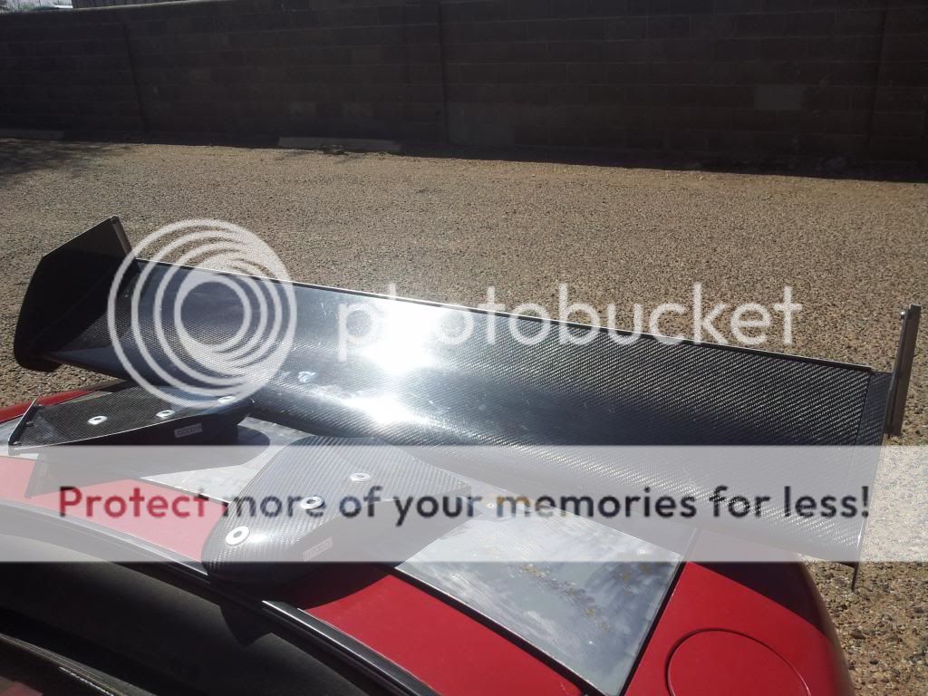

A NASCAR COT wing to even out my oversteer issue from the upgraded splitter
Some more wing testing
Moving back to Florida

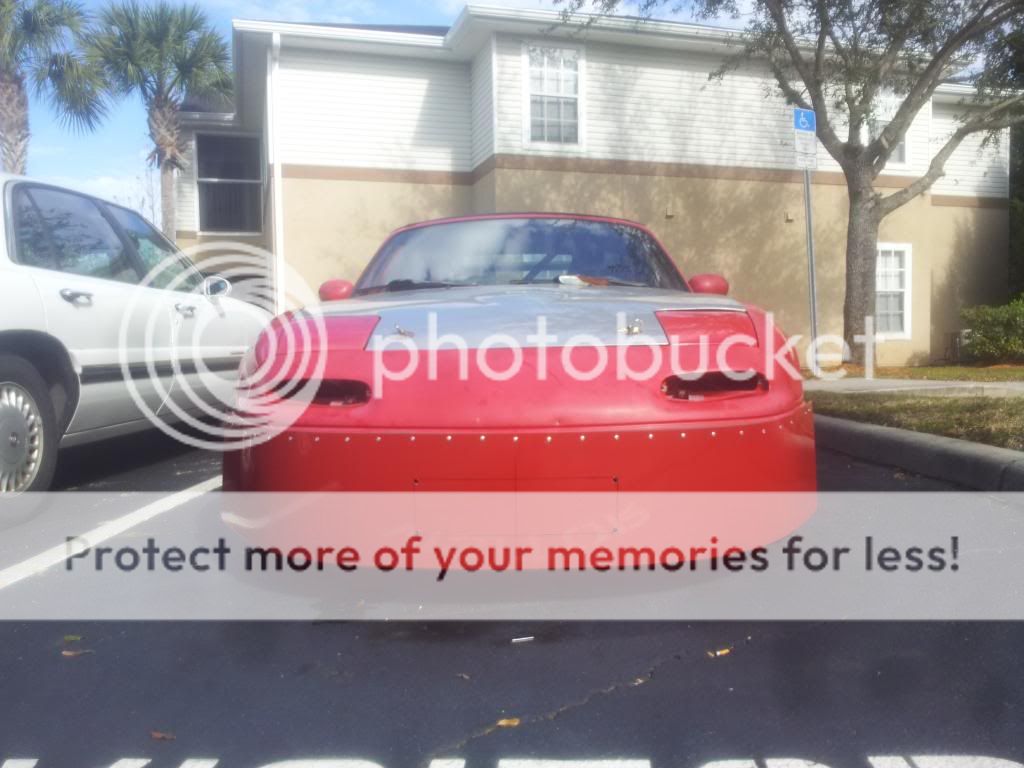

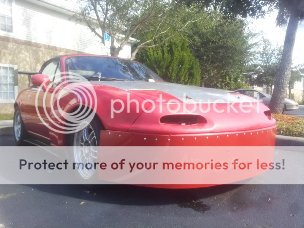

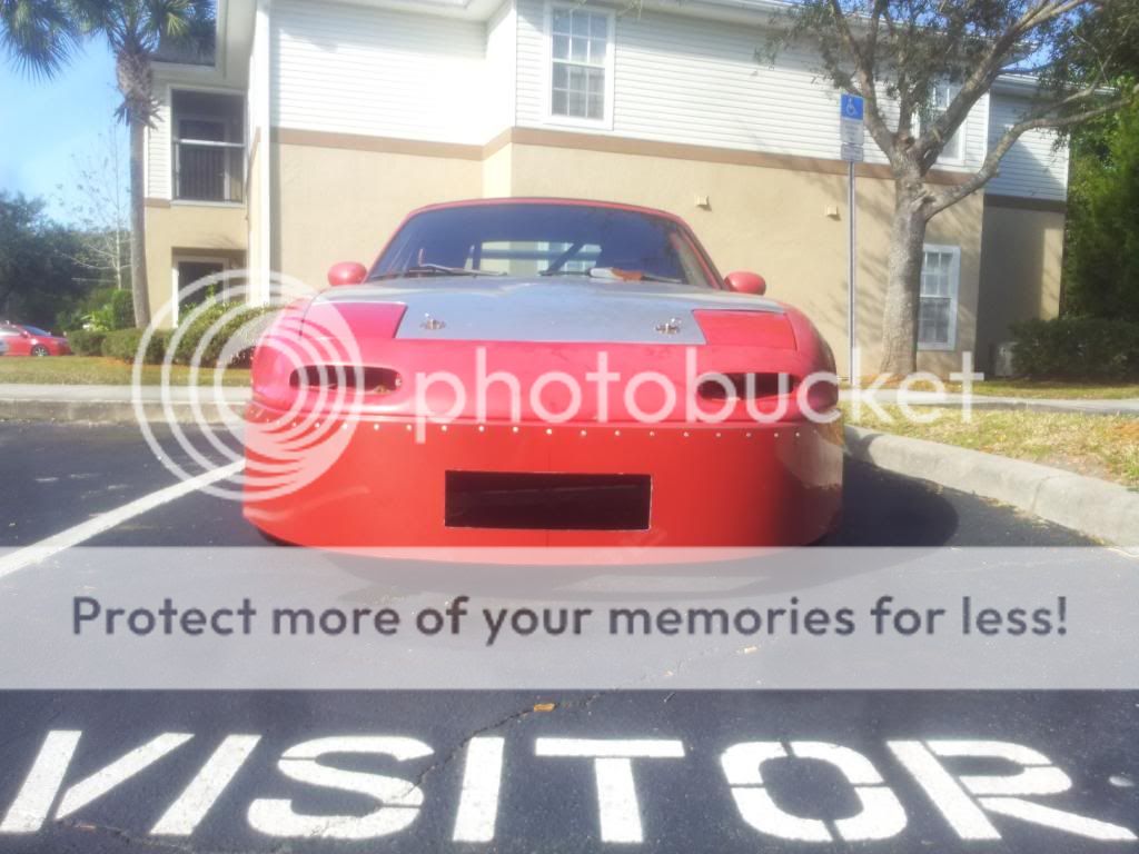

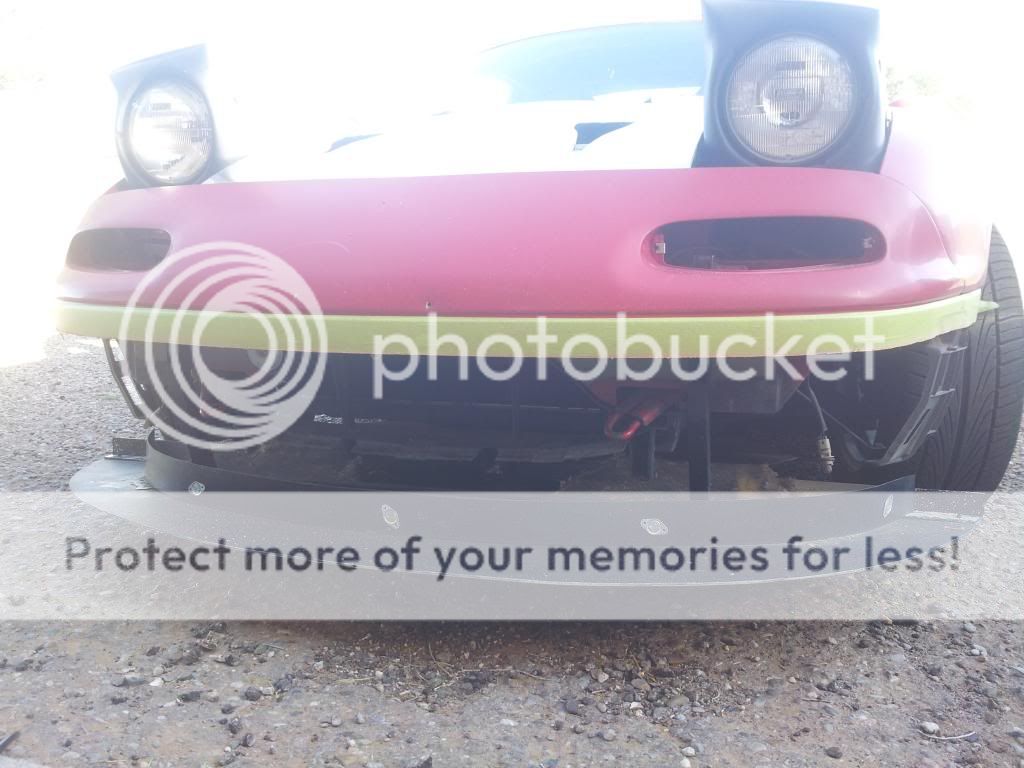

Reduing my bumper

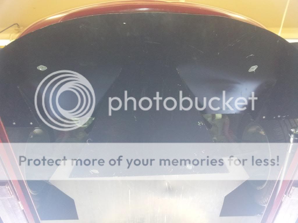

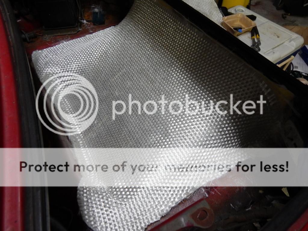

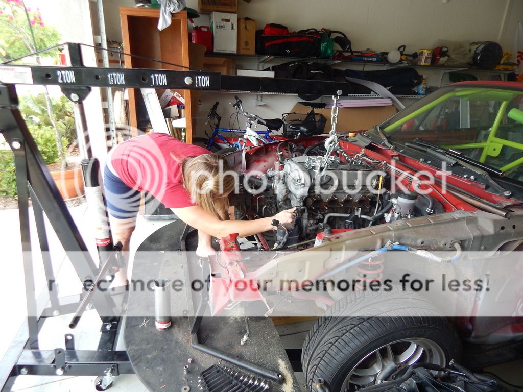

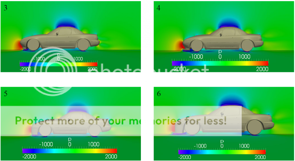

2/3's of the drag comes from the rear of the car. I also want to remove some of the heat from the exhaust and drivetrain.
Time to start painting everything
GF helping paint
Cage Painted

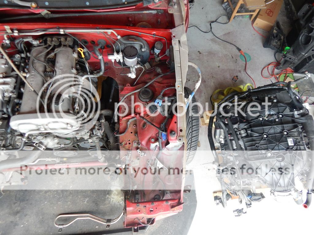

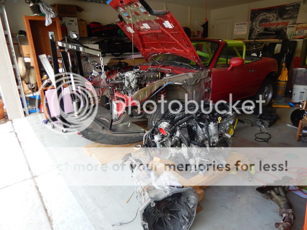

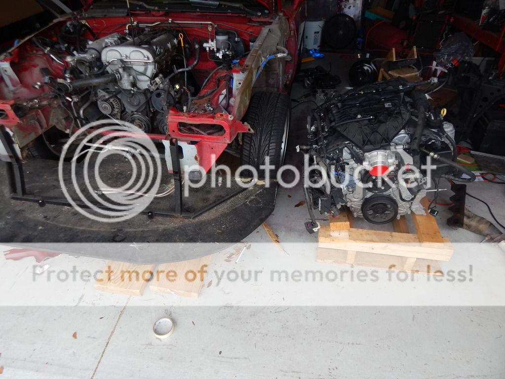

2014 LFX at my house

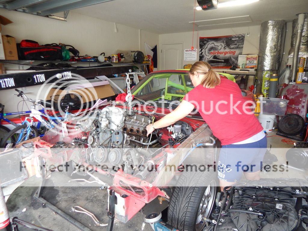

GF felt like she wanted to pull my old engine

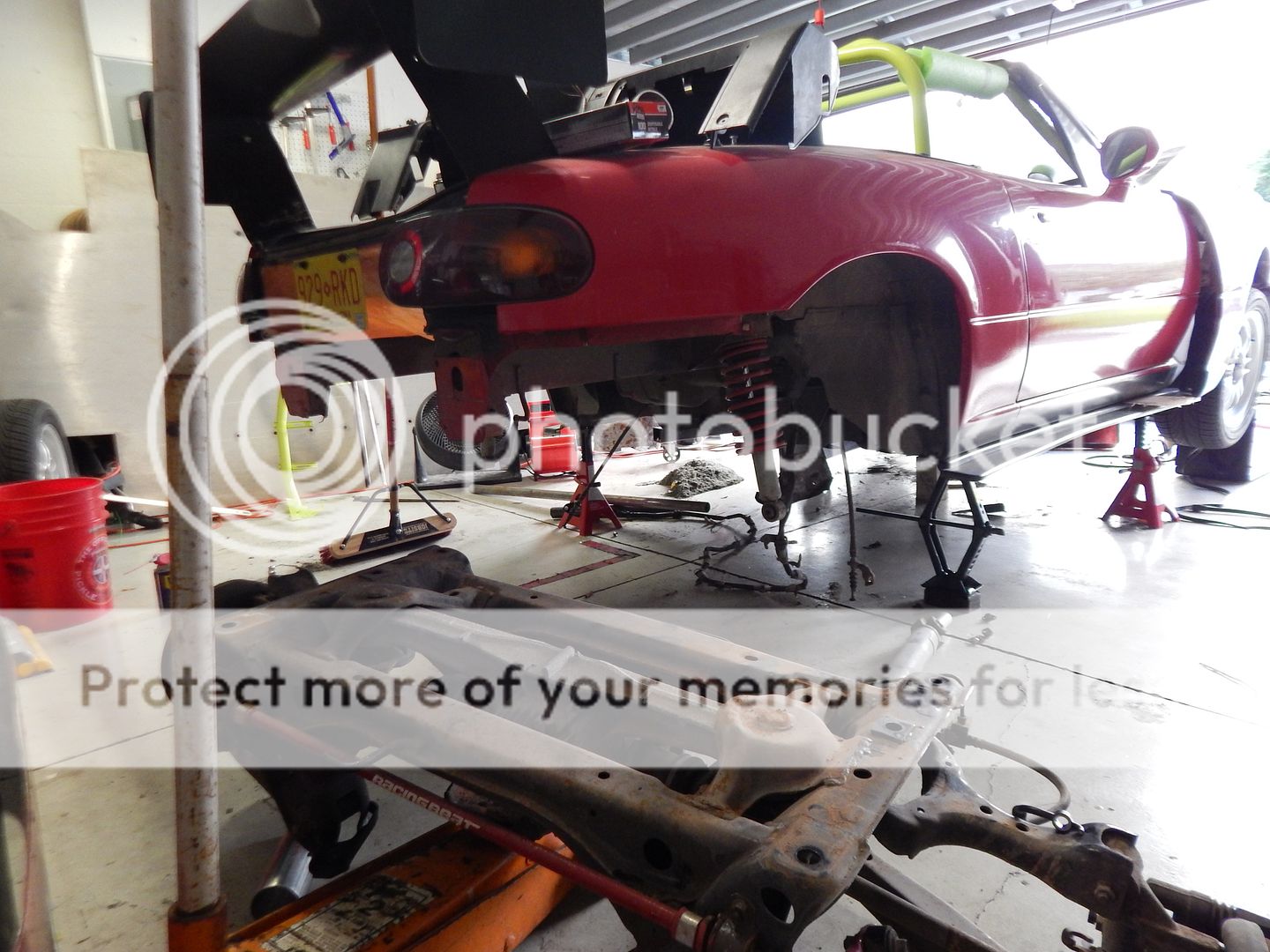

Rear end yanked for a 8.8 swap

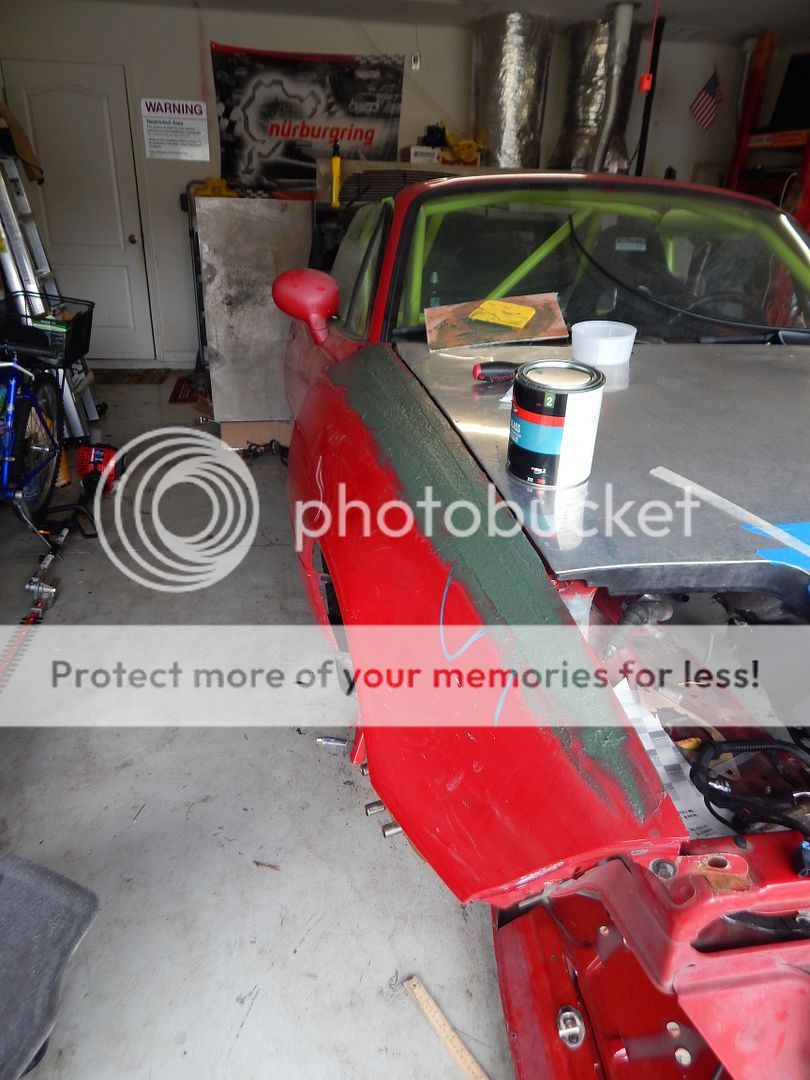

Wider fenders to fit 275's all way around

yup, I'm going to keep an eye on this! if your already doing an engine swap why not go LS? don't need that much power?
Yep there was a few reasons i didn't go LS, one was added price of the whole kit and powertrain. Two was weight, a bare bones LS was 120lbs heavier than stock and the T56 was about 60-75lbs more.
The LFX and 6 Speed is 40lbs heavier over stock which means I'm going to keep it under 1900 lbs for the car.
Did you buy a kit to do the swap, or are you fabricating everything yourself?
Building everything my self, as much as I can

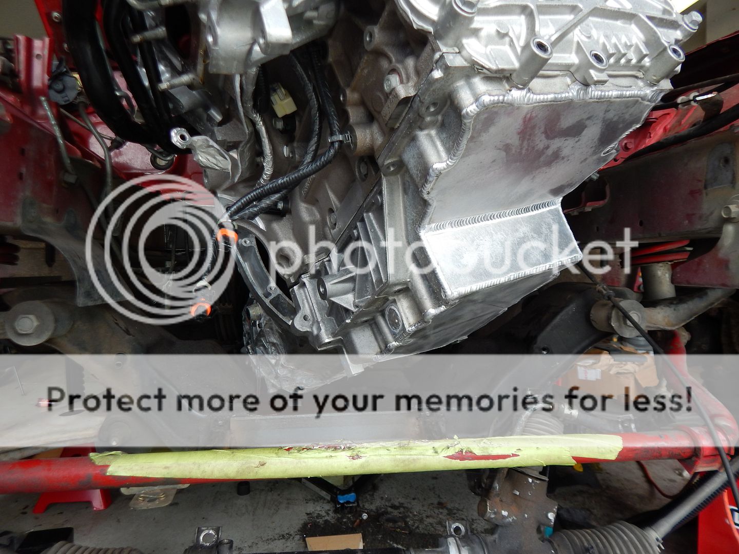

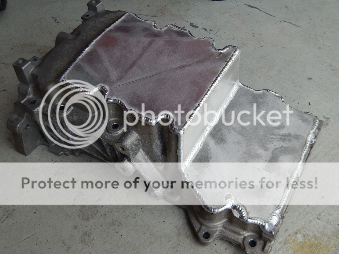

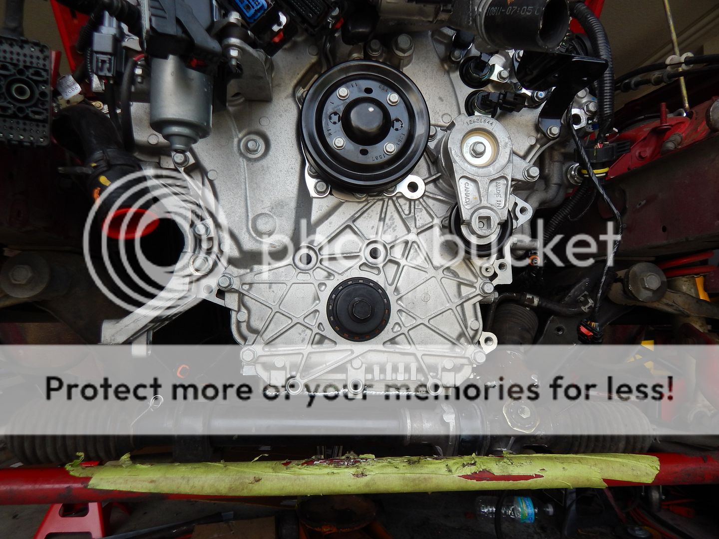

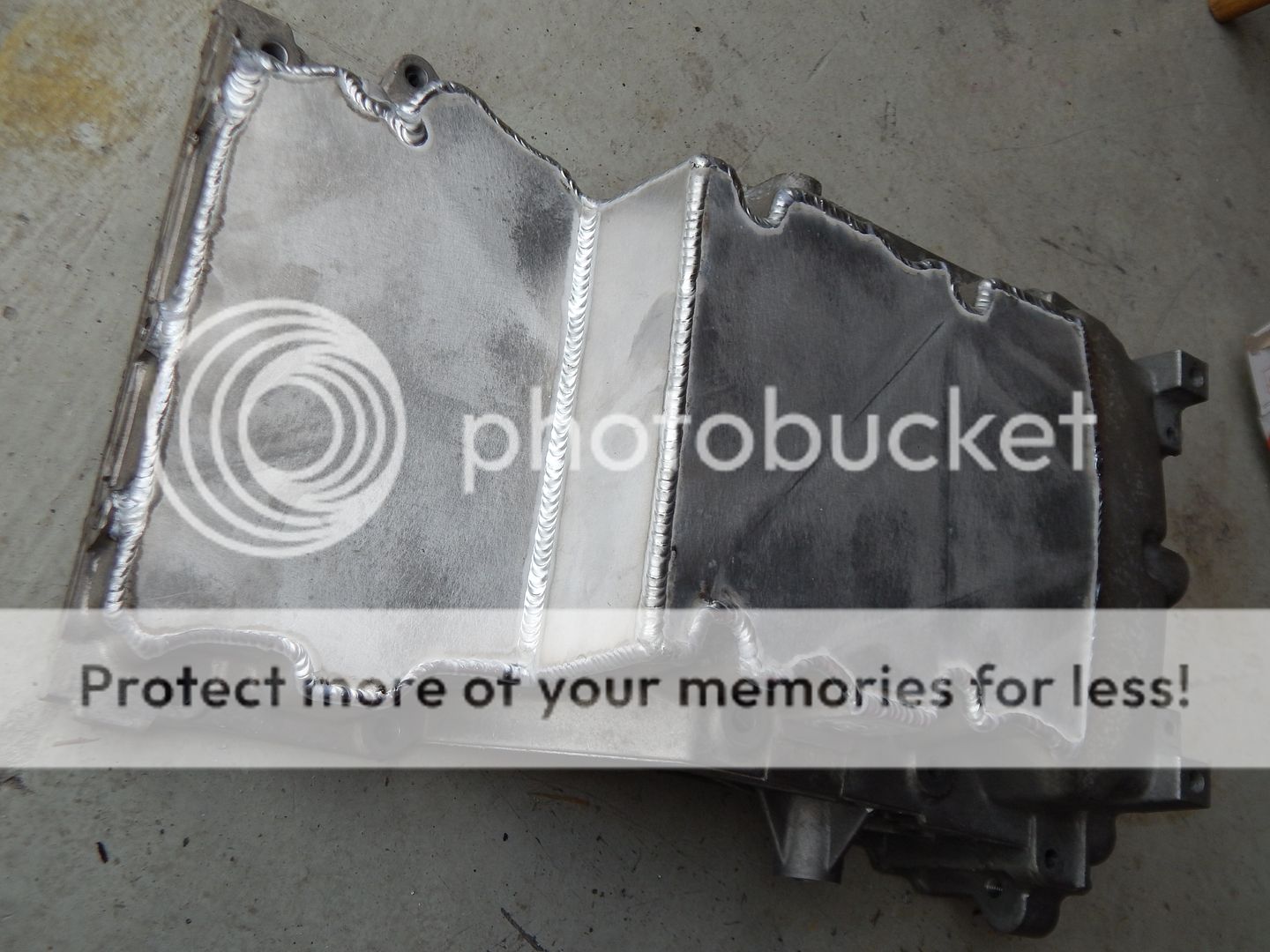

Here is my oil pan after cutting it and fixing the big hole after
