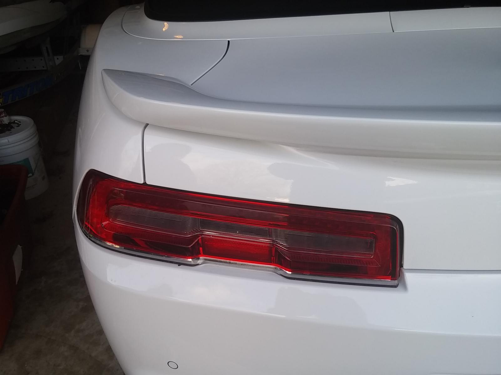

Here are samples of when I removed my dealer sticker
