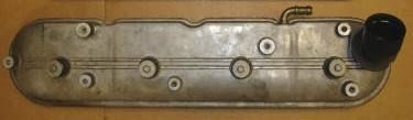

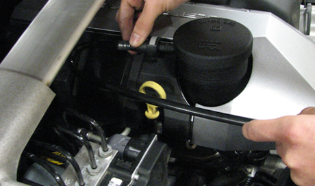

I'm thinking maybe the oil backed up inside the valve cover and entered the port for the PCV plastic pipe that runs on the dry side of the system over toward the air intake tube. I really did dump alot in at a high rate and that PVC port is real close to the oil filler neck. Some pics:
Black PVC pipe is shown here on left side of pic at front where it comes out from under the engine cover.
Here is a picture I borrowed from internet showing LS3 type of valve cover with PVC port right-angle fitting adjacent to the oil filler opening.

I'm thinking I caused my PVC system to backup in a similar fasion by dumping in oil too fast on the refill from oil change. I noticed the oil smell for a few days after this oil change mostly when I was backing the car down the driveway ... I think the oil fumes flowed out the exhaust pipe and then as I backed up they were pulled through ventilation system in to the car.
Guess I can try to disconnect the PVC lines, etc. and see if any oil appears. Or wait until my next oil change, dump the oil in fast again, then look.
