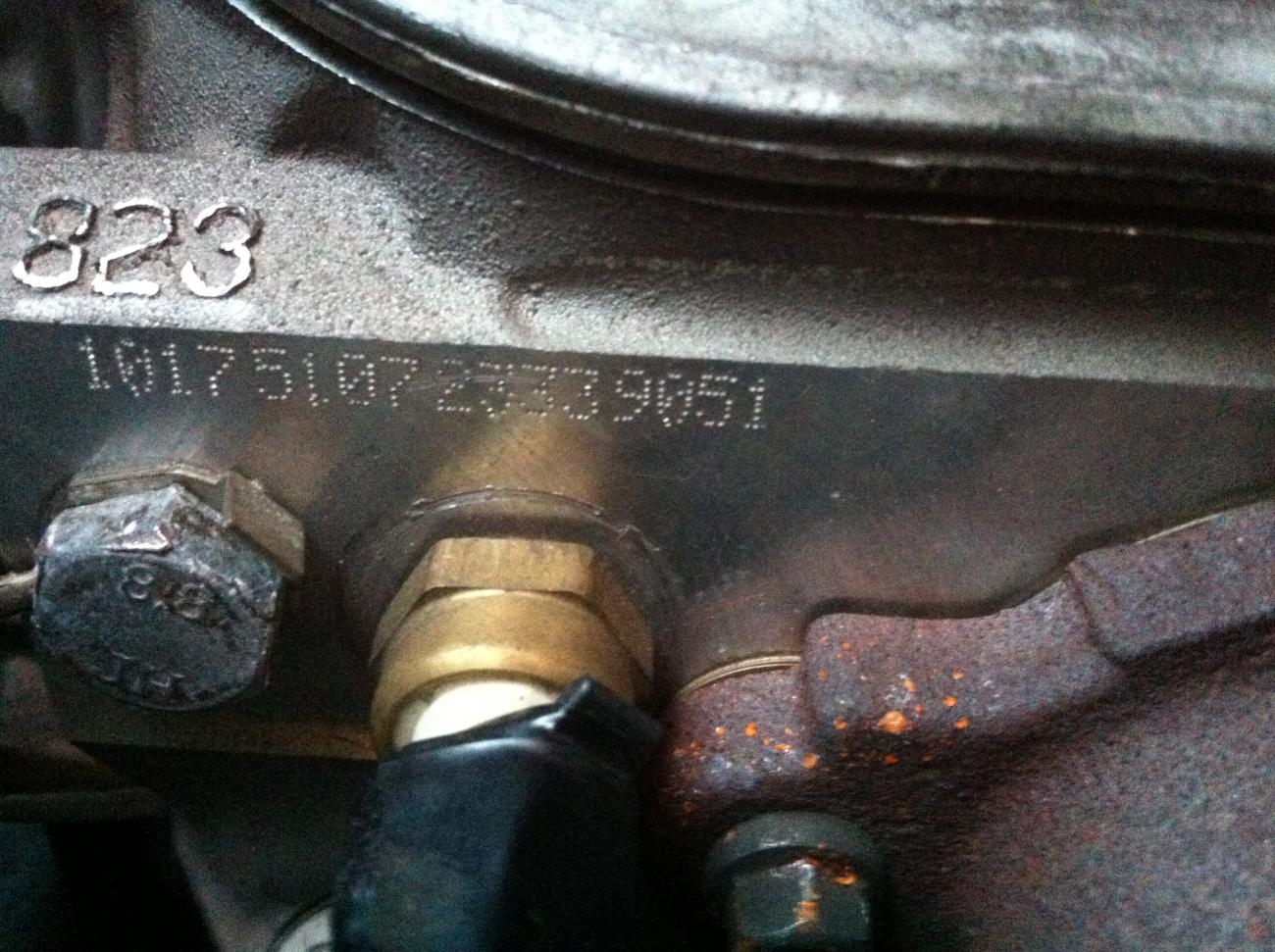

Sent from my SAMSUNG-SM-N920A using Tapatalk

Excellent! Thanks ccb1975! Looks like I am not alone over here

I have a 2011 Camaro SS L 99 and mine says 823 also

821 is LS3 with hollow intake valves.
823 is L99 with solid intake valves.
