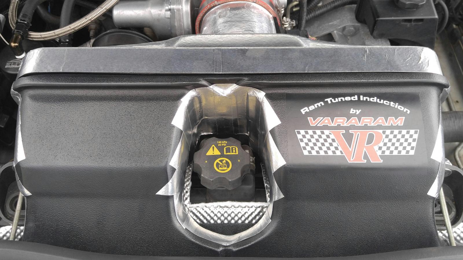

I just wrapped mine in DEI heat tape and new blanket on top of the radiator.
Where did you find that blanket? I also did the tape but yours seems to be holding onto the intake much better than mine. How did you prep yours?

I used Clorox kitchen cleaner with a brush in hot water on both pieces. It was nasty lol. I just done it saturday so time will tell if it stays. I got the tape and blanket off ebay.
Sweet I'm gonna try that when more of the tape comes off and I can imagine how nasty it was! These intakes seem to collect dirt and dust. Maybe I'll use the gold tape next time... it adds whp right? lol

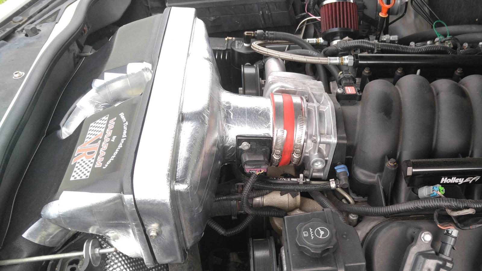

That is exactly what I want to do to mine.
Did you happen to measure the before and after idle IATs? Kinda curious how well it combats soak at idle.

It didnt help with stationary idle heat really but it cools off alot faster once I move. Even walking speed it drops quick compared to before.
