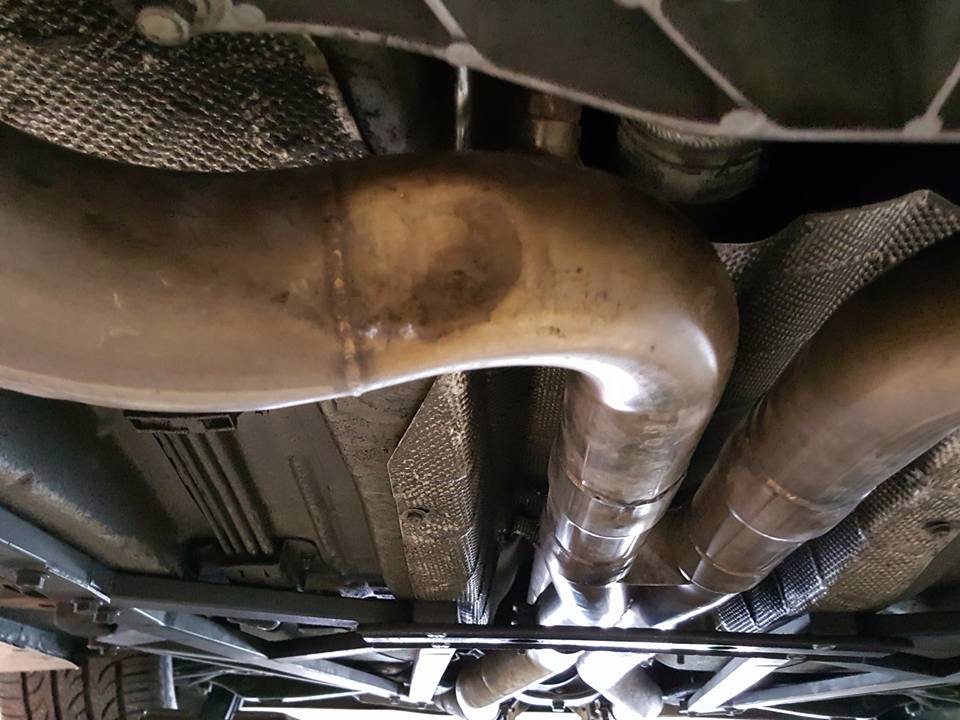

When you get it back from a shop and need to go to another shop to get it done right.

That is some talented welding
These are the finished pics.

I couldn't believe it when I seen the cut outs where only tack welded on there

Holy smokes, that's some real butchered exhaust work there.
Not related to the obviously hammered on mid-pipe but 4th picture down you see your o2 sensors? On the driver side there 2, of them. The grey wiring sheath is for the primary O2 for B1S1 and below it at an obvious downward angle I can tell is the wideband. I'm not sure who installed the Bung for the wideband as it is an obvious oversight as when you put an o2 sensor on a downwards angle like that the condensation building in the exhaust will collect on the sensor and rott it out from the inside out.
Always install o2 bungs at an upwards angle preferably 15* or so or else you'll experience premature sensor failure.
Glad you were able to bring it to another shop that knows what they're doing to correct the mistakes. You should post up the name of the shop so everyone knows to avoid them IMHO.

Unfortunately it looks like it is still at the wrong angle because its in the header collector. You can see this in the 10th picture (2nd of the finished ones)
