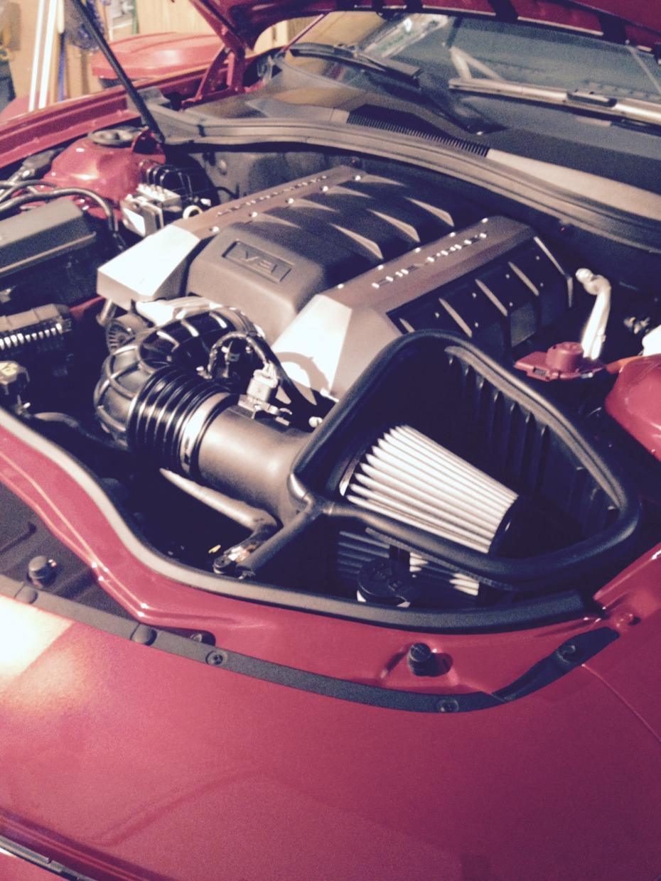

This thing has been so problem free I sometimes disconnect the MAF just so I can experience a problem with the GM Z/28 CAI.
