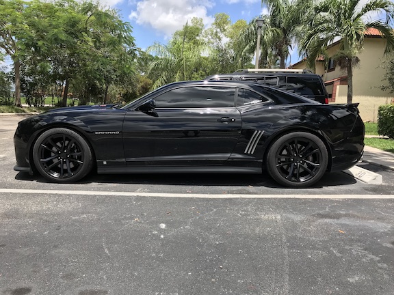

I am looking for recommendations on which high temp lube to use on the axle shafts or cv joints since my Camaro is lowered with 1.5" DSE springs. Did any of you change out the lube or did you keep it as is? I was told since the car is lowered more than 1" - it will add stress on them. Is this something I can do on my own easily or will I need a shop to do it?

Fronts - 285/35 ZR 20
Rears - 315/35 ZR 20
I have the Detroit Speed Engineering 1.5" Lowering Springs with the Koni Orange STR.T struts.
Any rubbing?
