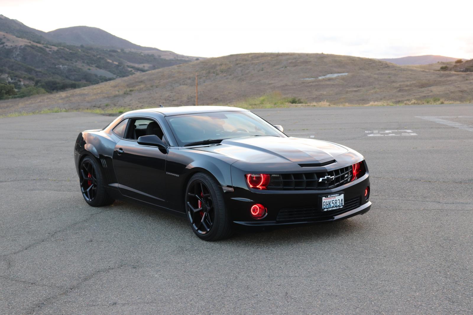

Glad to hear it's running better man!
Very good looking car I must add.
