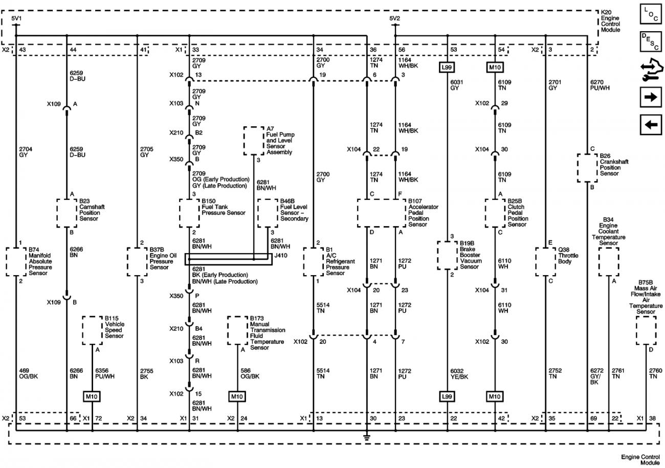

Here is a schematic for 5V references. If you need any assistance please don't hesitate to ask. Just make sure you have the majority of them unplugged and find a circuit to test. If your test circuit is at 5V start plugging the other circuits back in one at a time. When you plug one in and your voltage drops on your test circuit you've found your problem. Check for shorts and opens on that circuit and test the component if possible.

Happy to help man, if you've got a simple multimeter that will work fine. You'll need some sort of small pin to probe the smaller terminals with, the ends of the test leads will be too big for some of them. A t-pin will work fine if you don't have anything available. The schematic shows you which wire you're looking for by color. Essentially once you have the majority of them unplugged go ahead and pick one that's easy to get to and test, probe your 5V reference wire and check your voltage. If its at 5V (key on) go ahead and start plugging the others back in one at a time until your voltage changes. If its not at 5V, you'll need to unplug more of them before testing. Once you plug one in and the voltage changes you've found the circuit in question. From there I can help walk you through checking the circuit and checking the component it leads to.
Edit: You'll want to reference from the top of the schematic, you'll see where it says 5V1 and 5V2, that's your 5Volt side. Those are the wires you're looking for.
