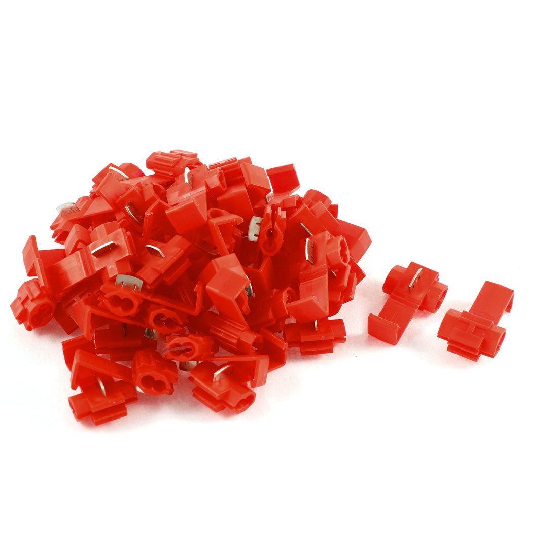

This is for wiring factory mic to the radio.
You'll need to find the black/grey wire from your OnStar unit inside your glove box (image provided by seishuku).
Then you'll need to cut and splice the FosPower 3.5mm wire.
Diagram of wire schematics below.
You'll need to use these 2.5mm button clip to bridge the wire to the factory mic wires.
Black => Black and Grey => Blue.

I bought mine from Amazon along with the radio.
