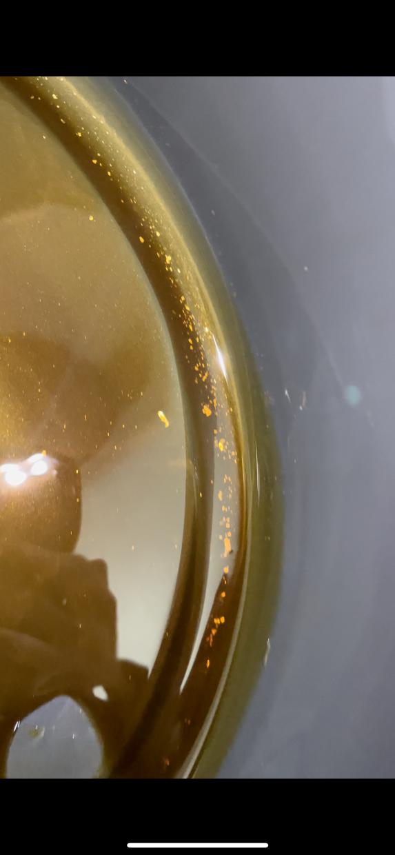

Spun bearing
Apparently a common issue in the LSA world. But it’s part of the game I guess. Currently sitting at 703 whp. bolt on +e85 car. No cam, heads or internal work. Hopefully I can salvage block. I’m sure crank and bearings of course will need to be replaced. Any suggestions on upgraded bearings? Buddy of mine uses “king” brand bearings I believe. If block, crank and bearing are all trash. I’ll prob be in the market for a new short block or stroker. Any advice is welcomed!
I’ll be letting an engine shop put it all back together. And I’ll throw motor back in. I’ll also be upgrading to the melling 10355 HV oil pump, SS3 GPI cam while it’s out. I was using 5w30 oil at the time of it spinning. I’ll be upgrading to 20-50 VR1 oil as well. Once motor is back in the car. Will I need HV oil pump if I switch to VR1? I got a few LSA buddies running factory pumps with 850+ . Any other suggestions?

Fingers crossed. Part of the game tho. Luckily I got a daily to drive. And it’s winter when it broke. Not mid summer. Looking for the bright side lol
Originally Posted by rednecks70 View Post
How did you catch it? Low oil pressure? Just want to know what to look for.
Did a very small pull to pass someone. And just happened to look at my oil temp gauge and it was at like 240° on a cold night. Then looked at oil press and it was sitting at like 10-15 psi cruising. And only like 6-8 psi at idle and heard it lightly knocking. Luckily I was 1/4 mile from my house. Got it on my street and shut it off. Coasted into my garage. Where it’s been the last couple weeks. Til I can pull motor.

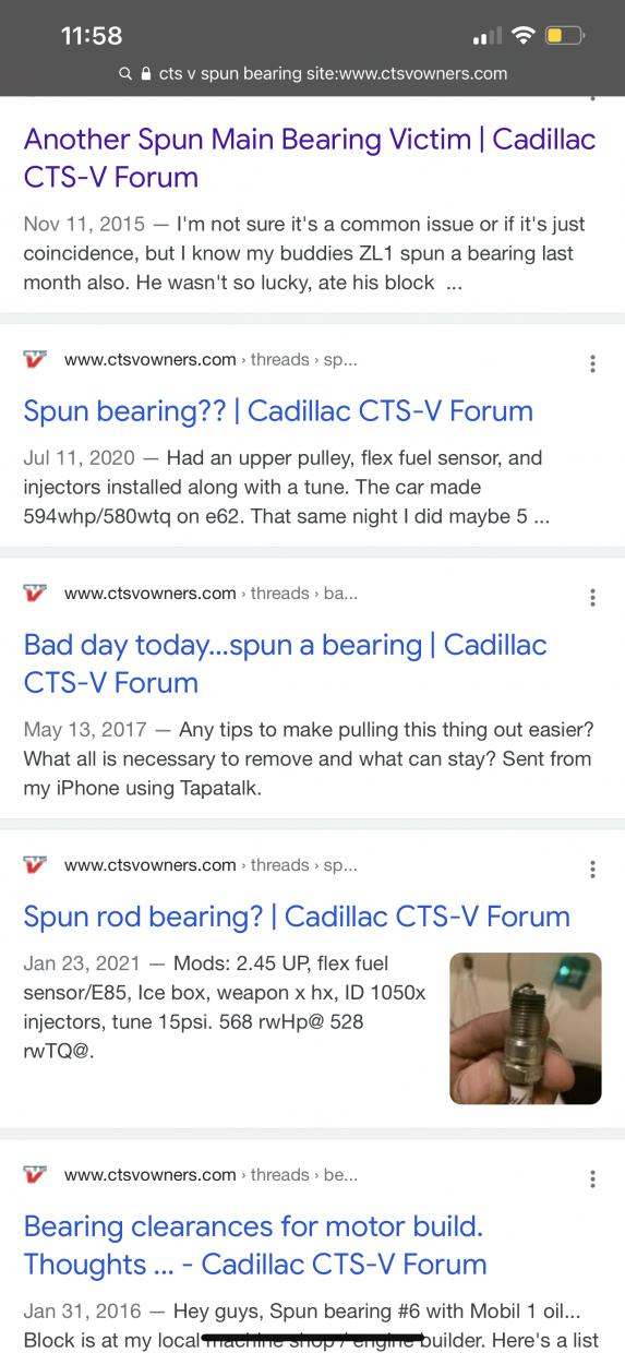

Man that’s crazy. Every LSA guy Z or V around here is running that 20w50 VR1 and I was the only one running 5w30 and I somehow spun a bearing. Both my tuners at GPI recommended the VR1 as well. As it’s not daily driven. I guess I’ll do some more research.

It’s apparently very common in the LSA world on the V side. There’s so many posts about spun bearings. It’s not even funny. I reinforced brick. Did solid isolator. Vented crankcase. I did everything I thought would be good enough. I read horror stories about M1 5w30 which is what I was told to run. Now all my racing buddies and tuner are telling me I shoulda been running VR1 5-20. So idk. I trust their word. And yeah I can’t wait to get it out and see the damage.
