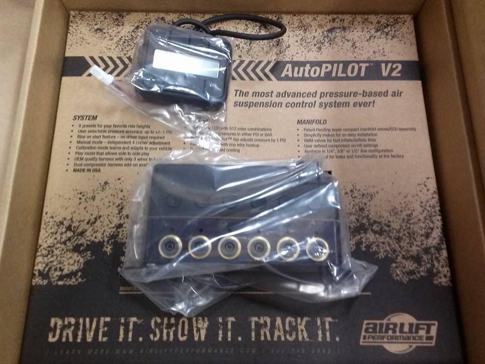

Well photos and what have you are going to be slow. Yes I have a shop to use and a Lift. I have had the kit in boxes for 3 weeks now. I only opened them up yesterday and took pictures of what was inside.

I decided to go with the most current version of the Camaro air lift with the V2 set up.

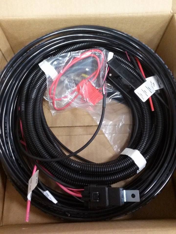

Second would be the constant ignition wiring I am a bit gun shy on just tearing into the stock electrical so tell me where and what you guys have done and post some pictures of such as well.

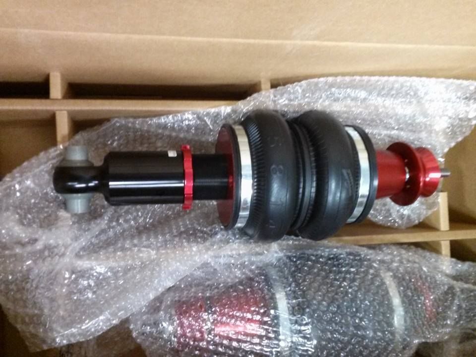

Third the coils are adjusted to a certain height already is this OEM stance or a lower stance and I will need to adjust accordingly?

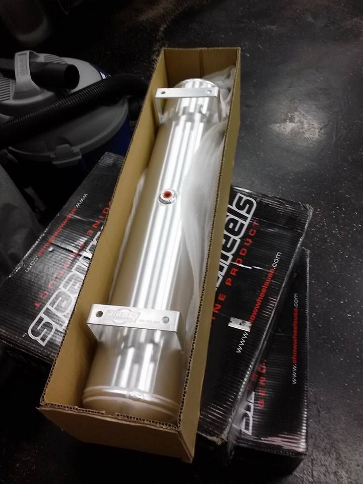

My last is deciding tank setup. I went with the aluminum tube and a single compressor . I read that the box air control box is suppose to be set up higher then the tank to keep out moisture. And down here moisture is a SERIOUS issue. So I will have to address the drain hole as well. I plan to run possibly two dryers and also set up a back up camera.

okay note to anyone taking anything in the trunk apart the plastic shield goes up against the back of the car it has two little tabs want you and screw all six little some screws that hook up the cargo net you need to actually lift up don't pull out or you will break one of the tabs I pointed at it in the pic.
In the second picture and the third picture for placement so far I'm liking to put the tank all the way to the back I haven't decided if I want to build some sort of structure frame or just mounted directly to the trunk of the car.

I found a big piece of aluminum I think I'm going to use that as my mounting plate put some rubber bushings underneath it separate everything with rubber bushings between the equipment to the plate and use some type of flat strap welded to the plate to secure it to the entry point to the backseat. I will probably make some angle bracket and secure it to the wall and drill a hole to run the drain. Along with making a raised mount to put the manifold on.

Well what would recommend for an ignition source constant live wire. I noticed the fuse block on passenger side by the trunk.
I have also decided to leave the damper rate at 15 for the rear. I just don't feel like cutting big holes into the trunk of the car.
And at what settings would the car sit at stock height if I adjust the coil overs. Or should I leave them where they are to get that height?

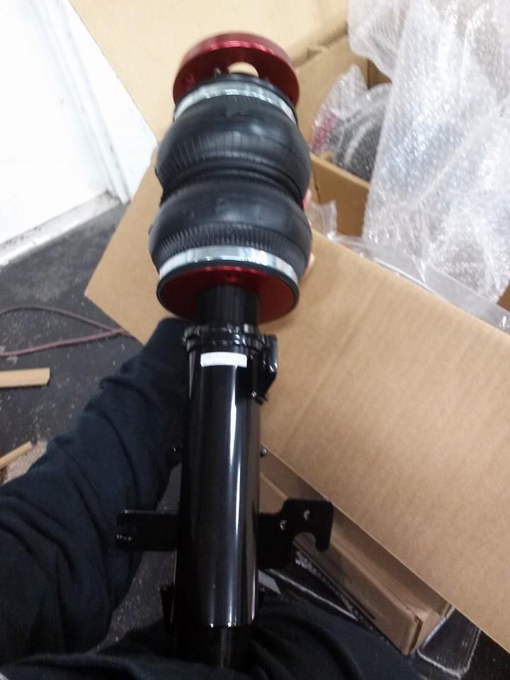

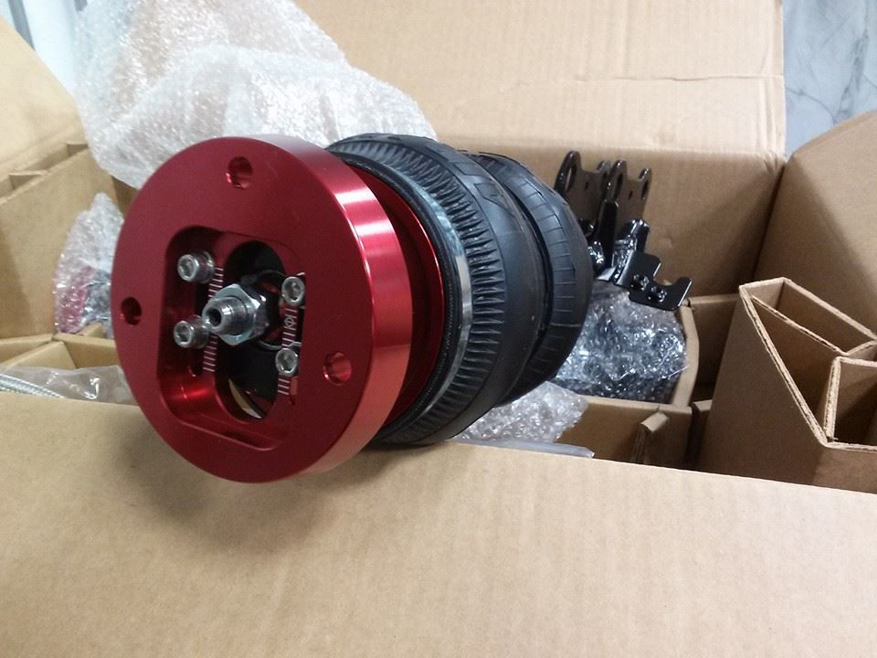

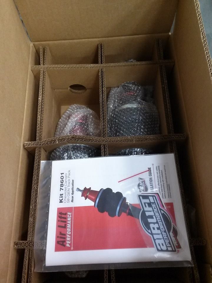

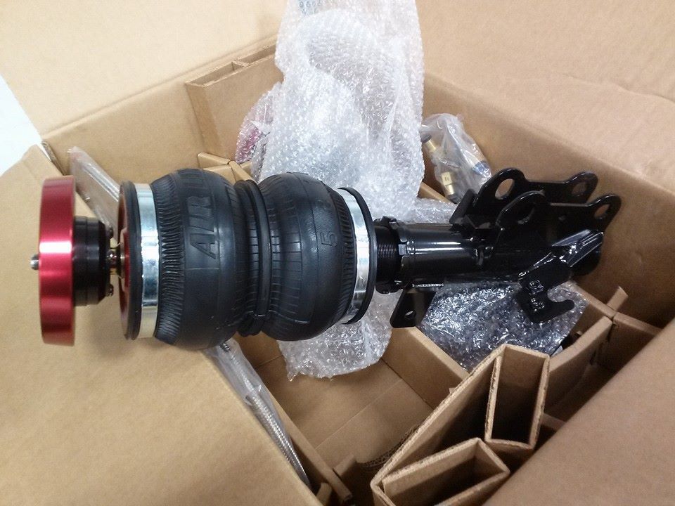

Well for ride height I want to sit stock as a primary and I will have a couple of different settings for rolling low. But everyday driving I don't want anyone to realize what is different until I hit a button.

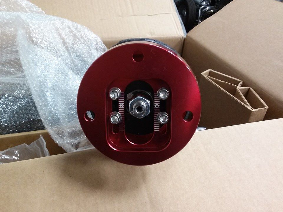

The new struts for the rear have a damper rod and according to instructions you are suppose to cut a hole so that you can adjust them. I don't see myself becoming a track guru. Maybe slide around a few corners or across intersections but that's about it. And I usually have the rain to thank for that.
This is a manifold box as you can see in the pictures following this. If I am not mistaken other then the white Camaro that is in the brochure I don't think anyone else has this version of the kit installed yet. Jeremy could say if I am wrong.

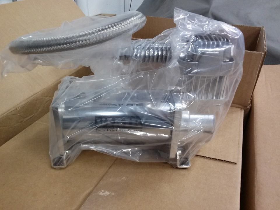

The tank is a 5 gallon. I did debate on the wiring harness and second 380 compressor but decided to go this route and see how I like it. I also considered making solid air lines under the car and bent to follow the chassis. I will have to spend some r n d and see where I go from here.

The plate and all risers are aluminum to keep weight down. I decided to just sand the aluminum for a raw finish. I can always paint it later.
I isolated everything with rubber bushings. In fact I probably have 40 dollars just in rubber. There are bushings between the tank and plate, plate and trunk carpet, a second set on the compressor, and also the air manifold.

Use green 12 volt wire used to power the 12 volt accessory socket in center console. This is what i used for the ignition Source. If you have any question feel free to ask. The install was pretty easy, and once you drive it you will notice that it performs and handles much better then stock. Riding on air daily driver!!!!
