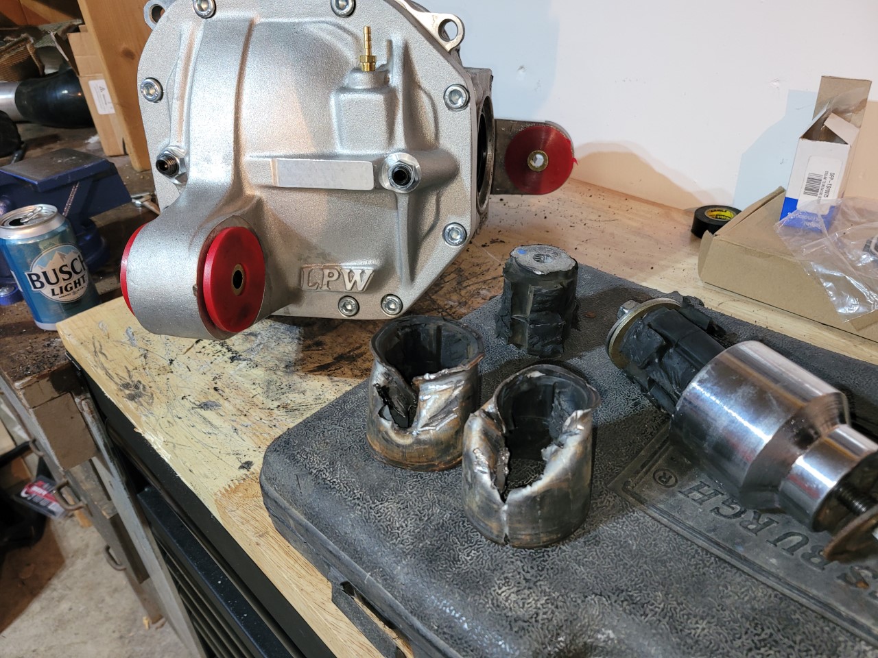

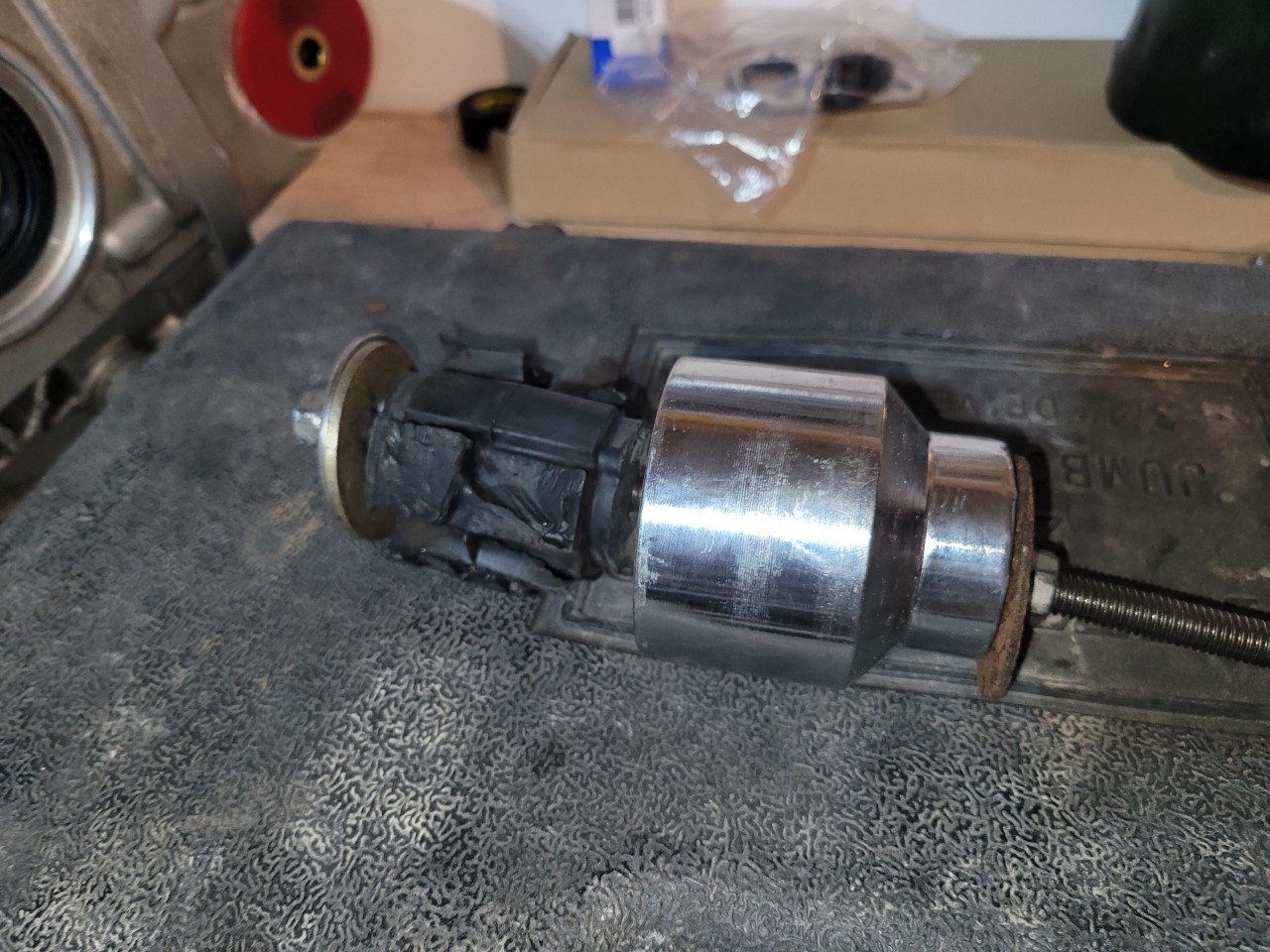

Diff out, local shop install trutrac, stayed with stock gears. NOW, replacing the diff bushings with BMR Bushings is another story although I found-invented (?) a removal tool for removing the original bushings. big 1 1/2 socket, 1/2 inch all tread, several washers and nuts on both ends. ran the all thread thru the socket and stock bushing, put couple washers on each end and started tightening. make sure the washers opposite of socket are smaller that the socket so it will pull the rubber bushing into the socket. The rubber will rip out of the metal sleeve. use a saws all and carefully cut a little into the sleeve and use a chisel to beat the metal out. Is a PITA but just keep working at it.
