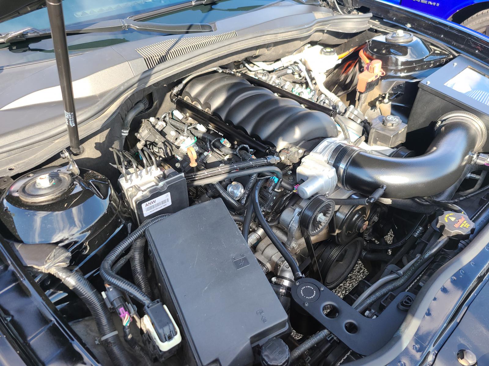

I went with this set up from Holley (https://www.summitracing.com/parts/sne-850013) and then ordered a line pre made from AN (https://www.anhosefittings.com/?mscl...=AN%20Fittings) Then I rerouted all the hoses with 3/8 fuel line. I stripped the fitting off of the factory evap line and ran 5/16 fuel line from the purge solenoid to the evap line from the tank. I believe that the quick disconnect that I got for the evap line was a 5/16 also with a 45* angle on it and you can find it all over the web. And the quick disconnect that I used for the fuel line was an earl's fitting from Holley. If you like it and need anymore info just ask. Oh and I used the Holley valve covers also.

The crossover in the rear comes with the fuel rails, but the main fuel line I think I ordered a 16", was a little tight so maybe a 17". I just used a tape measure to get an estimate. The fuel rail comes with 8 AN fittings so I just went through the building procedure on their site and built a nylon braided 8 AN fuel line with a 90* on one side and a straight fitting on the other end. I believe it was like this (https://www.anhosefittings.com/checkout/cart/). And the quick disconnect is here (https://www.holley.com/products/plum...ts/AT991986ERL)

Yes except for the evap purge line to the purge solenoid, it is 5/16. I know for sure that the quick disconnect side of the fitting is 5/16 but I can't remember if I used a 3/8 fuel hose to connect it to the purge solenoid or not and it needs to have that 45* angle on it for it to allow it to lean over towards the solenoid.

Yeah it looks like in my photo it is almost certain that it's 3/8 hose. I just stripped the fitting off of the factory line to reuse with the hose to the quick disconnect. I don't have my car here right now or I would go take a look at it but it's currently in the shop having the engine rebuilt.
