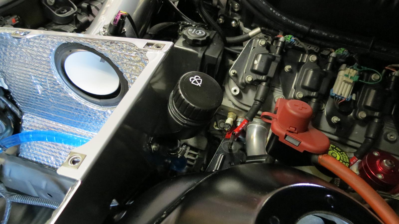

I also will never use it, but located the fill bottle here:

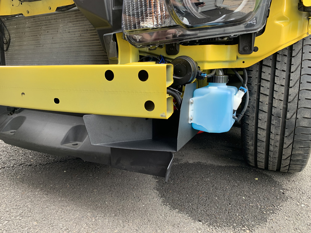

With that, I have the same setup as hesster with the tank mounted on the air scoop and the filler tube mounted to the CAI box. I happened to have the front bumper off at the time for other projects, but it is not required for this install. If you do go with this setup, it is a lot easier to mount the tank to the scoop first, and then install it on the car.

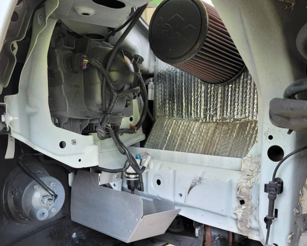

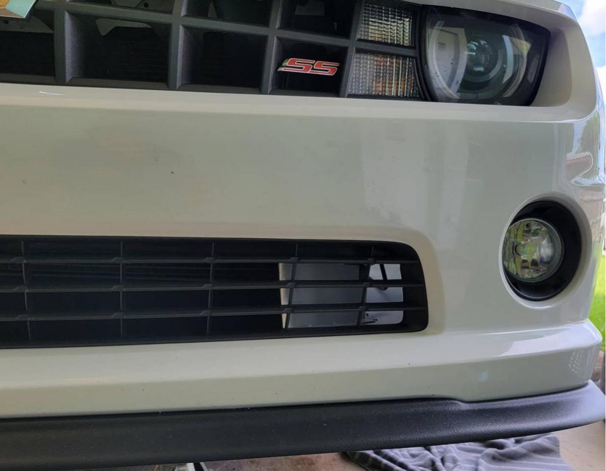

Pics from my build thread...

Bald Eagle, You cut away quite a bit of the plastic in front, Did Jannety recommend that much?
