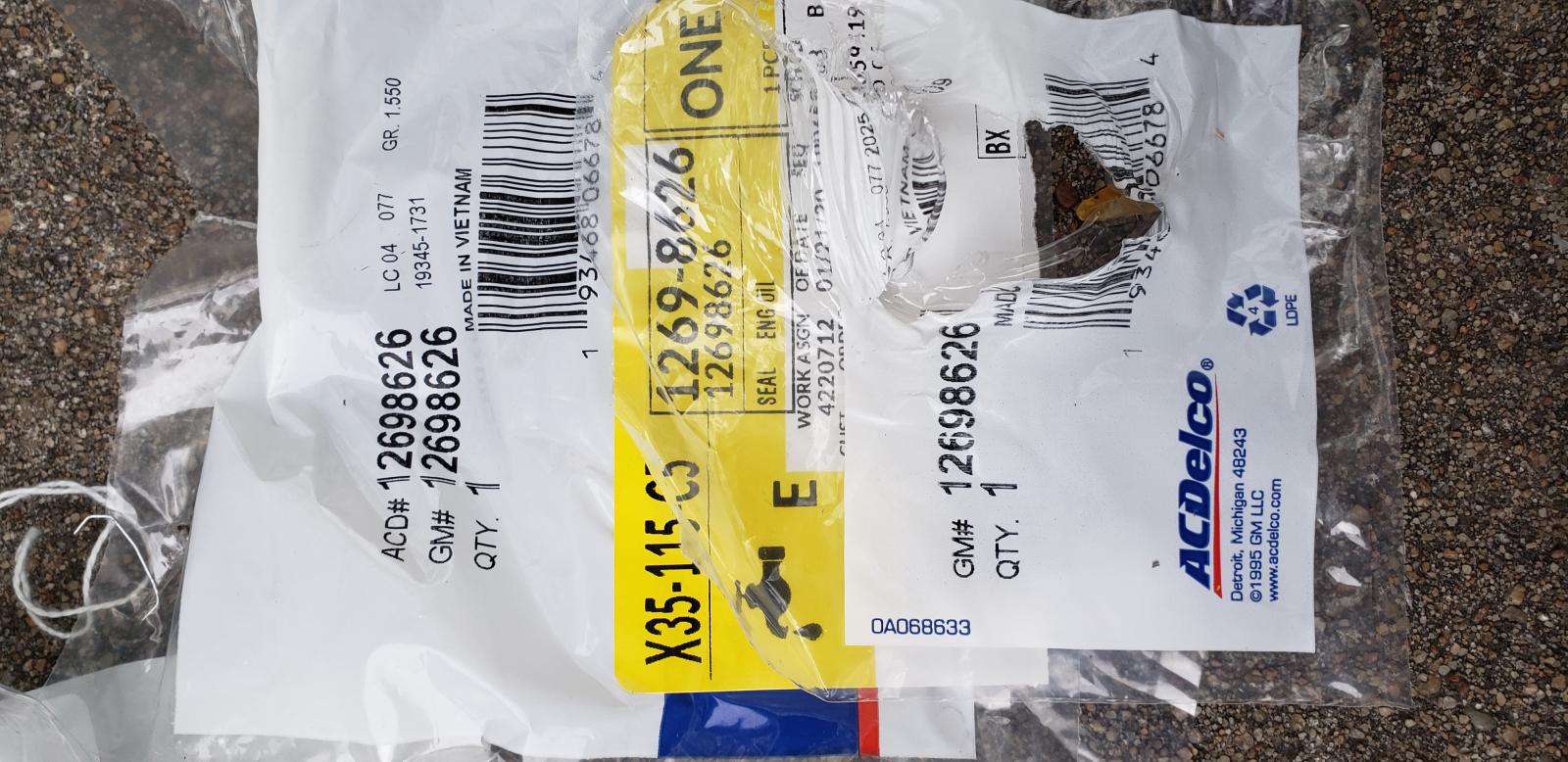

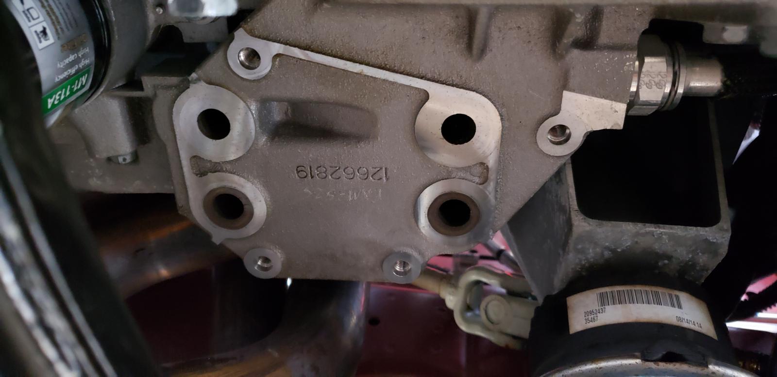

I ended up purchasing the factory manuals. Here's the direction on the oil cooler brick installation. Apparently, the extra heat from longtubes can sometimes cause these o-rings to fail.
I took off the "brick" that is the cooler itself, and left the plumbing attached. It has coolant running through one side, to bring the oil up to temp when it's cold, and keep it cooler when it's hot. You can tell which side the oil runs through by the discoloration on the ports.
You'll need a torx bit on a 3/8's drive, a 4-6" extension, and a swivel for two of the bolts. It looks tight, but it's totally manageable. Drain your oil completely before you drop the brick; when you pull it off some oil and coolant comes with it.
The part number for the o-rings is 12698626. You'll need four. I torqued my bolts to 216 in/lbs in the typical 4-bolt flange sequence (I couldn't find a recommended sequence anywhere.)
It looks like a huge pain, but it's pretty manageable. Unfortunately, it looks like the o-rings weren't the problem, but the actual brick itself. I tucked the car in for winter yesterday, so I have a couple of months to track down an alternative cooler. I'd be happy to take suggestions!
