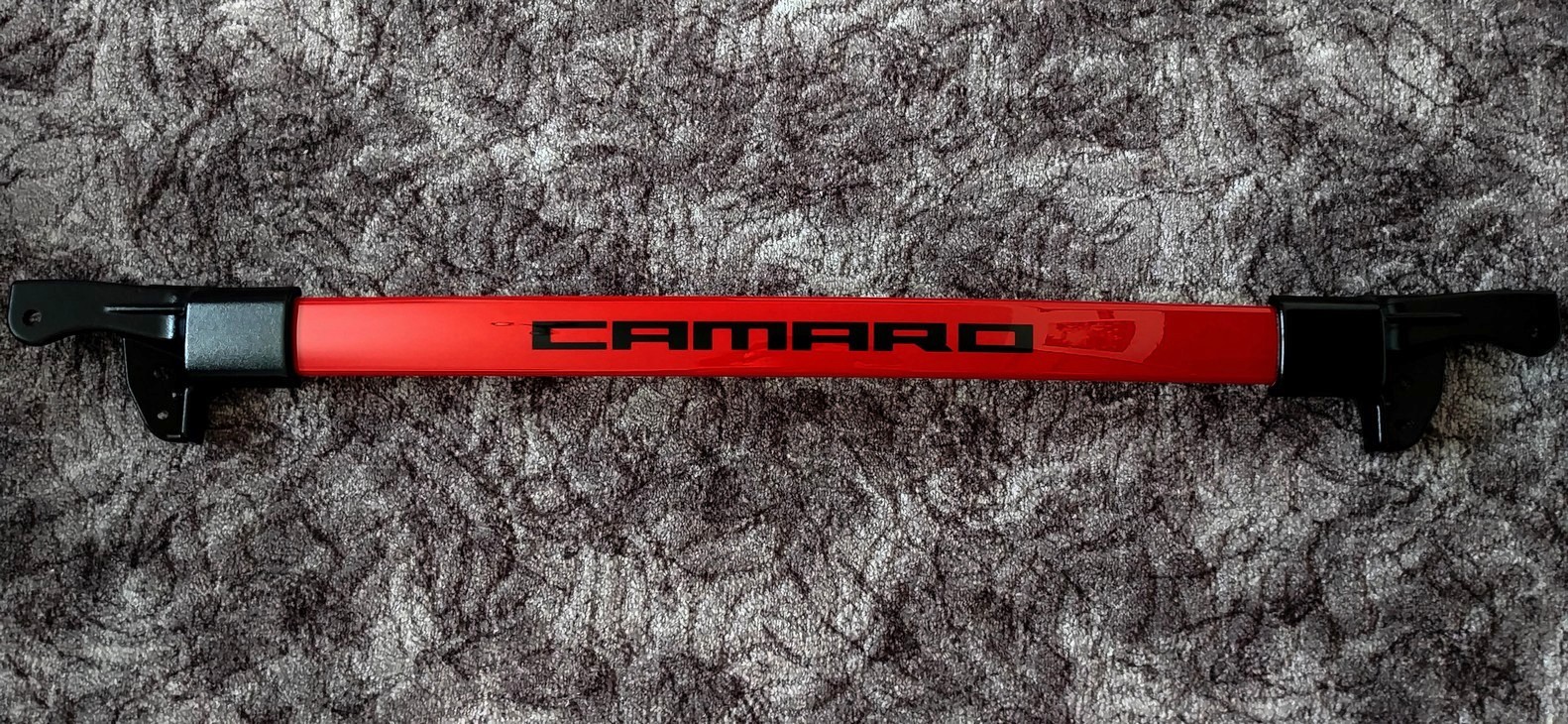

I used the OEM strut tower brace with TPIS pads. But it is a bit more difficult to drill the necessary holes.
You need to drill vertical holes in the inclined sheets of the shock absorber towers.
Today I probably wouldn't do it anymore and use something from BMR.

Here is the BMR Strut Tower Brace for the 2010-early 2011
