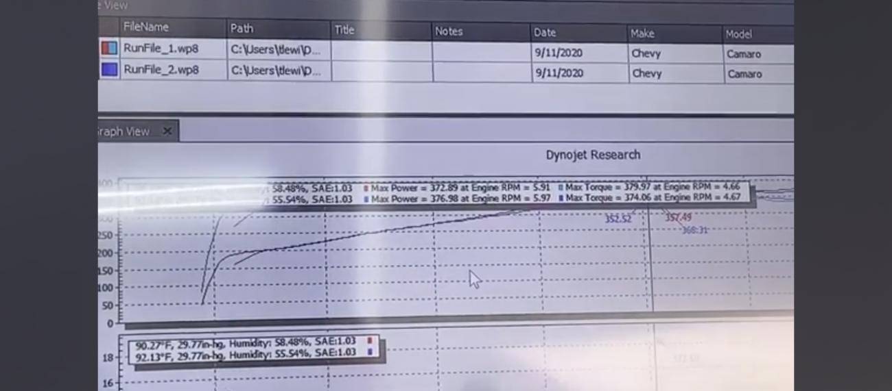

Not sure where you got that info from, but 5000 RPM is way too low for peak HP. A quick YouTube search shows stock SS Dyno sessions prove peak HP comes right at 6000 RPM.

Good stuff joshnmn.. I too thought that was too low..
