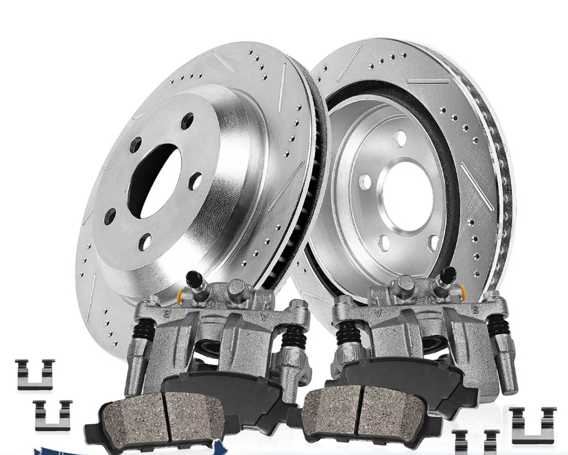

Just ordered my V6 brakes off eBay
https://ebay.us/moMoM3

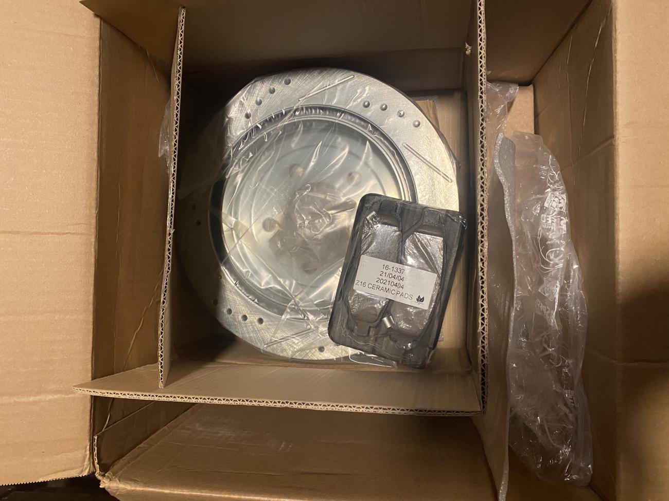

I’ll say from box weight 51lb I’ll get better numbers when I pull mine off! Box was 53lb
