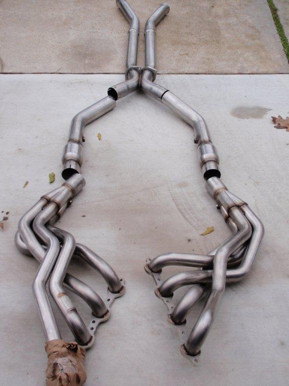

I don't believe AHR ever changed anything... I got mine when they first came out... no chopping to fit...
This should be exactly what you have... The cat section you see I had to get swapped out to neck down to 2.5" since I didn't use the ARH X-Pipe.
