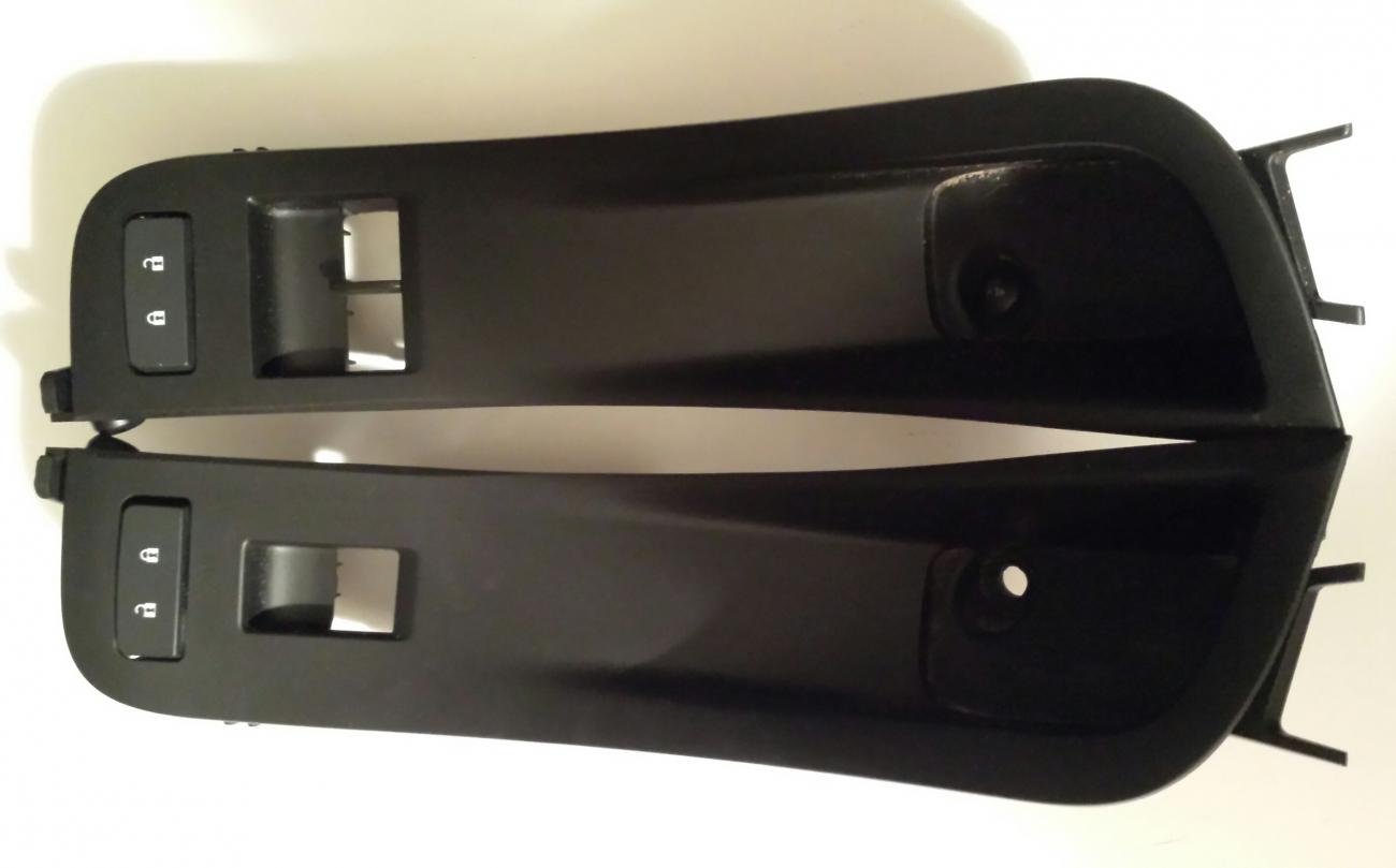

My new door switch
Here I show this video of my new switches on the doors when I get back from the holidays I'll show how I did and what parts I used to use the stock panel-through connector

Step 1:
I took the switch signal from radio/HVAC control or Body Control Module (X2 L-Blue connector). you can attach the t-tap to this wires. I prefer to solder the wires I would not do this if it was not permanent modification.
door lock switch lock signal Pink/Black wire
door lock switch unlock signal Orange/Black wire
Step 2:
make the connector. this is the switch diagram
Step 3:
must to pass the lock signal wire through the door connector. this thread can help http://www.camaro5.com/forums/showthread.php?t=155660
here we use the terminals for this connector
if you want to use this mode or can pass the wire around of rubber boot
body harness
door harness
on the door harness I changed the wire color. Please don't do that because it can be confusing
Step 4:
as had to pass two wires through the driver door connector. but only has one pin available, *I used the ABL wire (purple) for unlock signal and connect the LED (ABL) to the circuit LED backlight dimming (yellow)
ABL with my wiring
these are the steps that I took
