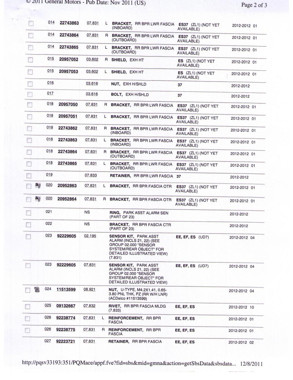

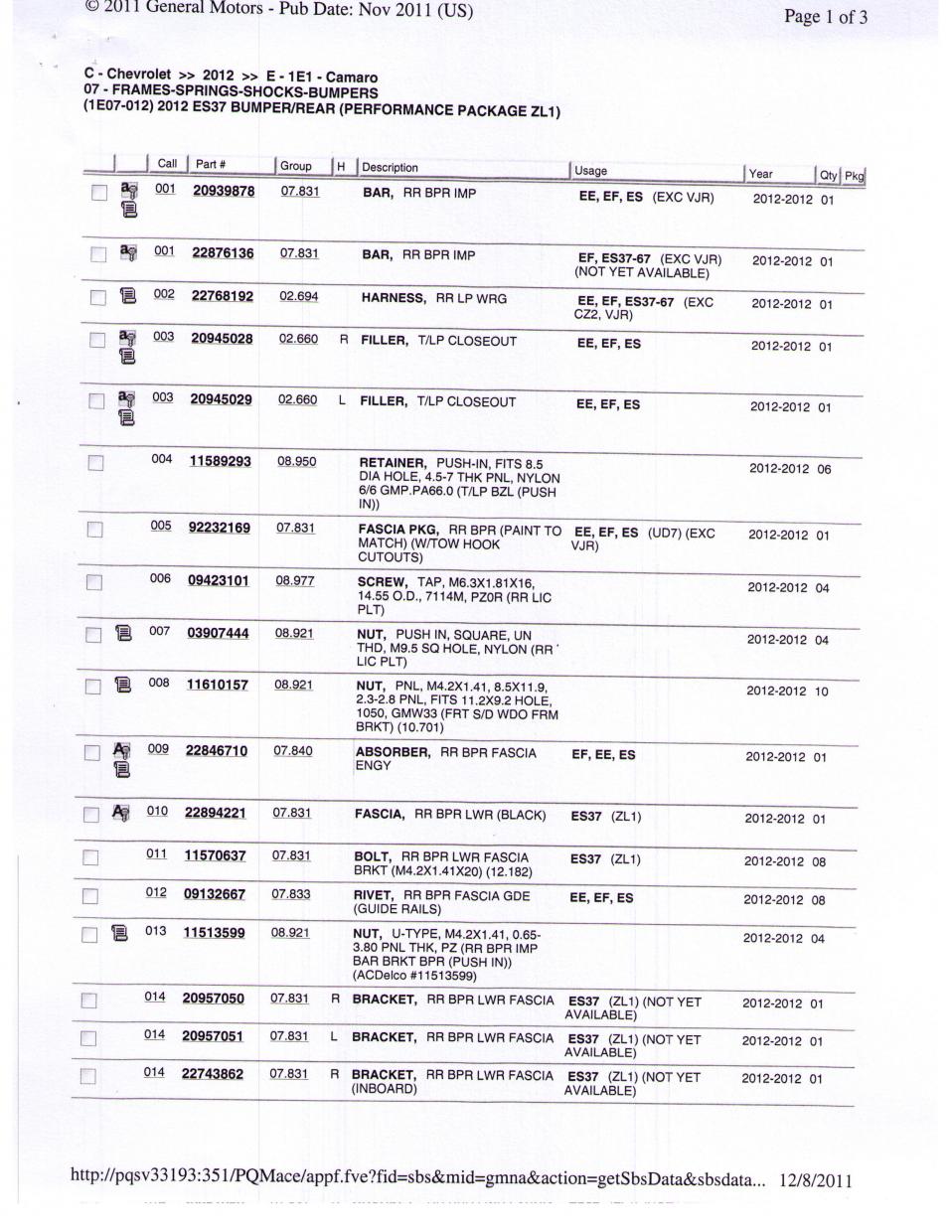

OK guys here is the rear, I do not have prices as i cant post a price if i had it you will need to do that.
New part # for the ZL1 bumper is # 22894196 there is no price as of today and non in stock, and you may need a new absorber too but i dont have a #
Parts you need:
#22894221 Fascia List:$129.76
#22895336 mud flap $33.64
#22895337 mud flap $33.64
#20952863 brackets $16.37
#22743862 brackets $7.58
#20952864 brackets $16.37
#20957052 heat shield $119.77
#20957053 heat shield $119.77
#22743863 brackets $7.58
#22743864 brackets $7.58
#22743865 brackets $7.58
And i say you need this.
#22846710 absorber $118.04
Some members dont think so but i say yes.

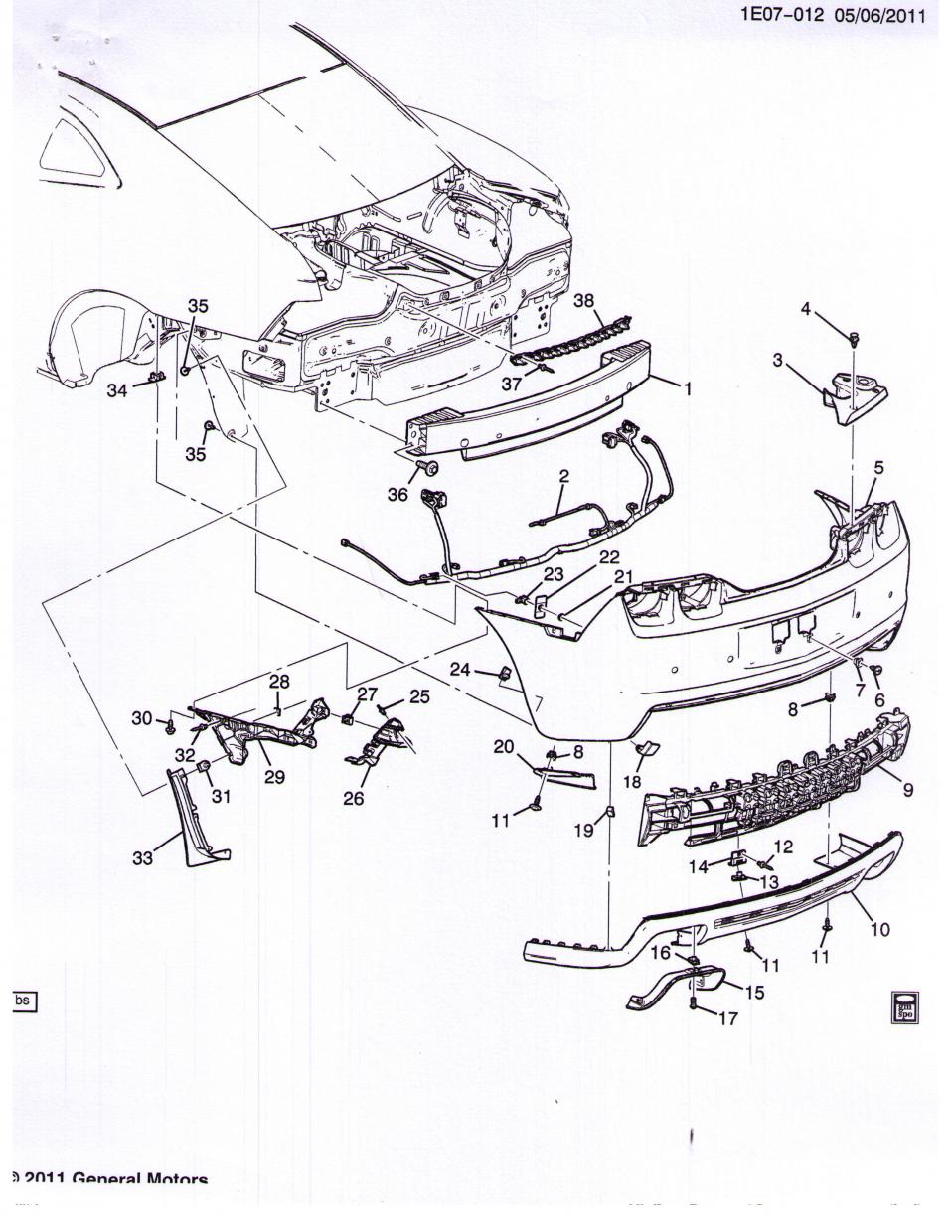

so looks like we would need #s 10,15,16,17 for the diffuser?
there is a lot more then that, you will need # 18,19,20, may be 12,14 too

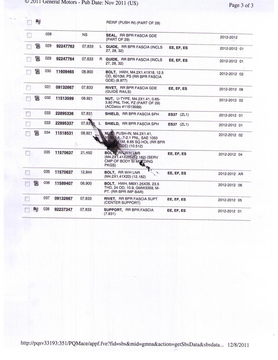

I'm hoping number 33 for the left and right side are a bolt on to our SS. If they are not too pricey I may get a pair and try. You think any other parts would be needed like #29, 30 and or 31 ??
Ed M.
They do.

Just checked with my dealer and he wasn't able to bring up any prices for #33 yet but the part numbers did show up so hopefully soon they will be available.
