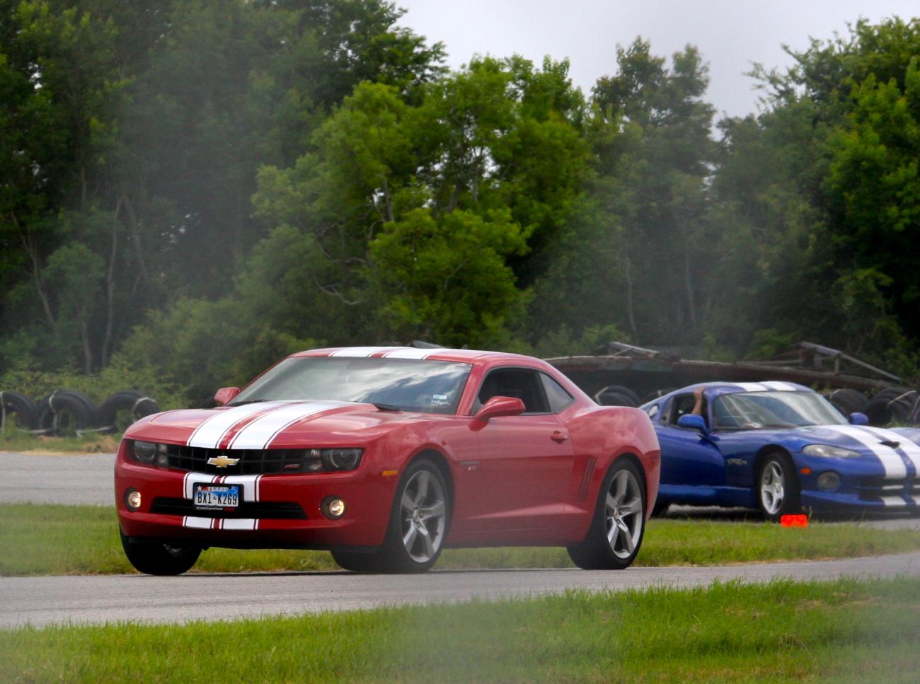

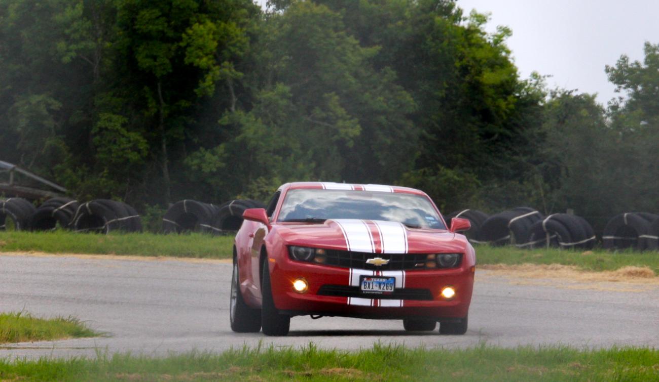

First trackday in the Camaro!
Did my first track day in the Camaro. It was on a track that I am very familiar with on the motorcycle so that made it a little easier for me but still it was totally different. I have NO idea what I am doing. I do know that I will need new brake pads soon! Anyone have any tips?
