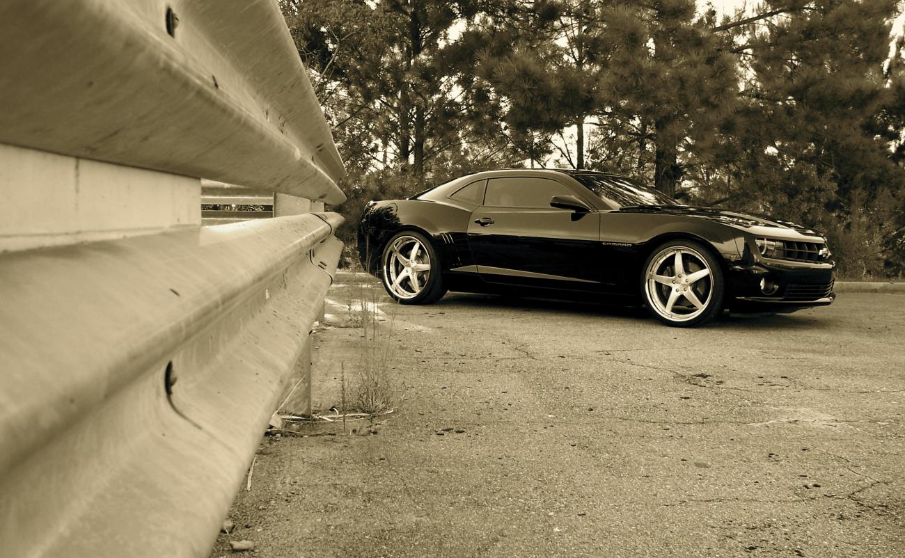

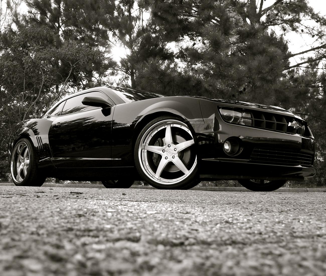

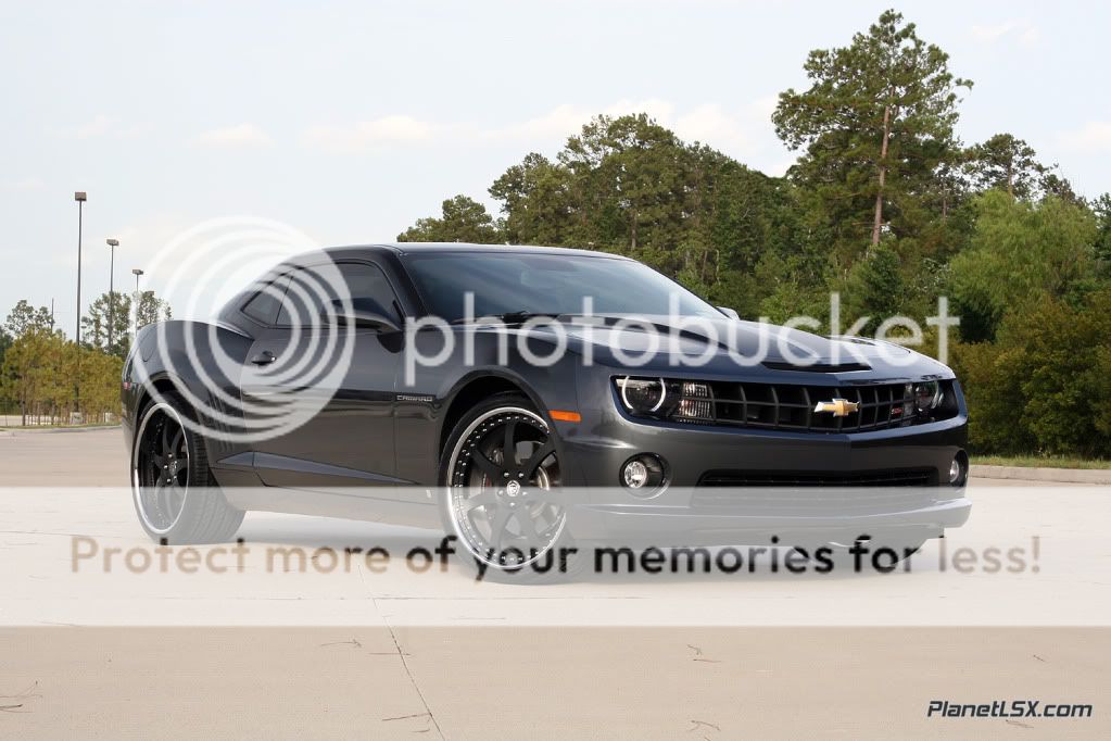

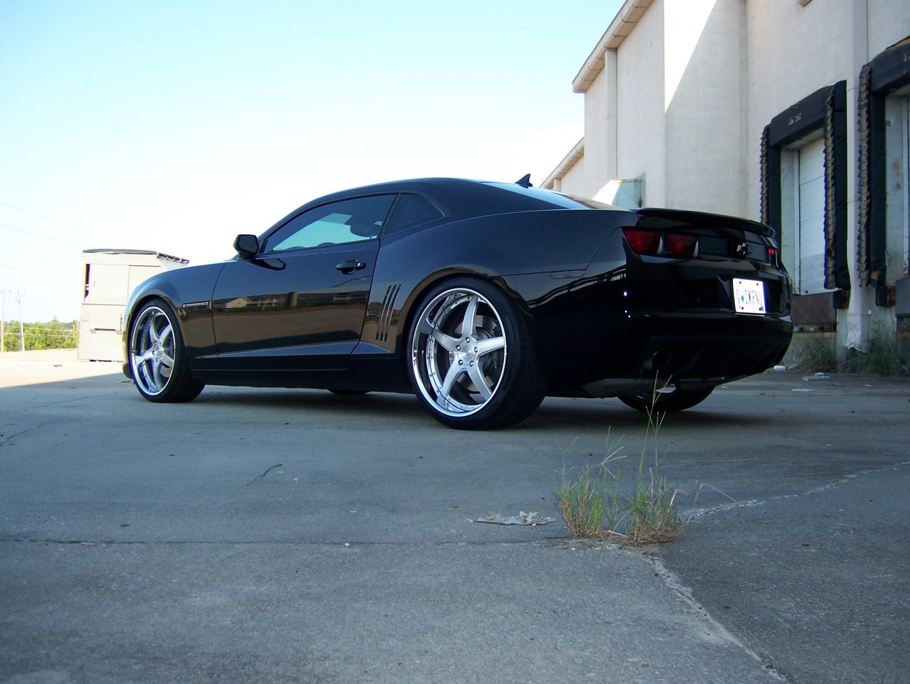

A few of our customers rocking Pfadt springs and aftermarket wheels.
Oh, and don't forget Randy!
