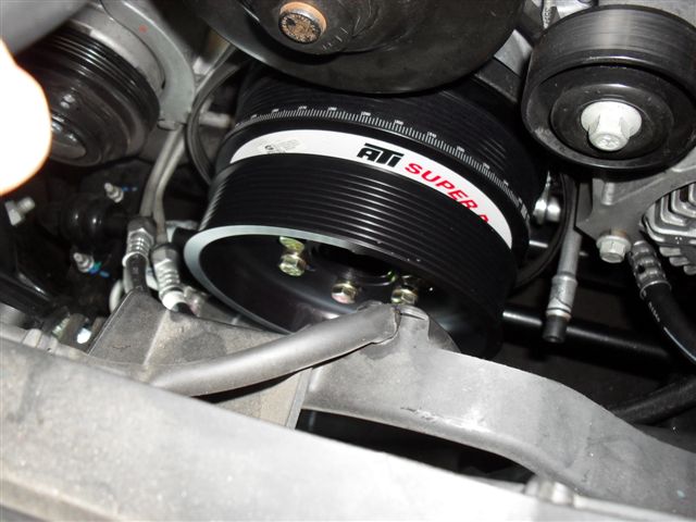

New ATI Damper.
Name:  Vortech Supercharger Install 005.jpg
Drilled damper and crank for dowel pin to keep from slipping.
Name:  Vortech Supercharger Install 015.jpg
ATI Damper and drive pulley installed.
Name:  Vortech Supercharger Install 021.jpg

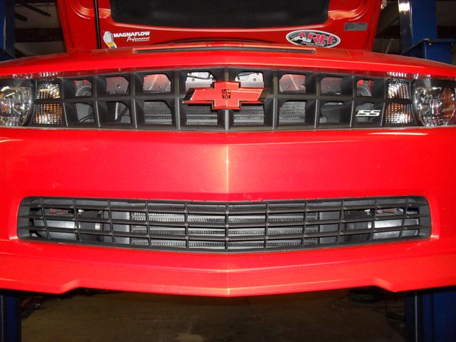

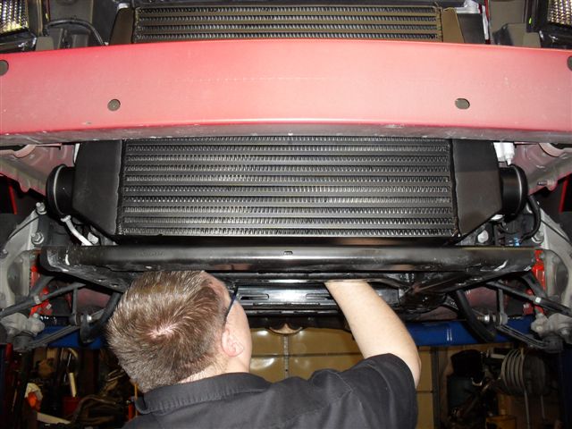

Charge air cooler installed and painted black for that stealth look.
Name:  Vortech Supercharger Install 017.jpg

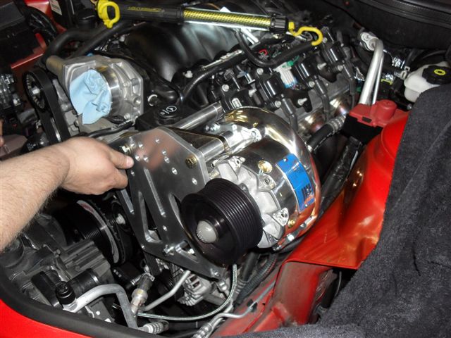

Charger bolted up and last bracket plate.
Name:  Vortech Supercharger Install 027.jpg

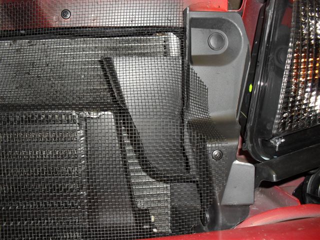

Charge cooler plumbed, installed hardware cloth (screen) to protect from bugs and debris. Also note the factory intake air duct(upper right of cooler)
has been cut out to improve air flow to filter.
Name:  Vortech Supercharger Install 052.jpg

You really have to look to see the charge air cooler behind grille.
Name:  Vortech Supercharger Install 062.jpg
