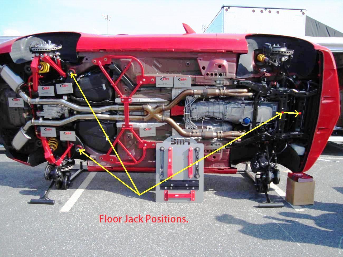

These are the recommended floor-jack points for the SS.
Name:  Jack Points - Floor.jpg
Single jack point directly on the rear differential is not recommended, but I suppose if you could spread the load with a good 2x or 4x block it might be okay.

So that's what it looks like under there...
Actually that's a modified race car chassis in the photo. The recommended read jacking points for a stock chassis are where the rear brace bolts to the frame box channels, just in from of the rear wheel wells.
And the differential case should not be used!
