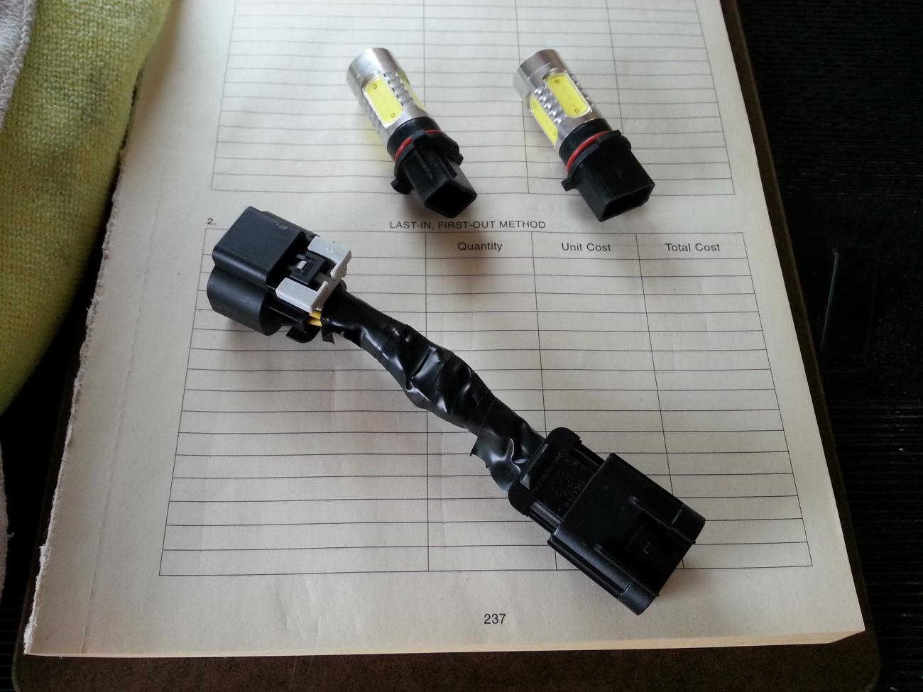

Next were the DRL's. The harness and LED bulbs are from Gen5DIY. I'm sure everyone has seen plenty of threads about these.
The hardest part for me was figuring out how to disconnect the new style connectors. I've not dealt with these before and I was afraid of breaking something. Easy enough after you figure it out.

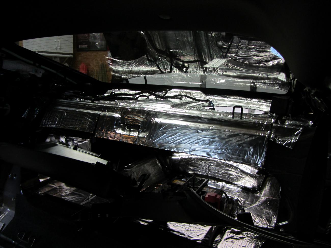

The windows had to be tinted so I took it over to my friend Bill at Route 66 Window Tinting.
As it turns out, he prefers to remove the interior panels to make the installation easier. He suggested this would be a good time to upgrade the stereo system. Which was very tempting, and I have another topic here containing the parts list I had planned to purchase. But it's not in the budget at the moment. And I don't really have any complaints with the stereo. It could use some more bass, but that's typical of most factory audio systems.

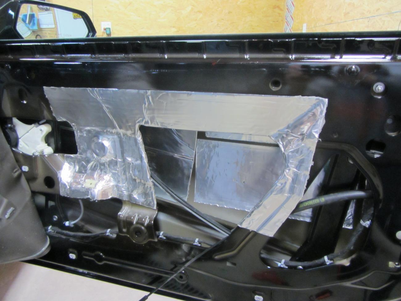

In any case, while the car was apart (which was a great deal of stress for me...it is only a week old after all), we took the time to do a little sound proofing. So in went the RAAMmat:
It covers the battery area, trunk floor, back panel, inside the rear quarters and up over the wheel wells as far as I could reach, the floor under the rear seats, back deck, roof behind the sunroof, and the doors.
It did reduce quite a bit of the road noise I noticed coming from the rear of the car on the highway. Some RAAMmat and Ensolite under the carpeting would have made a huge impact, but I didn't want to go that far.

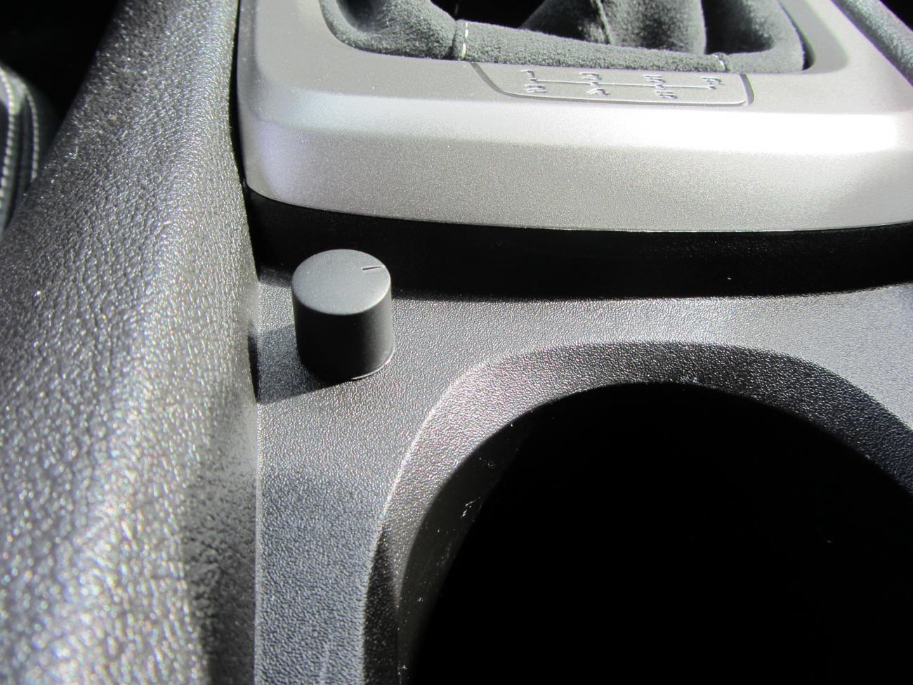

While a complete sound system was out of the budget, I did decide to add a sub to solve the bass "problem".
I went with the large sub kit from ******** (******** 12” sub kit - http://********.com/product_info.php?products_id=449 ). It sounds great. I still have some adjusting to do, but I haven't driven the car much since this was installed.
A few notes on the kit and installation: MOST of the hardware needed for installation is included. I state most as I was under the assumption (yes, we all know what happens when you ass-u-me) everything needed was included. Just a small gripe, but you will need screws to attach the amp to the box, and screws to attach the sub to the box. Being a kit, I would have expected these to be included. Also of note is the wiring kit. While it does include everything needed, the RCA cable is medicore quality at best. The RCA plugs don't fit very tightly. I end up taping them to ensure they don't vibrate off.
Also, per the instructions, you need to slide the front of the box towards the center of the trunk. After several attempts (and breaks to walk away and gather myself), I could not get the rear of the box to slide past the stud (cargo net threaded stud). I finally pushed it straight in as far as it would go, then pushed the front in first...at which point the rear slide right into place. A few love taps with a rubber mallet and installation was complete.

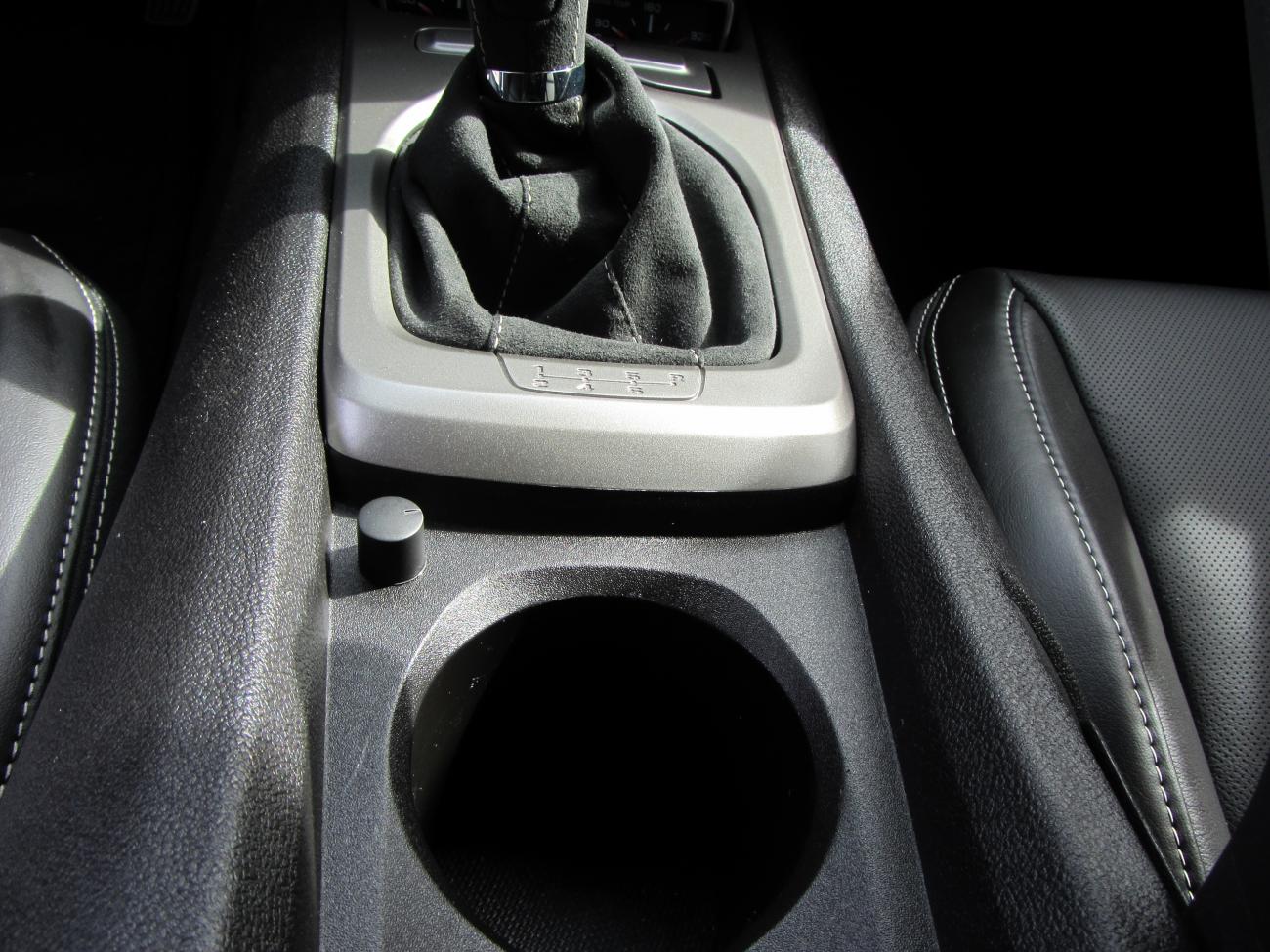

And I forgot to mention that while the interior was apart, we ran the cable for the remote bass knob. It's mounted in the center console by the cup holders (as I've seen in someone elses pictures).
