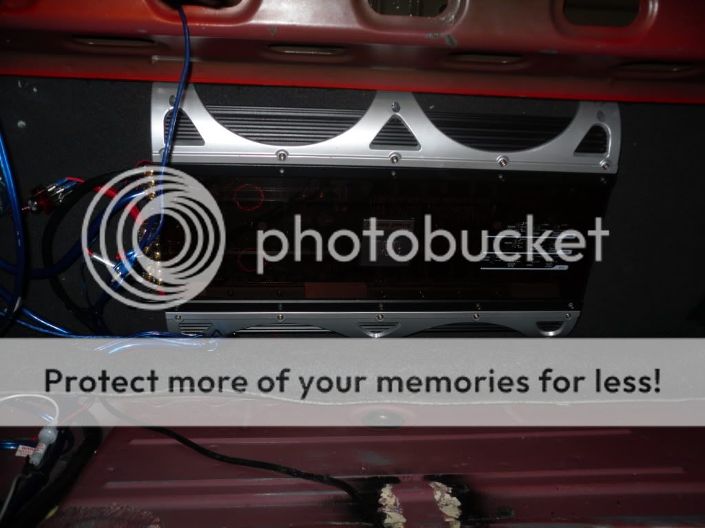

Post will this amp fit on this amp rack?
will this amp fit on this ******** amp rack?
http://********.com/Chevrolet-GMC-Su...ing-Board.html
http://www.crutchfield.com/p_204MGA1...isplay=Bazooka

Looking at the measurements of the amp it's gonna be tight . It will have less than a quarter inch on each side. I didn't pay attention to wiring terminals though

it will fit, but beesting is right, it might be a little tight.
The MGA has an endcap that hides the wiring terminals which are set into the amp a little bit, so wiring shouldnt be an issue if you plan ahead.

It'll be tight for sure ******** is pretty accurate about the mounting surfaces.
You need to plan out the power and ground and speaker wiring ahead of time as suggested as well.

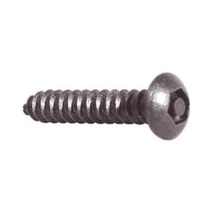

also - dont forget to get security screws to hold your amps down and your subs in - make it hard to steal...
you can get them at any home depot/lowes/hardware store - DONT use drywall screws, it ruins the mounting feet and looks tacky.
security screws - get the button-head style, not the flat head style.
if you really want to do it right, get T-nuts and some button-head security machine screws...

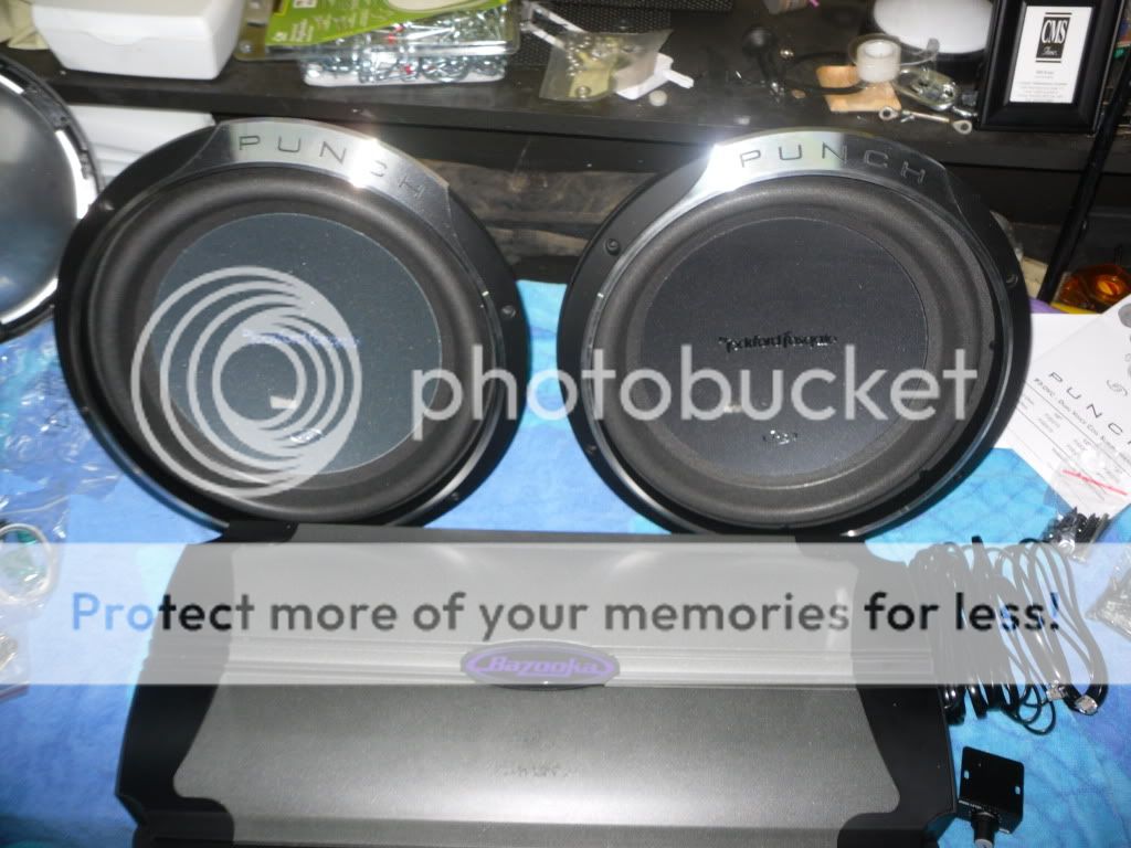

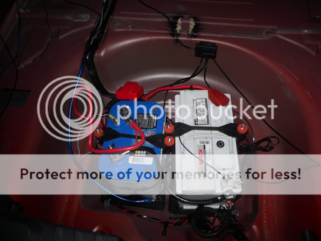

Old 03-16-2011, 08:42 PM   #8
SoTHavok
Drives: 1
Location: 1
Posts: 610
Smile
Extra Blue top Battery Setup nothing hooked up yet
Black box is neons and wires are in process of getting cleaned up so none are squished by ******** box
and it is wired strangely for positive due to the battery power saver strapped on blue top battery
Whats going in : 2xohms P'3s on 1100 watt amp
6chnnl amp already in place ready to be plugged into all after market tweets n mids
SoTHavok is offline   Reply With Quote
