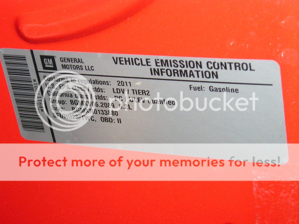

I think you're problem is solved, Whitetiger. My sticker says:
Conforms to regulations: 2011
U.S. EPA class / stds: LDV / TIER2
California class / stds: PC / ULEV qualified
The sticker is located a little bit above the driver's side hood hinge, on the underside of the hood. If you're concerned about the particular car you're looking to buy, have the owner check under his hood and make sure the sticker says that. I guess that's all California needs, I don't really know.
Hope this helps. And yes, I realize that the barcode up there is the last half of my VIN, but I'm not too touchy about who knows my VIN, either.
