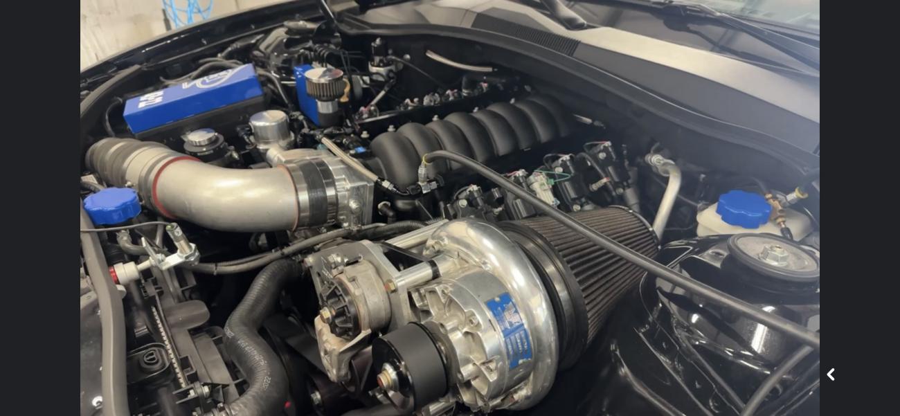

With my Whipple I had the race scoop in the drivers side lower grill that then directed the cold air up behind the headlight and then into the insulated CAI air box. Now that I’m running a Vortech V7 YSI billet supercharger the intake is on the drivers side in front of the master cylinder. Has anyone ever made or saw a custom intake scoop in the factory hood? I was looking at some neat carbon fiber hoods but the boss shot that down as she doesn’t like them.

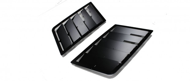

Check out the hood vents from Trackspec. I've got them on my C5 Z06. Good quality items.

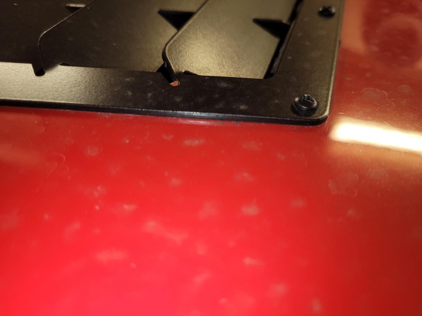

That sort of scoop is better for trying to force air into the intake, but you have to figure out how to seal it up as there is already under hood pressure at speed so it would not likely do much.
The Trackspec pieces are designed to relieve under hood pressure, which still lowers underhood temps because of the increased airflow, but they don't do anything to pressurize the intake charge like a CAI intake (not sure how much that even does with FI).
I run Trackspec vents because they stopped selling the Hexvents right before I needed them. I don't know if Trackspec did not have those vents when i bought mine or I did not see them, but I would have definitely gone with those. I like the vents I have, but they don't mount flush as they are stamped from 1/8 aluminum so they definitely look more like a race car piece than a factory piece.

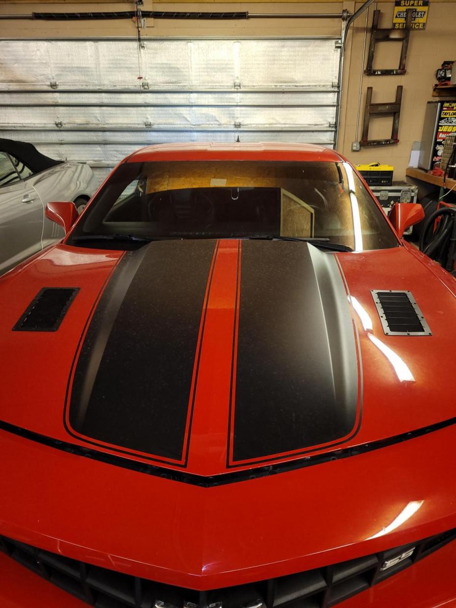

Posts: 3,030
Originally Posted by Blue 13 View Post
Thanks CC. Any pics?
Here you go.

Those hood vents that CamaroCracka posted look really similar to the ZL1 Addons Stage 1 vents.
@CamaroCracka, car is looking great!
