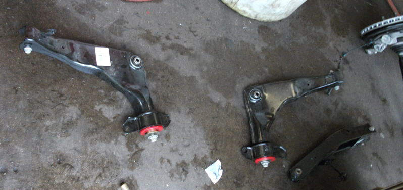

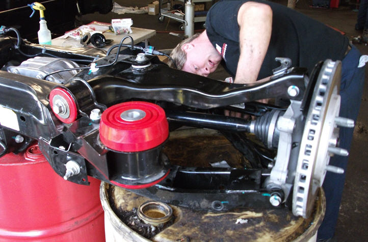

Mike installing bushings.
More Bushings..
and More Bushings. The rear subframe took 6+ hours to upgrade.

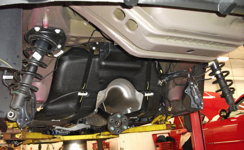

a picture underneath again.. that plastic thing behind the brake caliper is the gas tank.

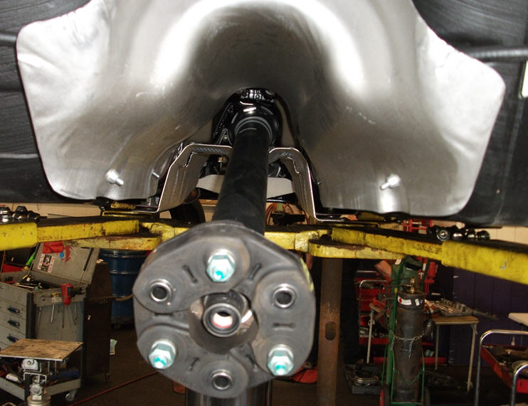

Looking down the driveshaft tunnel..
Where your exhaust goes.

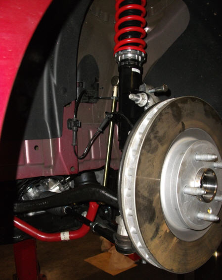

A pic of the front. Motor mount to the right behind steering rack.
Scott installing the front coilover strut
After the swaybar was installed.

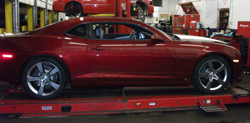

Suspension is finished for now. On the alignment rack to get adjusted.
Completed with Alignment. Car is lowered 1 inch.
rear is slightly lower than the front.
front ride height.
A pic from the rear looking forward when done. Still has stock rear swaybar.
