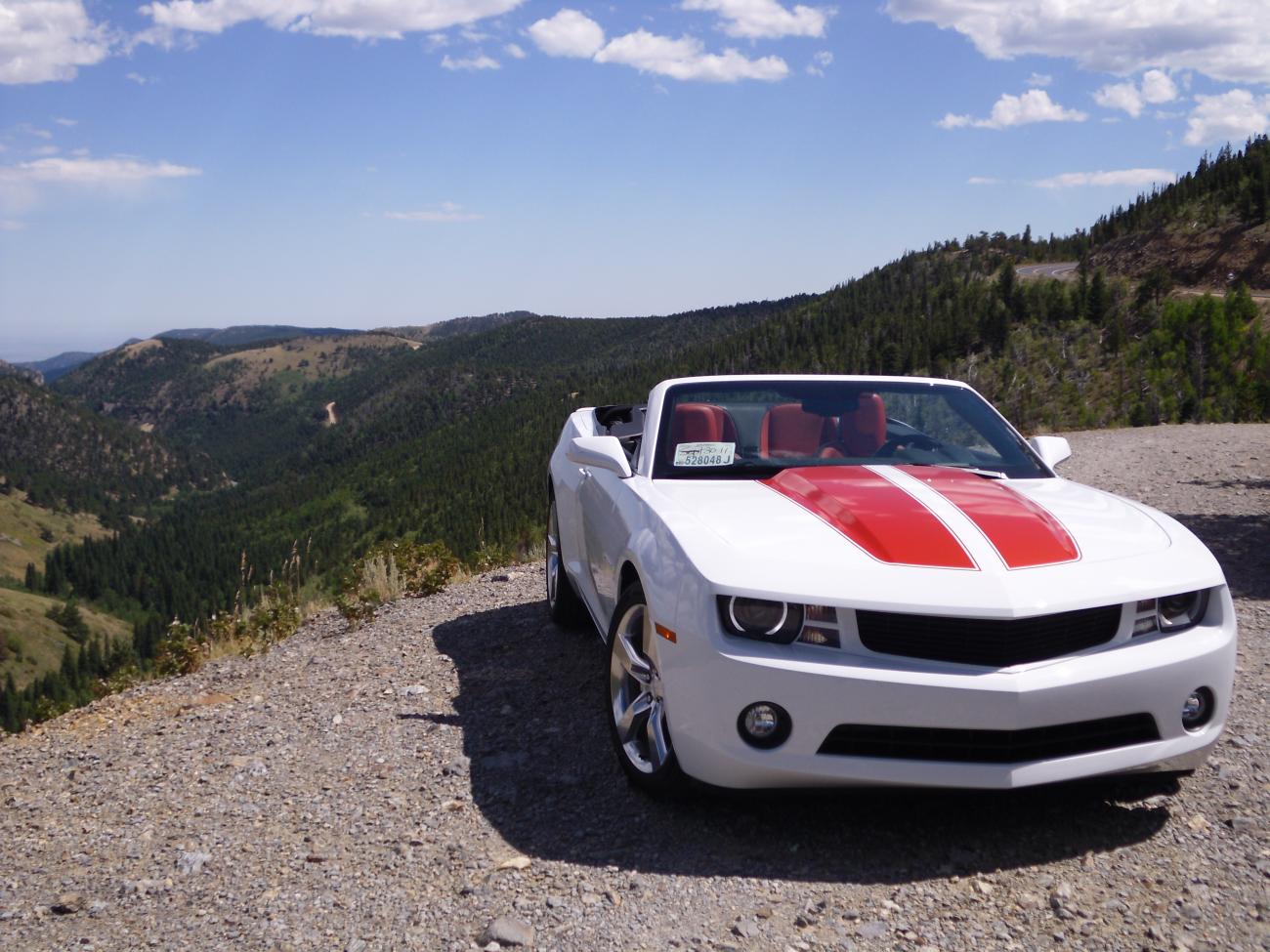

Hello Everyone! I have been a lurker for a long time, and last month decided to take delivery of a 2011 2LT/RS Summit White with Inferno Orange stripes and interior Vert. I absolutely love the car! I took her on a little road trip in the Rocky Mountains over the holiday weekend, and man was I impressed whith how well this car is composed on twisty mountain roads!
However after a month of owning I do have the same issues alot of us are having. This car was built in February, and I do have rub marks on the top. But I also have a few issues idk if I have heard anyone else have, i tried to look for threads but couldn't find any. When the top is down there is a squeak from the left rear when I go over bumps, I think it could just be a hinge in the top?
I do have the A6, and it gets the "rumble strip" feeling around 40mph at low rpm, and it is SW and I do have discoloration on my strut towers.
I also have a clicking noise in the rear windows when they go up or down. I have never tried another vert to see if they all do that, or something is just wrong with mine. It almost sounds like the regulator is coming apart or something?
Any information or help would be great! She goes in for her next service already next week. The car is just too great not to use as a DD

Wow - beautiful ride!!

Congrats on the car, very nice. Welcome to the forum. My car was built in February as well. It is kind of strange that it only got delivered to dealer in July. I think Drago77 was the first to talk about his tower discoloration, don't know what the final outcome was, you could pm him. Mines red, I dont have the problem. Dont have the squeaking either but my rear passenger window regulator had to be replaced, it was making a grinding sound when going up and down. I think I read here that at least one other owner had that sme problem. And don't forget about the A/C recall, call your dealer to see if it has been done. Good Luck!

Your car is beautiful! My car was also built in Feb and I received it in March. I too had an issue with a rattle/rumble sound in the rear and I found a TSB about it online. I posted info about it so that might be what you remember reading about it. Below is the info on it.

I love that color combination, (I have one just like it.) The weird feel you get aroud 40 is probably from lugging the engine. Check your tach and see if it is'nt running around 1000 rpm's. Mine does it, but if you give it a little gas it will downshift and feel smooth agian. I think at this point, I would try to get the dealer to do the service bulletin on the top and try to avoid hurtining it to the point of replacement, (so far nothing but horror stories on top replacements).It sure is a pretty car.Enjoy it.
