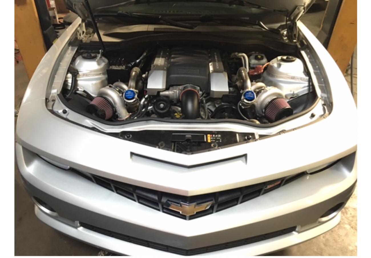

Old 01-05-2016, 02:15 AM   #13
Mcnairbear
Mcnairbear's Avatar
Drives: 2012 Camaro 1SS, twin turbo
Join Date: May 2015
Location: Inland empire
Posts: 48
I sent out an email. I hoping i get back some good news. Dont know if there is a setup that works with my hellion top mount tt. Looks like it only works on superchargers
Havent got it back from the shop yet but it looks like its doable

Posts: 48
Here is the top mount hellion tt
