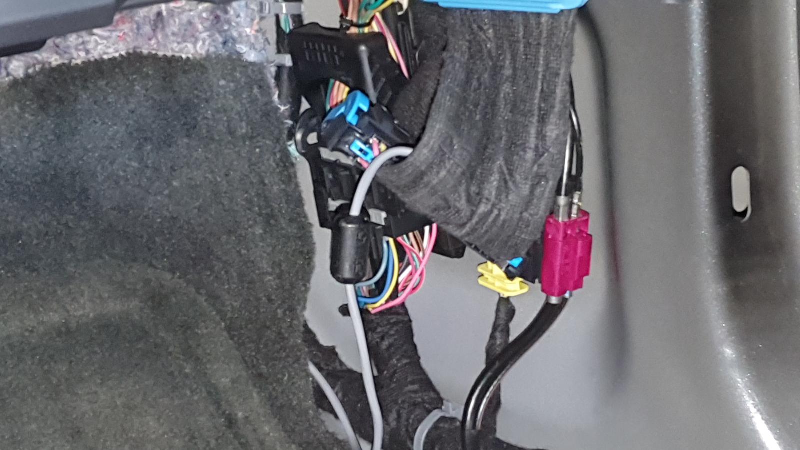

Hi Just want to let you guys know.
You may get the Tyre pressure warning notice when installing the 4pack cluster display. I did. First i belived it to be the wheel sensors had died, and replaced them. No good, could not even get the relearning tool EL-50448 to communicate with the car. After some thinking i found out that when i pulled the cable for the 4 pack cluster all was good. So i tried with ferrite noise suppressor ring on both ends on the cluster Cable. All working good for now.
Also on the blower motor just in case,as they came in packet with 25 pieces in different sizes.
