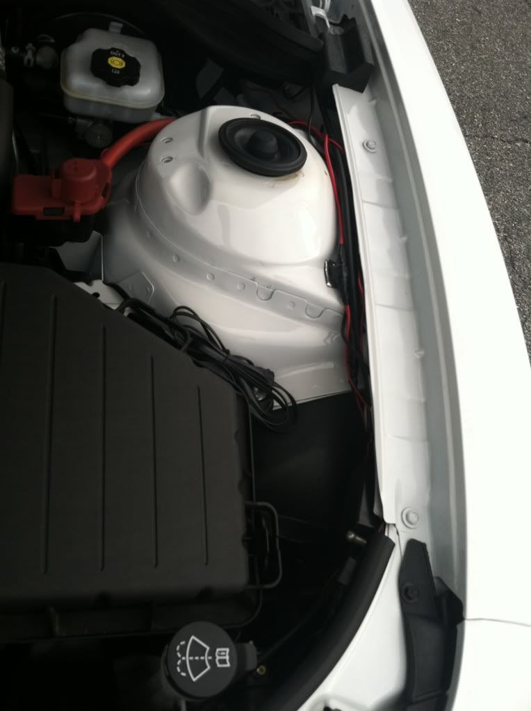

Eagle eye halos and projectors installed
Eagle eye halo projector set
turned out good, only had myself to help install them but still wasnt that hard just took a little extra time
I ended up wiring the halo to the fuse panel then to a switch.
Hardest part was holding the bumper up while re installing it with one person
the headlights were just plug and play
they give instructions to wire the halos to the parking lights, but i wasnt taking that chance!
tell me what you guys think?
removed the bumper, only had myself so it was a pain

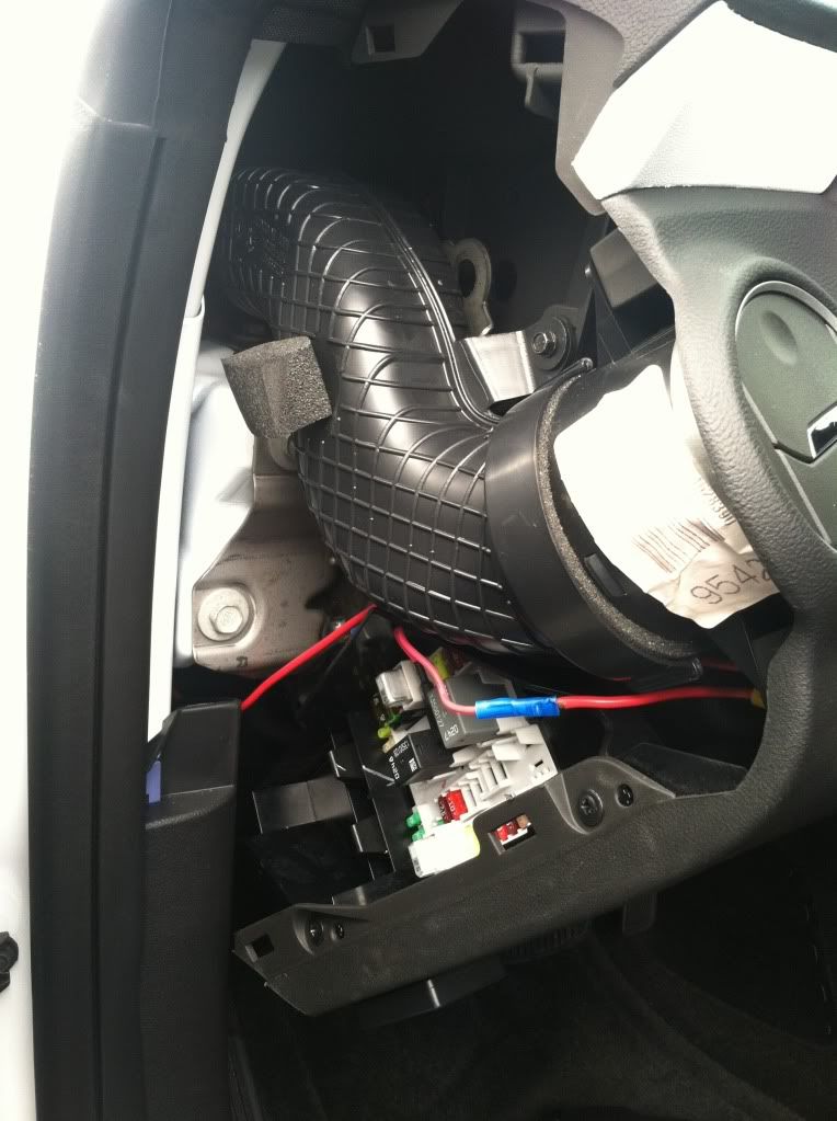

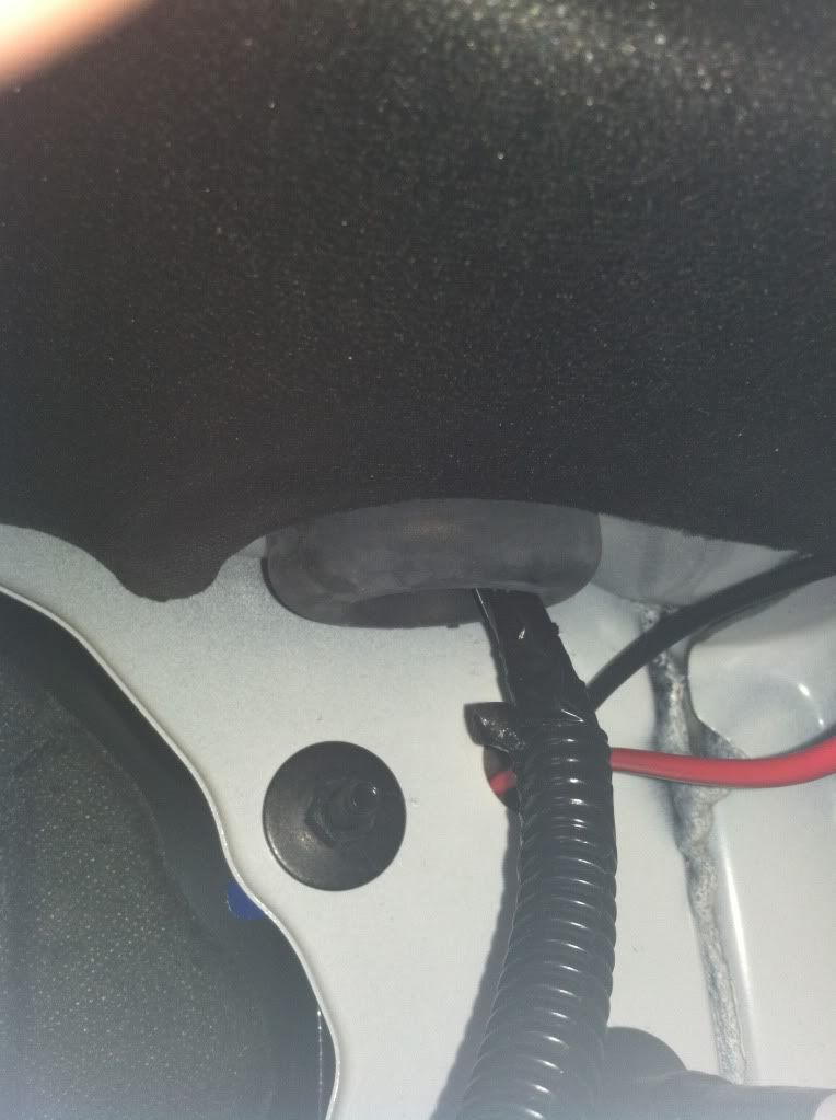

once the lights was installed I ran the wires along the driver side and through a pre cut hole into the cabin
driver side pre cut hole located just above the thick orange power cord

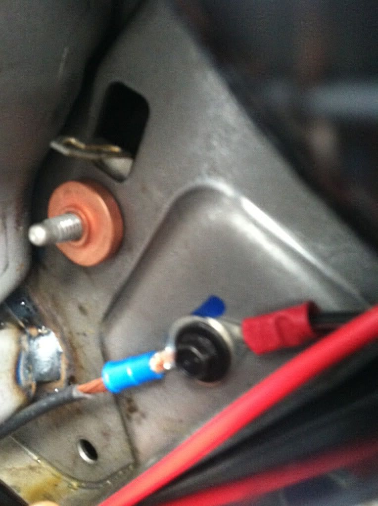

bolted the negative from the halo and the switch just above the fuse box

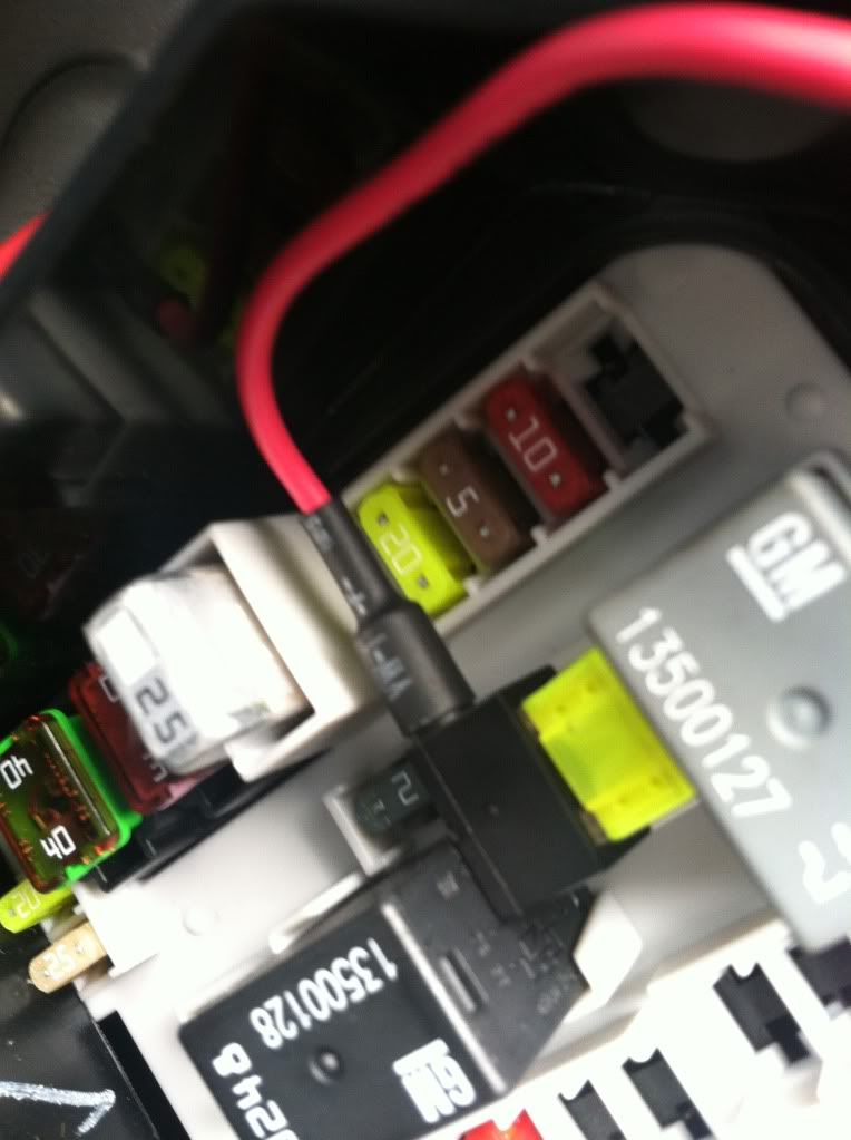

used a fuse tap to tap into the 12v cig lighter for power (i never use the one thats in front of the gear shift so that why I tapped that one) plus i didnt want constant power to the halo. only when the key was inside

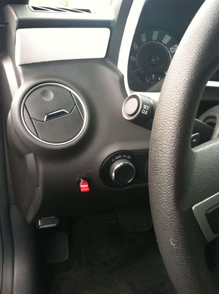

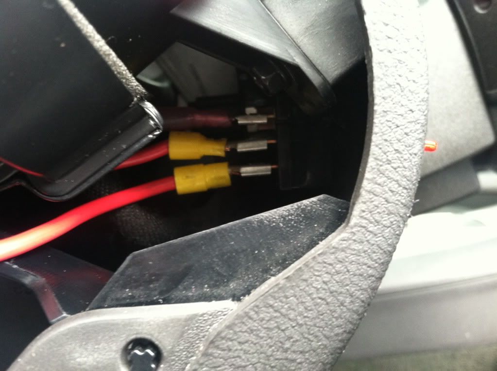

drilled a hole and placed the switch next to the light controls inside the car
(had to remove the driver side vent to fit my hands inside)
turned out with a good look, the switch lights up when the halos are on
(the black and white box below is for my footwell lighting fyi)
