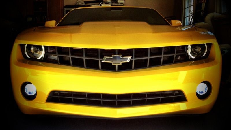

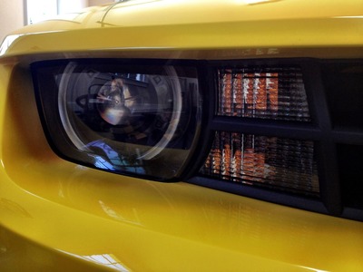

Picked up some surprisingly decent quality of tint from Autozone and made templates of the turn signal lenses. Cut out the pieces and put them on. Very pleased with the outcome. I know some companies offer these pre cut, but after shipping it was pushing 29 bucks. DIY always feel rewarding!

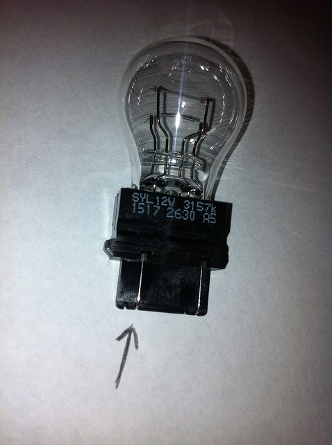

I had LED switchbacks, but once I put in RS lights, when the white LED's were lit it was to much going on with halos and fogs. I put the amber bulbs back in, and clipped the pin so the DRL portion would not come on.
which pins are those?

Gila - Peel & Cling" Limo Black 20%
This tint had more of a rubber texture to it, and went on very easy. I misted some water on it, and squeegeed it out.
The left pin you see the arrow pointing to. I just kinda pried it out from the back and snipped it off so there is no connection.
