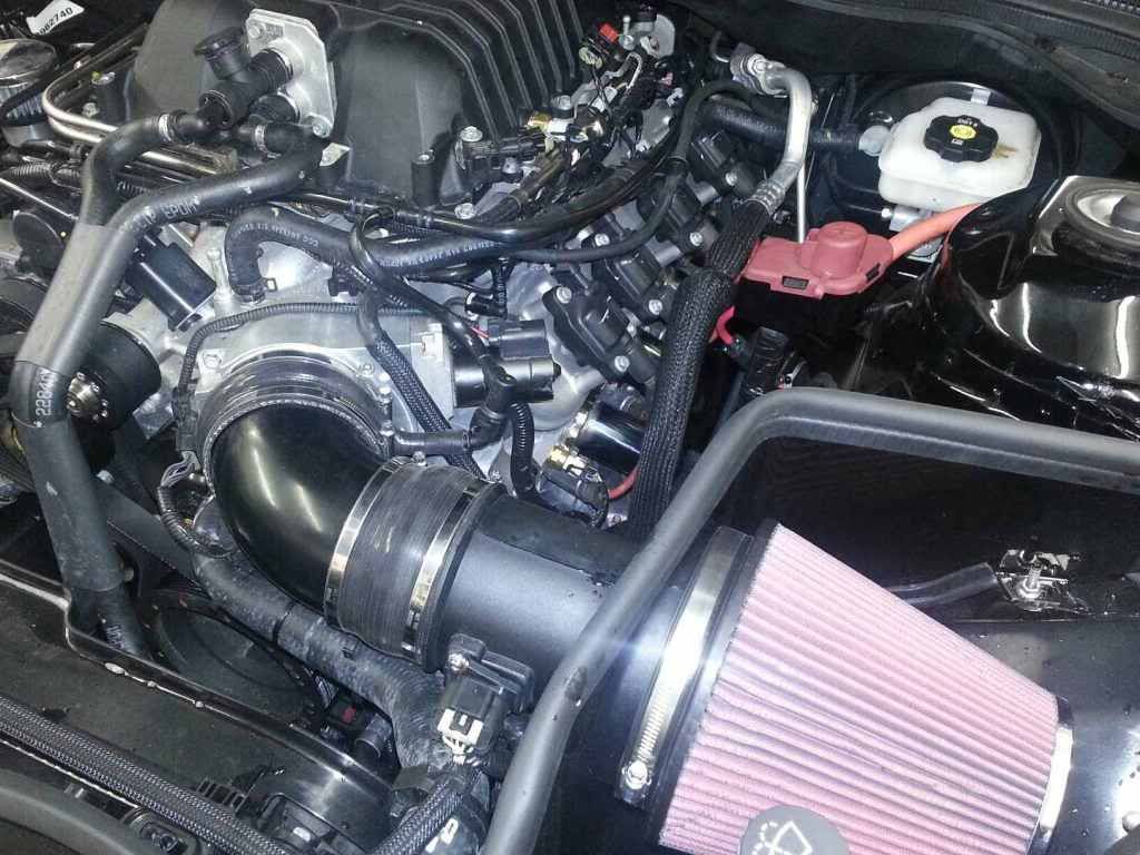

a few of you have been following my posts..
first the blower was ported.. I went the extra mile on it and really opened it up.. then i ported the snout to accept the nick williams 102. Brent from LPE sent me a fantastic cold air, my fav pulley the 2.38 and the CBI here in St louis hooked me up with a set of TEXAS SPEEDS new 2" primary headers and cat delete..
We tuned the car tonight and it is fantastic.. This is the second car i have done with the 2.38 pulley and man I am glad i went with it again..
Everybody told me that porting the blower and the 102 would help with boost, but the headers would cause a two pound drop in boost.. well i drove and watched him loggin as we tuned. This car makes 15.2 pounds of boost according to the factory sensor at 5600 rpm and carries it all the way till a raised 6400 limiter.. I would say my porting worked..
the car sounds CRAZY.. it is 100% drivable.. want to know what the car with headers and stock exhaust sounds like? unplug your flaps in the mufflers and drive it around. I plugged mine back in and setup like that it is actually QUIETER driving around at highway speeds and in traffic than with factory stuff and the flaps open all the time.. I was AMAZED! you open the throttle and when the flaps open it just rips..
My guy at CBI has installed several sets of the 1 7/8s headers on ss and told me they were just as good of a fit and finish as the more expensive headers out there and I showed up just as he was putting them on.. they fit the car great, they look SUPER NICE, what little you can actually see of them from up top, and fit the stokc catback right out of the box with the supplied cat replacement sections, which by the way look just like cats, so the car would 100% for sure pass a visual inspection by any random nosy ass trooper..they look just like cats.. they are just hollow..
I also added ID 850s and right now, with no cam the car is happy set between 11.4-11.8 commanded afr and the injectors are at about 75%... the car is making power.. I will be putting it on the dyno soon.

oh...don't you hate how just about every CAI including mine rests directly on the upper radiator hose?

It is odd that the MAS is on the front of the tube?

I could turn the tubevaround.. it does not matter.

Is that a stock lower balancer in the picture?

Yes.. you do not need to spend a grand to make 14-15 pounds if boost.. iv said it before and ill say it again, only places trying to milk you for money try and say otherwise..
This is my SECOND car with this pulley setup.. other is my wifes 43, 000 mile daily driven 2011 ctsv coupe..lowers are fine if thats ALL YOUR wanting but I dont get the two pulley crowd unless you just like spending money.
