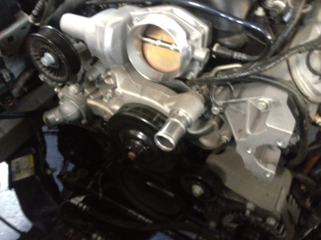

Matt, are they using stock headers?

Looks like yes you can see the stock manifolds in one of the pics

Thanks, was on my phone with cracked screen so couldn't tell
Yessir... We'll see what happens, the client is planning on doing headers down the line. I'm quite interested to see the numbers, I think we'll be considerably low in comparison with headers and probably pick up 40+ rwhp out of just headers, but let's test the ls3 manifolds!
