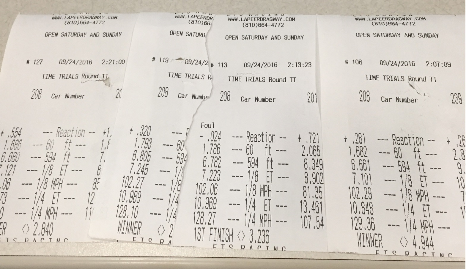

I did about 20 runs in a few hours. Once when there was no wait at all I did them about 6 minutes apart. You could argue that I lost a tenth but look at the 60 and you can see I lost the tenth there. The cut off one is a 10.873 with a 60 back to what it was on the 10.84 run.
There are only two arguments for the HE based on these results. Either I was already hot all the time and therefore don't lose power because power is already down or I was able to cool off enough on the return road cruise for 6 minutes. That time for a convertible is pretty good for 28% overdrive so I think I am making decent power and if 6 minutes on the return road cools it off enough then I wouldn't call it heat soak.
Just my own experience.
I will say if I had regular tires or the stock tires that would have been one shit day spinning down the track. I was on 305/45/18 MT Street R and still could spin them.
