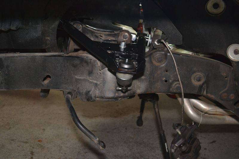

Here are pictures from the install.

BTW: the only tweaking was for the QA1 shocks. They use a larger bolt that stock and the A-arms are designed to bolt up to stock. So, you either use the smaller stock bolts or drill out he wholes a little and use the bigger bolts that are supplied. You would probably have to do this with some of the high end arms as well and I don't fault the A-arms for this.

Only thing I see is the welds don't look very consistent. But if you're not racing or putting a ton of miles on I doubt you'd have an issue. But considering my welds look like they were done by Ray Charles during withdrawal I can't hold it against anyone.

I mean my own personal welding skills. I do exhaust brackets for bikes, headlight mounts, repairs and crap like that. Its a little Hobart 140 but works on 120V wherever I move to with no need to put in a 220 line. I really want to get a tank and start doing stainless but I move too much and the movers won't touch the tanks. Plus I need to improve my skills before wasting expensive metal but I work too much.
You could always strip them, touch up the welds, and recoat them if the scratches bother you at some point. You'd still be under half price of most. I had a 77 Z28 I restored but had to sell to pay the bills. As soon as I get out of the military I'll be finding something 1st/2nd gen to restore again.
