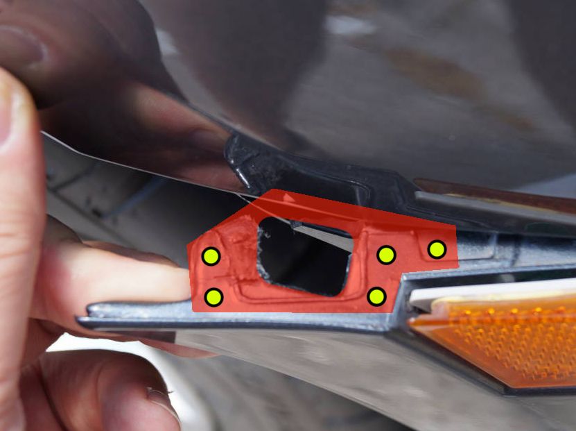

today as i was coming home i went to pull off the road and my right front clipped the road and pulled the right side of my bumper loose right above my side marker i pulled the wheel well cover back and saw what had happened was the spot where the bumper goes in and a black bolt holds it tight the bumper ripped out i stell have the screw and bolt and i can push the bumper back in but i can also pull it out and idk if it will hold itself in all the time would putting the bumper back in and just tighting the bolt hold it cuz i cant afford a brand new bumper any help would be great
So the area of the fascia where the bolt holds it on has ripped away?
This has come up before and I provided an idea for repair to a C5 member. It should work. You may consider trying this. It was specific for a bolt that tore out of the fascia:
The red piece shown is aluminum plate. Pretty thin, maybe 0.075" thick. You want two of them, shaped identically. The shape shown re-creates the damaged portion of the fascia. The yellow dots are holes. These holes get drilled into the 'flange' on the fascia, too. One plate goes on top of the damaged area, one on the bottom. Spread some epoxy on the 'flange' so that it will end up in the middle of the aluminum plate 'sandwich' before you apply the 'plates'. It would be a good idea to mask the outide of the fascia with painter's tape before applying the epoxy
Zip ties would be used to secure the 'plates' together, through the 'flange' of the fascia. The blue lines represent those zip ties. Between the plates, the zip ties, and the epoxy securing it all together, it should make an effective repair. The 'buckles' of the zip ties would all be underneath.
The gap between fender and fascia may be greater than you'd like, so play around with the thicknesses of aluminum that will work before you start drilling and using epoxy.

Old 07-20-2013, 09:26 PM   #7
RJT Impala
Stovebolt BluFlame 6
RJT Impala's Avatar
Drives: '12 2LT/RS, IBM; '20 Traverse Prem
Location: Wherever!
Posts: 893
Excellent suggestion for an effective remedy!
