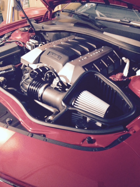

Pretty much sound advice here. I ran (and still do) the Z/28 CAI for a couple of years untuned with ZERO issues. The sound alone is worth the price. Practically sounds like an aggressive exhaust it's so loud. I'm tuned now still with no issues. It comes with a strong MAF.
The fit is just plain, 'factory.'

Great pic! Thanks Moto-Mojo.
